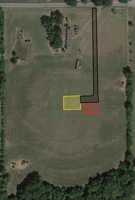

It's looking like we may be able to break ground in the next couple of months. Prices are high - high, but Mrs. LBBJ is DONE with living in the temporary mobile home. I don't think waiting in the short term is going to benefit us. The house went up $100,000 since we had it quoted in December 2020. I don't see it going down appreciably in the next couple years. I'm being told wood is at the new normal. The only things I see that have potential to go down enough to matter would be wire and pipe. I think anything else especially, non commodity items, are probably as good as they are going to get unless something bad happens.
So anyway, I've talked to the bank. I've talked to a mentor/ friend that is in finance about our personal finances. We are getting a 2nd round of quotes. Then we should be off to the races. I may do kind of a build thread here. I'm going to be doing a lot of the dirt and driveway work myself so there should be opportunity for excavation equipment pictures.
The red square is supposed to be the shop. But with prices being what they are it is going to have to wait.

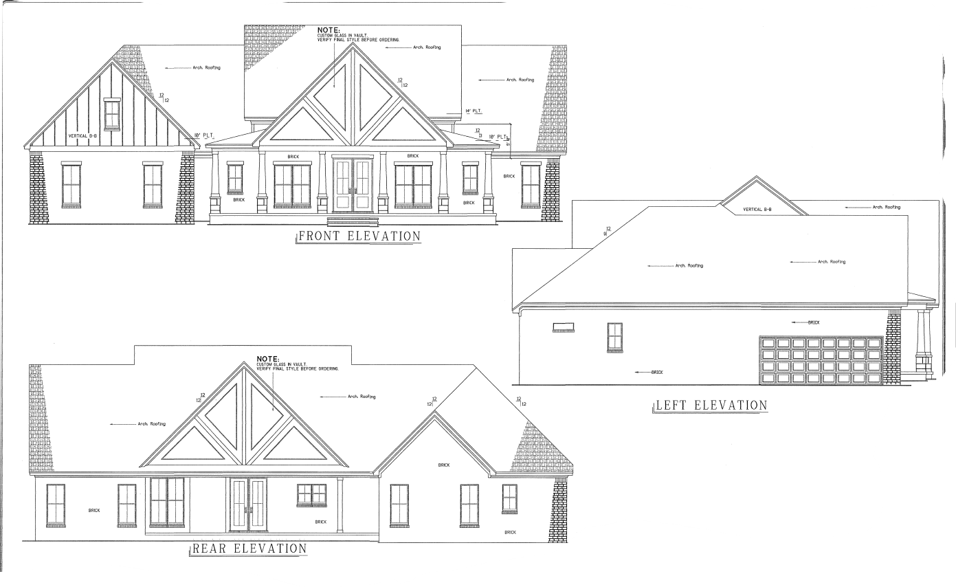

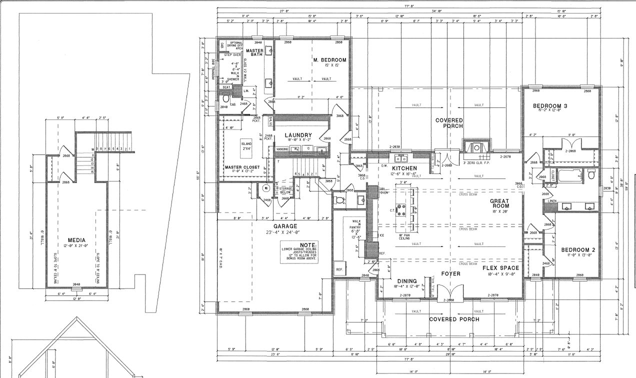

I really like your floorplan a lot. Very well thought out with plenty of storage. Putting the laundry right next to the Master Closet makes a lot of sense. My laundry is inside my Closet. We just pull it out of the dryer and hang it up!!!
The only thing that jumps out at me is those French Doors. Have you ever dealt with them before? I personally hate them because of all the issues with air leakage after they break in and the seals wear out. I've installed them for elderly people that later on asked me to remove some of the seals so they could open and close them easier.
When I redo my front door, I'm putting in a 42 inch door. 36 inch front doors always seem to be borderline too small to get stuff in and out of the house. I've been in one house with a 42 inch door and it was so much nicer to just walk through while carrying stuff.
And just my personal taste, but I think that massive gable over the front door is way too big.

I'll agree with double opening doors. I've never seen them work as advertised over time. I'd be happier with a wider main door and a floor to ceiling window panel next to it. However, to each their own. ;)
/ House Build 2023 #4
We hav a set of Anderson series 400 double doors for the entrance to the basement and another one for the main floor entrance. We like the locking mechanisms for those doors. Not your typical thumb latches top and bottom. Similar but controlled via a lever like the main half. Yes we did use a 42" door for the stairs to the basement steps which are 48" wide. Possible stair chair in future? But I hear personal elevators are becoming available. Jon

Can't tell which direction is north in your plans, but one suggestion on the floor plan - it might be nice to have windows on two walls in the bedrooms vs just one if you like natural light.

I think we have decided to go to a single door in the back. I'll look into a larger single front door, I don't really care either way. Not really sure if my wife does or not. They are going to be fiberglass not wood so that will help either way.
Front door faces north. I'll check on a window on the west side of the master. That also doesn't really bother me either way.
We combined a couple different plans we found and added in our own taste. Originally the front center gable was just a few feet wide. We like the look of the larger one. But the main reason for it to follow, or guide, the vault in the great room. It's also going to be mostly windows. We were advised to make the pitch shallower though and we will probably do that, so it will shrink some.

Yes, laundry room near master bedroom is smart. Be sure to build it large enough for tv, small refrigerator, ironing board, folding table, recliner so you are able to "work" in there when you need peace and quite. We made some mistakes in our laundry room, smaller than wish it was plenty large for washer dryer (full size) laundry sink, reasonable cabinet and shelf room, but wish it was at least 50% bigger for the ironing and folding. Also, be sure to have the shortest duct run. We should had our appliances on the opposite wall. Bath room near laundry room is great.

Agree with all those who suggest going to single door on the north wall, vs the double doors. They look nice from the street, but waste a ton of energy and space inside.
Only other thing that stood out to me was your water heater closet. Go with an outdoor tankless mounted near the laundry room and master bath. You'll never run out of hot water, and you'll get it fast. My gas bill in the summer (running tankless only and a dryer) is <$20/month. Delete the water heater closet in the garage.
And if you have a pick-up (or ever will have one) make your garage depth at least 25' inside. Neighbor bought a new F150 and it was 6" longer than his old one, and wouldn't fit in his garage on his $500k house. Bummer.

Thanks for all your input so far. Implemented a lot of it. we are staying with double front doors though. A single looks a little puney, I know it's splitting hairs... We are at least going with fiberglass instead of wood. I have new plans that I will share as soon as I get them in digital form. Not big changes but enough that it required an update.

Here were the 3 options on front doors. the windows above are open to the vault in the great room and the sills and top caps will blend in as much as possible they won't be so garish.
Single 42" wide, single with side lights, 2x36 wide all 8' tall.
