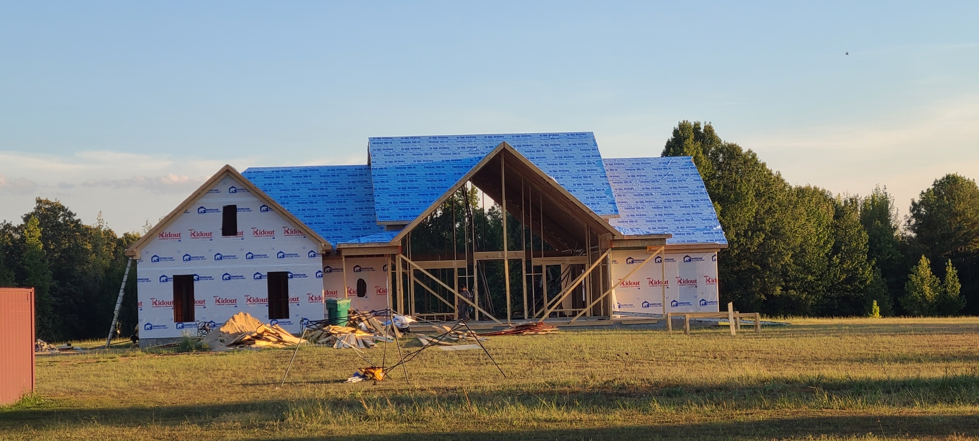

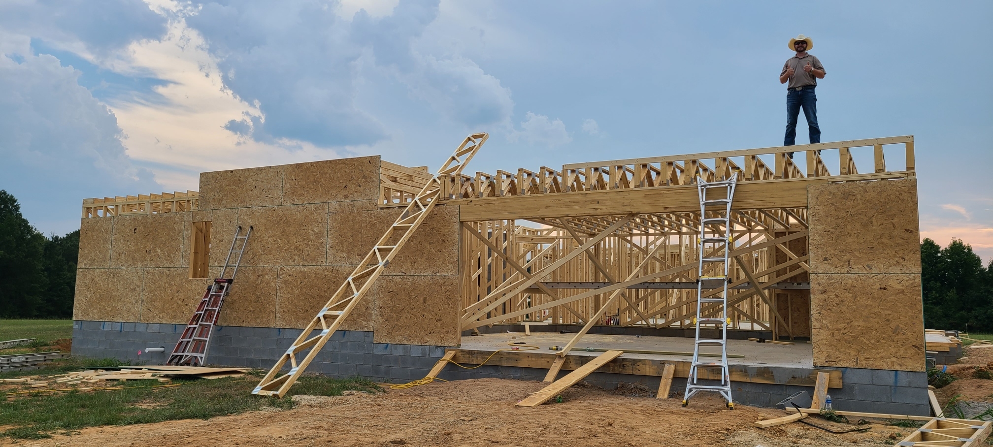

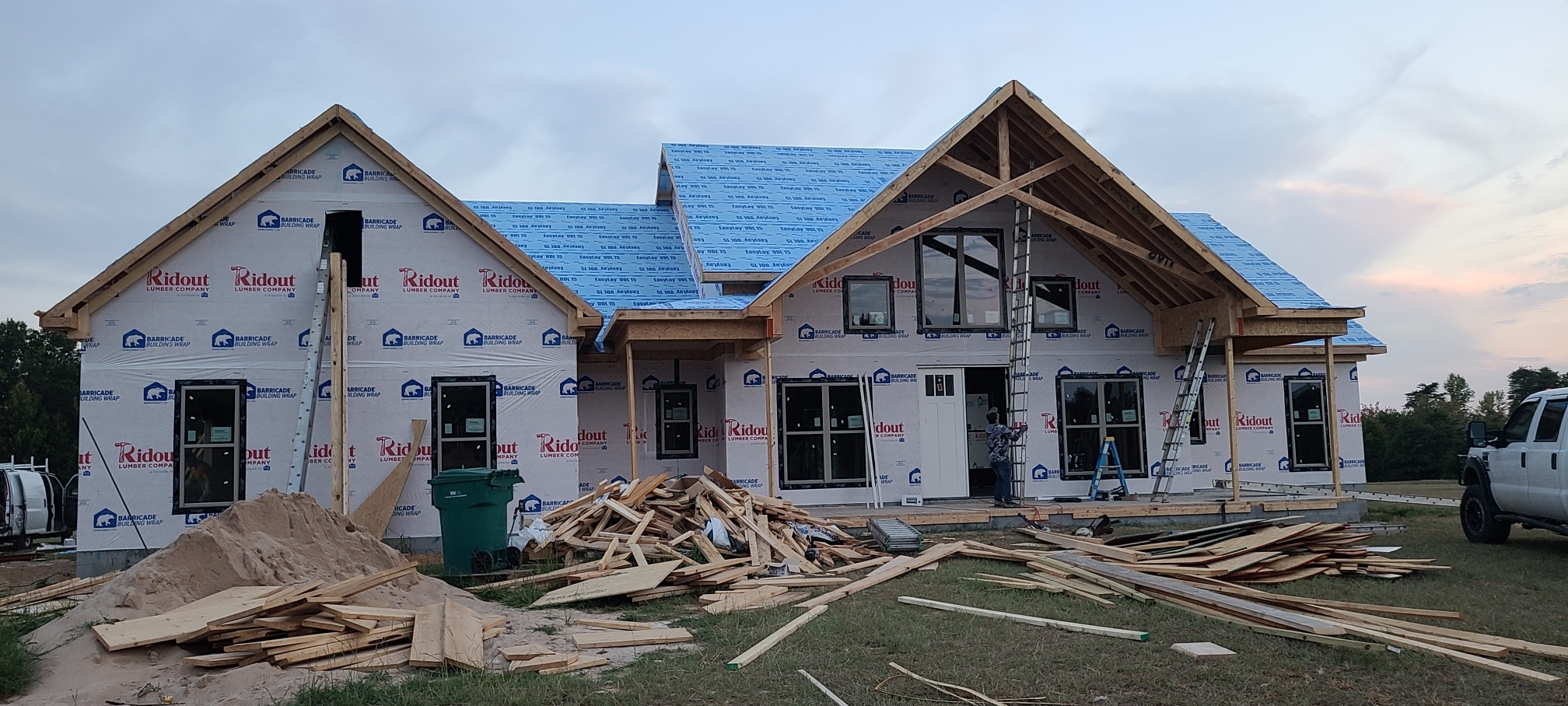

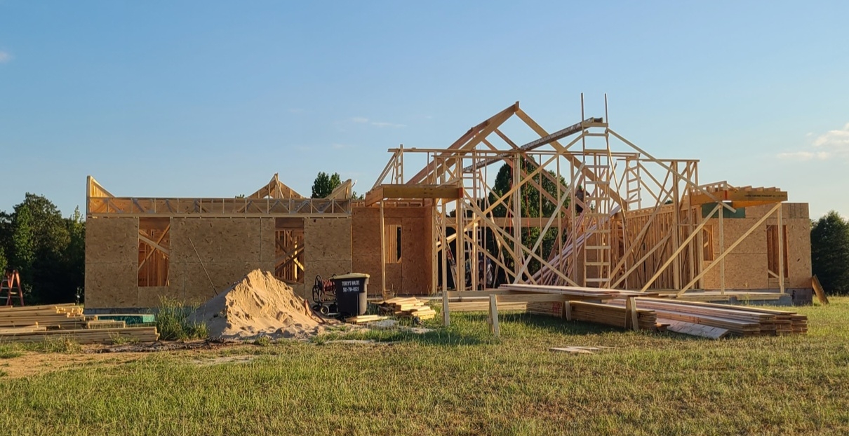

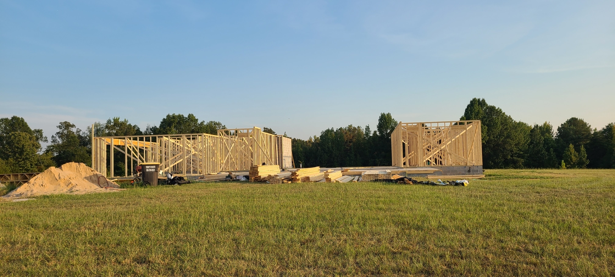

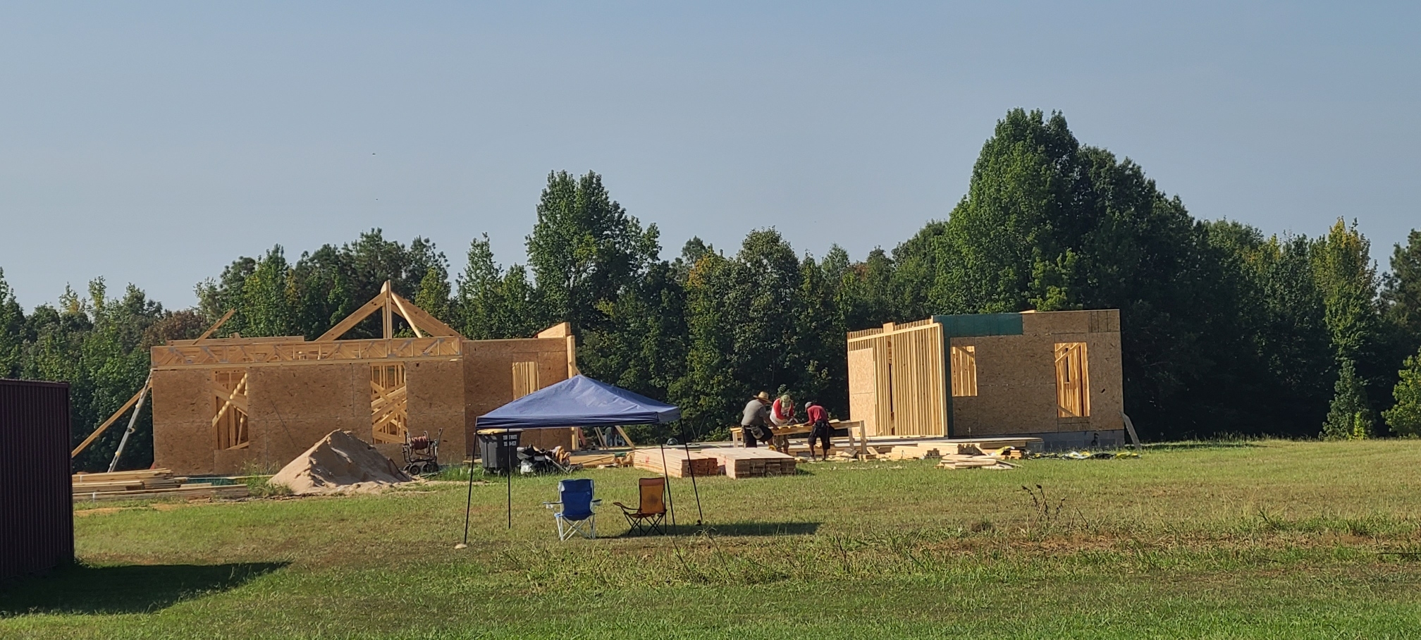

More framing. This part goes fast! I know I promised Zip panels but i was talked out of them in favor of Tyvec. Residental and commercial builders, that I know well and trust, both said in this climate Zip is a waste of money, and the upgrade is pretty pricy.

No basement? Also, is that blocked in room a storm room?
/ House Build 2023
#123
No basement. They are not really a thing around here very very rare. I think that's because the water table is so high around here.
Yes blocked in room is storm shelter. Lots of 'naders in my area. In fact the reason this lot had no dwelling is because a tornado took out the place that was on it a decade or so ago.

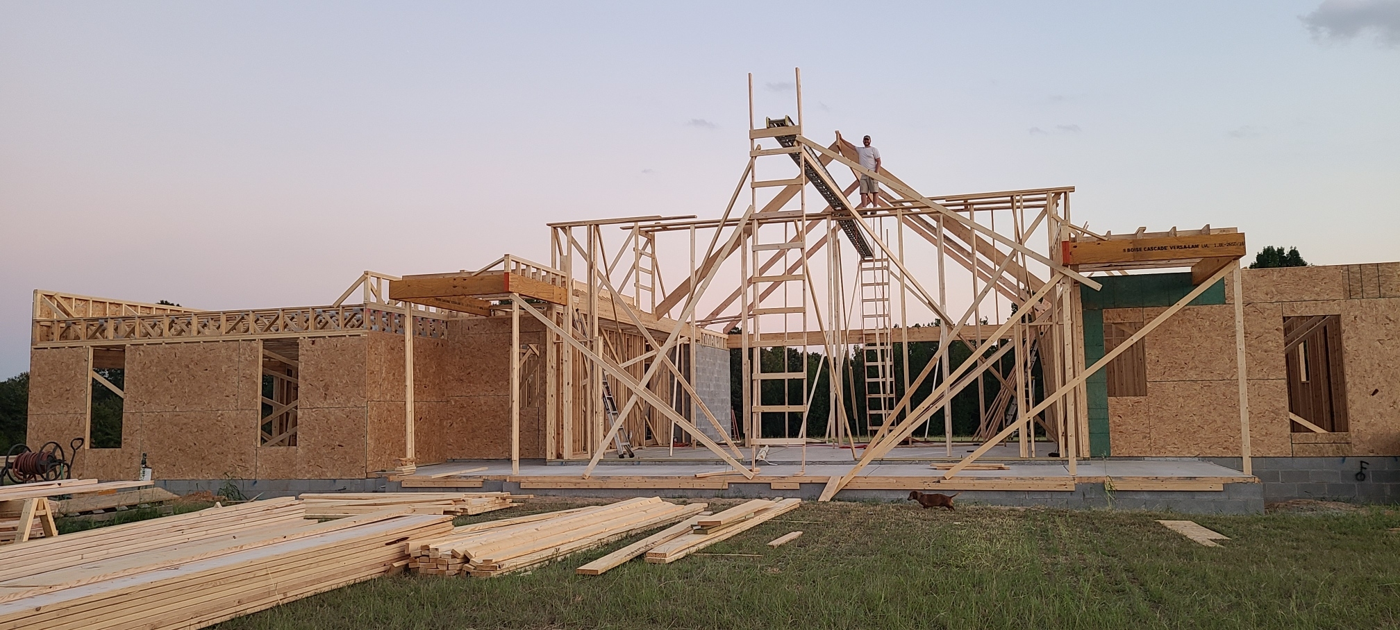

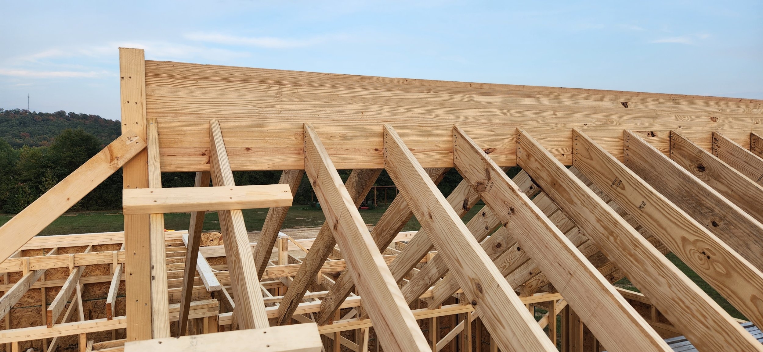

We had the dog trot house look for quite a while. They worked on both ends until they were basically complete and ready for rafters before they started on the great room section. Here is a little more close up. The beam seems a bit large for such a small vault... although later the roof is supported by it also.

You have to air seal somehow, to say zip is a waste of money is a red flag to me. The more I see about zip, the more I like it. Make sure they tape the tyvek properly, including along the foundation, at the top, and at the openings and all seams. Sounds like a builder that just want's to keep it the way he's always done it.

Waste of money might have been my words. They might have said unnecessary. Builder would have used zip if I asked him to, no problem. It was a pretty hefty expense for the upgrade and i did quite a bit of research. Between the research I did that didn't show a great deal of improvement if both are installed correctly, the personal experience of the high end builders i talked to, the expense, and the necessity to tape every hole and imperfection, I decided to save that money.

Looks like you got a really good framing crew. I disagreed with the comments about Zip System, but, but with really good framing, you should be fine with what was used. Zip System is better, but I don't know if it's worth the extra cost in your situation or not.
For me, the first things I look for are properly sized headers and beams. If they cut corners there, then it's time to start looking closer at everything else. An Inspector told me once that when he goes to a job and he sees a mess everywhere, he's gonna look a lot closer to every detail. When he sees a clean, organized job, he just checks the basics because he's pretty sure they know what they are doing and it's going to be done right.
The last thing I wanted to see is how they sealed the windows. From what I can see in the pictures, they look like they used good tape. You'd be surprised how many builders don't seal their windows at all!!!!

A big huge beam just to hide it inside the roof assembly!?!? That is killing me, lol.
That is a crazy expensive attic, haha.
