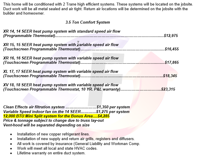

Hopefully I can get a few opinions here.
2 questions:
Shingles:
Going to go with GAF Timberline HDZ in either Charcoal or Pewter Gray. They are both very dark, the Pewter Grey has a bit of a silverish grit. Is there any real difference in cooling costs with both being pretty dark? Everyone says the lighter has to be better, but no one I've talked to really has any hard data. Wife much prefers the charcoal. Attic insulation should be R38, but there is a small-medium sized area in the great room vault that is kind of captured with little to no airflow. 2X12 rafters in those areas with roof on one side and ceiling on the other.
HVAC:
More important in my mind. I have 2 quotes from top tier installers. Both come in at almost exactly the same price, both have 2 Heat pumps and a mini split. Just under $22k Main floor is around 2,600 sqft with 21' vault in the 30X30+ great room, and about a 15' vault in the master. Lots of volume to cool.
1) Goodman, total of 5.5 tons 14.2 SEER plus 12k BTU 17 SEER Daikin mini split - can upgrade to 15.2 SEER for about $2k
2) Trane, Total of 4 tons 14 SEER plus 12k BTU mini split - can upgrade to 15 SEER for $7K
I'm leaning toward the Goodman since it's a lot more cooling tonnage for the same price. Is that a bad call or would you make the same one?
I need to make these decisions as soon as possible. Plumbing top out is tomorrow so basically both trades are waiting on me. I love spending money...

I think you are on the right track with the Goodman 5.5 tons.
I heat and cool 2600 sq ft two story with a 4 ton Trane, it was professionally installed 30 years ago and never a problem with the volume I have here.
With the high ceilings you are going to have I don't think the 4 Ton trane would keep up with the demand with higher outside temps.
Edit: The R value in our attic is R44.
Shingle? Just reroofed my house at the end of June. Went with a shade lighter shingle and it did not make any difference in our energy consumption during the hot weather. Used the shingles in the link below.
The charcoal vs the pewter gray is about the same difference as we went with on our new roof.
Nice looking shingles you are going to use.

HVAC:
I haven't read the whole thread, but if these are two "top tier installers", the first question I would have is why two contractors are 1.5 tons size wise apart on a new construction home when a load should have been done in the first place?
For the quote, are we talking about two split ducted heat pumps with a ductless mini split (total of 3 systems) or one split ducted system with ductless mini split (total of 2 systems)?
If you're at 4.5 ton on the Goodman, its impossible, they only make a 4 or 5 ton system (you state 5.5 tons with a 12K Daikin mini split).
Not certain how cold it can get in your neck of the woods, but I will tell you a 17 SEER Daikin (cheapest model they make) will only get you about 8,241 BTUh max heat at 23F outside air temp.
Daikin and Goodman are the same company.
If the Trane guy is offering a Trane mini split, it's made by Mitsubishi and is a mitsubishi unit. Comparing apples to apples, would be a NTX*EL system.
My home was built in 1988, we bought it second hand in 2005, and it's over 3k square feet that takes 7.5 tons and it was done right the first time as I knew the HVAC guy who did it. A new home built today, same size, I've seen as small at 2 ton do the whole home. This is why doing a ACCURATE load is very important IMO.
Also a little confused because looking at where you live, it's considered the south east. Per minimum standards, the basic requirement for heat pump on any tonnage is 14.3 SEER2, but you mention 14.2 SEER on Goodman an 14 SEER on the Trane.
End of the day, from my perspective, brand doesn't make a huge difference, it's the people putting it in for you. Because the loads are 1.5 tons apart, and you were quoted 14.2 SEER and 14 SEER, I'm scratching my head on how top tier these guys are. Keep in mind, still legal to sell existing heat pump inventory from last year, but halfway through the year, in my neck of the woods, all the standard SEER stuff is long gone and everything is SEER2 (don't ask, BS from the government on rating systems with static pressue LOL).

I miss typed on the seer for the Goodman, I see that it is spec'd as 14.3 SEER. No idea why they are so far apart. I asked them both and both were confident. The Goodman quote said he did his calculations on a 100 degree day and thinks the other one did calculations on a 92 degree day. Goodman parts are aparently more readily available around me.
Both are 2 ducted heat pump systems and a mini split. Goodman is 1x3 ton and 1x2.5 ton
Trane is 2x2 ton XR-14 is the model number. This one was originally 1x3.5 ton plus the mini split but updated the quote to the 2 systems when the framing was done.

Ask both HVAC contractors to see the manual J calcs. See the design temps they used (indoor and outdoor), and the # of occupants and the added load from any appliances/electronics.
I had a consultant I hired do load calcs for me. Came in just over 2 tons. My builder's HVAC contractor spec'ed a 5 ton system (with no load calcs), then later upped it to a 6 ton system (I think that was an "f you, I don't want your business" move ;). Second contractor I had builder pull in did the calcs, end we settled on a 4 ton system (well, 2 two-ton systems). Still oversized, IMO, but they refused to go any smaller and the system is inverter heat pumps so have a pretty good turn-down ratio
Over-sizing leads to short-cycling which leads to less humidity removal in summer and less overall comfort
(just someone who did a deep investigation into this for our build, not a HVAC expert). Check out hvac-talk.com if you want to do more research. Also greenbuildingadvisor.com, energyvanguard.com blog, etc. Lots of info out there on sizing HVAC systems.

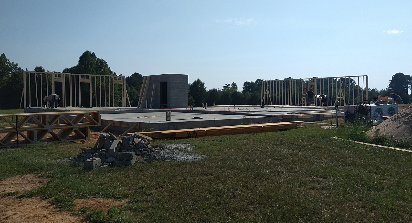

Ok let's get some framing pictures going. Like I had said a few posts ago, framing started 3 days earlier than expected. The slab was poured on Friday. Monday my builder sent the first picture below around lunch. There had not even been any material when I left for work. These 3 were from far l day 1.
