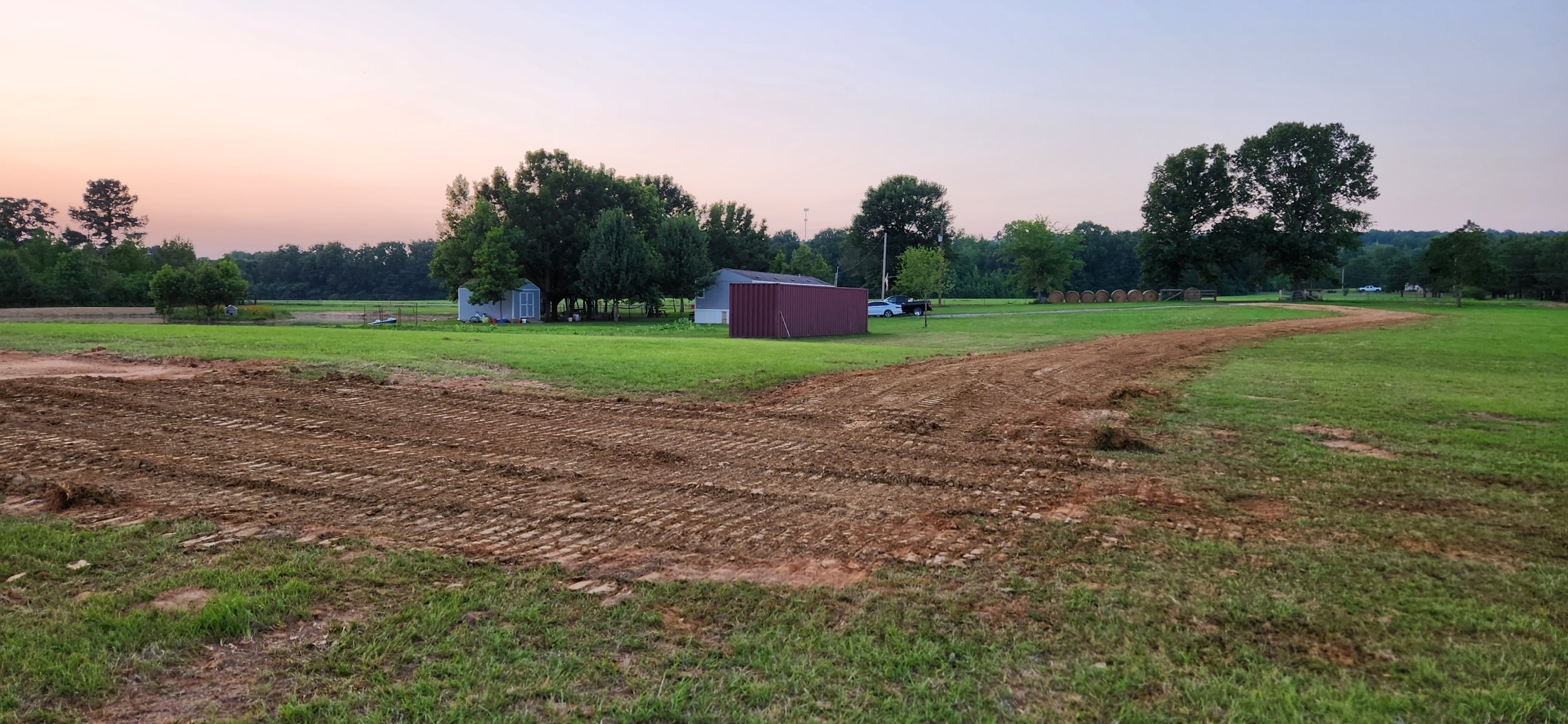

A little update. I don't think I have shared much progress yet. Here is a "start to finish" on the driveway.
I cut down the top soil with the dozer and hauled it to the back for use later. Then I made 2 lifts of shale. It was saved from the pond project last year. I'll wait as long as I can before I have gravel hauled in to cap it. I figure I'll have to grade it a few times from all the heavy concrete trucks and other deliveries.
/ House Build 2023
#73
Also it turns out it really takes longer than you would think to build a 450' driveway and house pad by yourself. Lots of climbing in and out of equipment. I think I hauled off easy 40+ loads of top soil and hauled back an easy 60+ loads of shale. I had help for the middle of 1 day. Other than that it was just me. In the track hoe, out of the track hoe and into the dump truck, back out of the truck and into the track hoe, then truck, then dozer, then truck, then back to hoe... and so it went for 2 full days and 2 evenings after work.
Worked on equipment all day Thursday. Dirt work from can-see to can't-see Friday and Saturday. Rained out Sunday. After work at my real job to can't-see Monday and Tuesday and finished Tuesday night. Tuesday felt like the longest day, I moved and graded 17 truck loads after working all day at my day job.
Builder said I would have had to pay around $10k if I had hired out the driveway build. I burned about $400 in diesel, so I think I ended up on the winning side.
