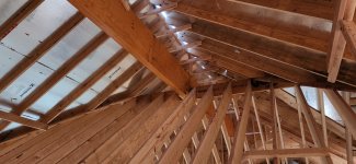

/ House Build 2023 #316
Those beams really set off the wood on you ceiling!!! Very nice.
How high up is your fan? On the box, there should be a diagram showing where the fan needs to be from the floor to be effective. Too high and you don't get any air movement.

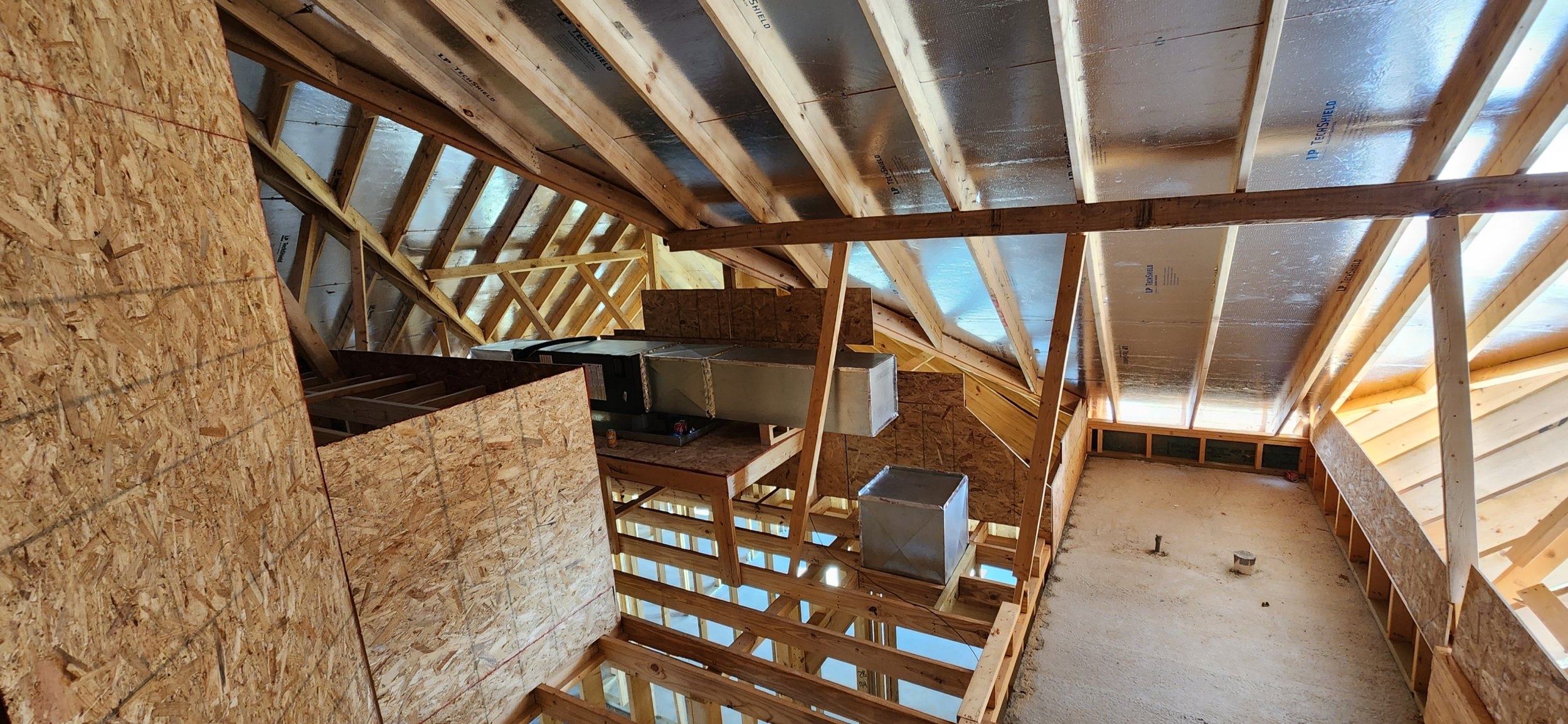

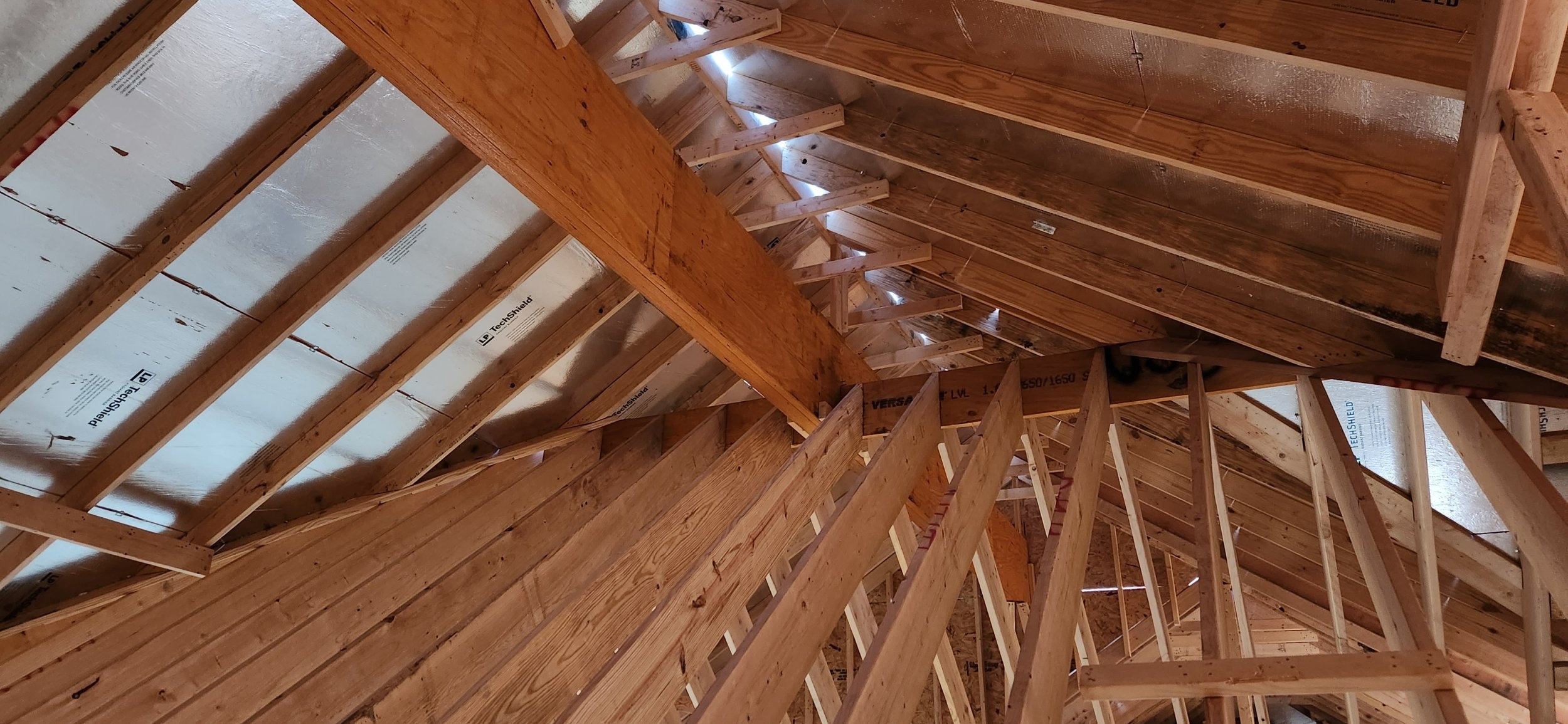

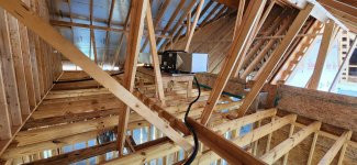

#317
The fan is REALLY high. The peak of the vault is about 22'. I got the biggest fan that I could fit between the trusses for a reasonable price. It's 80" dia. It only came with a 2' down rod so I had the center beam made 10"x10" so it would get the blades far enough down to clear the vault by about 8". I would have liked to have a bigger one farther down but this one was the best I could do without having to spend upwards of $2,000. It's supposed to move almost 10,000 CFM of air. I'm hoping it's enough to keep the air stirred up so I don't have hot and cold layers.
