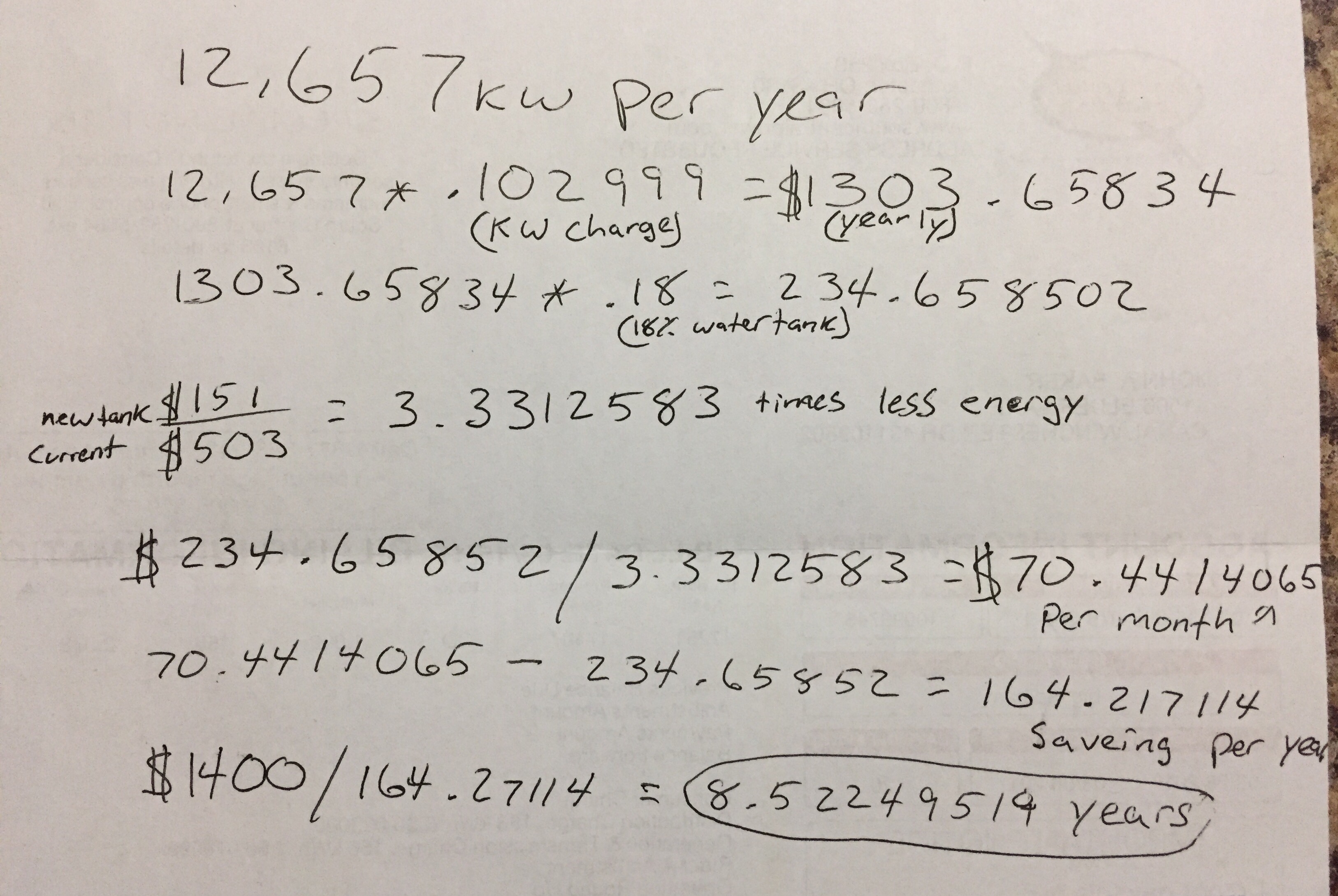

So I did some math today and it looks like this, some mistakes on it but I'm not rewriting it lol. IMG_7274.JPG
So that's the total KW usage of last year, they say that the hot water tank is an average of 18% of the bill, I used that in this figuring.
Long story short I'm looking at 8.5 years to make my money back on the heatpump tank at the home depot price. With the supply house I would guess that would be closer to a 6 year return on the investment after it's all said and done. But that's all based on my current usage, there's only two people living here right now, if kids come later the savings would be sooner. The heatpump tank is 3.3x more efficient than the current tank.

Scrapping a good item, spending money to buy something more efficient, is typically a bad idea . Unless you are doing it to save baby penguins, and not save money.
This comes up a bit with cars. People think just cause the new car will save them $50 month, it is worth spending thousands
4 year pay back sounds poor to me. Wait until dies.
A 4 year payback is pretty good actually, if you look at a new furnace and A/C that someone can spend 6-15k on, there return is often 10 years or more on a system that will last 15-25 years.
But there's also government tax rebates and a increase in property value, that can be calculated in the cost of replacement as well.
My electric furnace works just fine but granted I'm swapping that with a used NG 92% efficient unit that was pulled off a job site. It's sitting in my barn and is 8 or 9 years old I think. It will cost me plumbing in the concentric, gas line and a new A/C coil because the old one is too wide so I'm gonna cut it out and braze me in a new one that matches this furnace.
I like my heatpump but the emergency heat strips aren't efficient what so ever. The new heatpumps are good running down to 0 but I'm cutting mine off at 32. I feel below 32 I'm just trading dollars for hours on my equipment.
With my smarter Tstat I put in, I don't need a fossil fuel kit either, the stat is smart enough to keep the heatpump off while the furnace runs, only exception is defrost mode, the reversing valve clicks to A/C and the furnace has to run to compensate while the exterior coil thaws.
