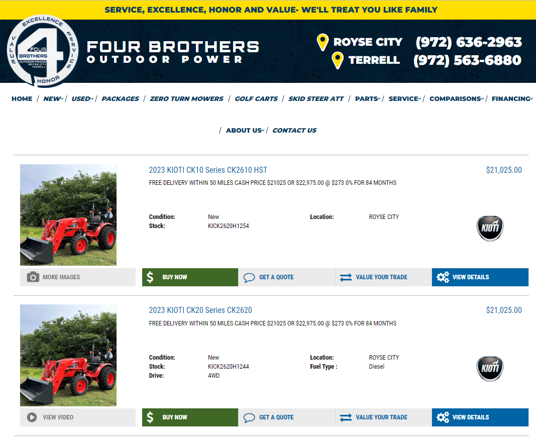

I think you need to keep shopping or find another Kioti dealer. The Kioti website and other dealers say the CK2610 is still available for 2023. It sounds like he doesn't have one on the lot and is trying to sell what he has in inventory. Ask your dealer what the cash price would be for the tractor. You will find the zero % interest means the interest is tacked onto the price upfront. If you pay it off early, you still pay all the interest. It is a sales tool to allow folks that don't have the cash up front to still be able to buy their tractor. Most manufacturers do it from time to time.
In the ad below $1,950 in interest is tacked onto the purchase price upfront if you finance and then payments are calculated at 0% interest. That works out to 9.3% simple interest. You may be better off paying the cash price by using another method of finance, i.e., bank, credit union, or ag credit, with a lower interest rate. That way if you pay it off early you get a break on the interest. You could also ask the dealer about the price using conventional finance rates.
Thank you. I may go and see them in person and ask more directly about the cost and "last year's model"

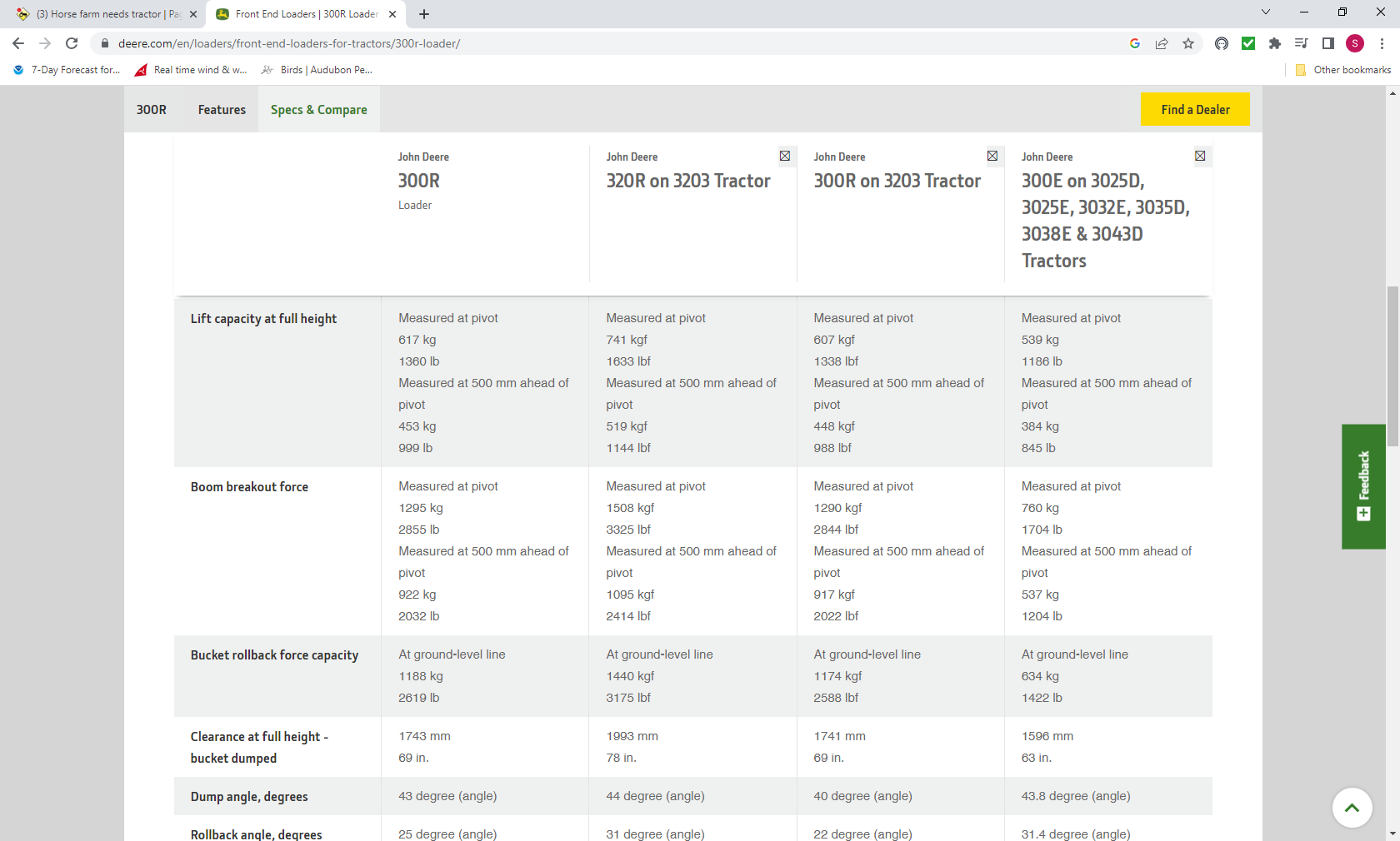

I think that depends on your intended usage. For me, my primary reason for buying a new tractor was to get a greater lift capacity. It was one of my top considerations in choosing a model, as I was so limited by lift capacity on my prior machine.
Regardless of what the salesman says, all makes and all FEL lift a similar amount
Here's a quick comparison of a 320R, 300R, and 300E on the same machine. You will see lift capacity varies 1180 up to 1630 lb. That's a "similar amount" in your book? I'd call it a 40% difference.
Ok. You give some figures and say, "I'd call that a 40% difference". So now we can talk.
I think you are going to find that we agree on most everything
Lets assume that those numbers represent basically the same loader on different models of tractor.
First of all, here is the "at the pins" versus 500mm (20") forward. Forward of the pins is what we want, because that would be at a usable bucket distance. Probably nobody ever used their loader to lift anything "At the Pins". So if you have a bucket then your numbers are not 1180 to 1630, they are 845 to 1144. But hold on, no bucket is mentioned. So we need to deduct the weight of the bucket. Call it 200 lbs without SSQA. So now 645 to 944. Doing the same math the same way you did, the difference has changed from your 40% (actually 38%) to 46%...THAT's GOOD! But the actual amount we are able to lift has fallen by 984 lbs.... THAT's BAD.
As a salesman, which number do you want to pick to showcase to our potential customer? Do you choose to showcase the spec showing the 46% greater lift? Or the spec showing 985 lbs less usable lift to full height?
And that decision as to which spec to use is exactly my point.
Not that loaders can't be different - of course they can be.
But my point is that loader specs can be manipulated by advertising and simple high school math in a way that confuses the unwary. That is why I would put loader specs at the bottom of my list.
BTW, did you notice on your table that those specs are at full height? Well, here is something you should know if using full height specs. If you take the same loader and change a few mounting points you will find that a higher spec at full height also ALWAYS gives you a lower lift capacity at the first half of the lift - from the ground to half height. Don't blame me; blame a guy named Euclid.
Ask yourself: How often do you lift to full height? Wouldn't you rather have the larger lift capacity from the ground to half height? Or from half height to full height as your chart shows?
Ask yourself why that loader spec chart doesn't show the one thing that you actually use? How about a spec showing lift capacity with a bucket & from the ground to half of full height.
I'll tell you why. It's because most same size loaders are very close to each other for what they can usefully lift for most jobs - even plus/minus 10% is not significant because it is the number that hydraulic pressure is allowed to vary.
So to finish, I agree with you completely about the advantage of a stronger loader.
But please know what the loader specs are actually telling you - or else don't use advertisements to make your decisions.
rScotty
/ Horse farm needs tractor #94
I agree with your math, rScotty. I’m an engineer, we both know basic physics! :) But not with the conclusion that all of these loaders have the same effective lift capacity.
That table is not showing same loader on three different machines, as you stated, but rather three different loaders on the same machine (or as close as is possible with the -E). The 320R and 300R numbers were in fact taken on the same machine, and 320R has a greater lift capacity than the 300R.
Also, you choose your bucket separately from the loader, when buying. I can put the same bucket on both loaders, there’s no reason to assume the heavier loader must also carry a heavier bucket.
