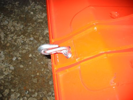

From what I can see in the pics the addition of hooks to the bucket are the equivalent to the kiss of death for tractors and they never work again/forums/images/graemlins/grin.gif
If I weld hooks to my bucket will it get all shiny like those pictured?/forums/images/graemlins/grin.gif
Does anyone have any pics of where not to weld on hooks to a bucket? Why don't I see any on the inside of the top lip?

Well, my bucket isn't shiny...
