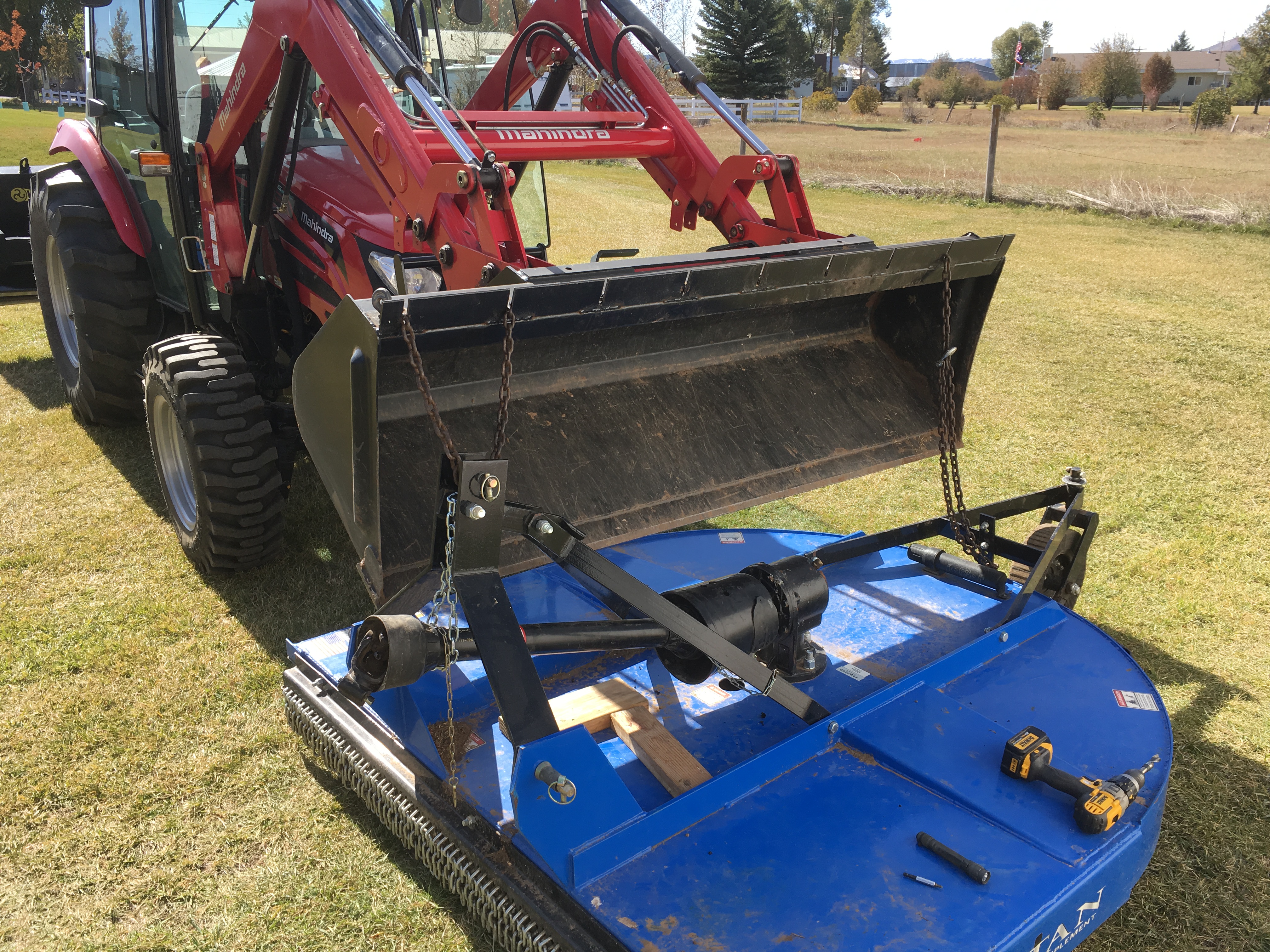

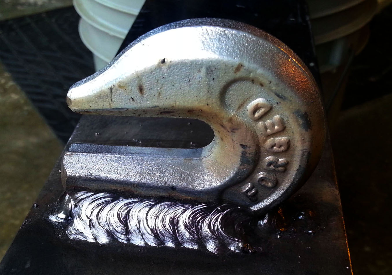

I went this homebrew welded route.
Easy to sling/support unwieldy loads in the bucket; you can see the chain under the MMM and then looped over the tractor to the grabhooks

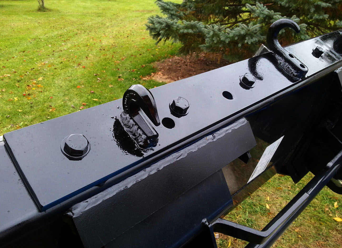

I would suggest welding hooks onto a solid steel plate then bolt the plate to the loader. That way if you ever needed to you could remove them very easily. I welded 3 hooks onto some scrap 3/8" steel plate that already had some holes in it and bolted it in place with 4 Grade-5 bolts I already had. I have used these hooks more times in the last 6 months then I can count ! Them and a piranha bar completes my FEL.

Kens sells weld on hooks also. I bought an excavator hook, and 2 weld on 5/16 hooks and welded on to my bucket. Your bucket has a 1/4" top plate like mine. You can just weld the hooks right to the top plate.

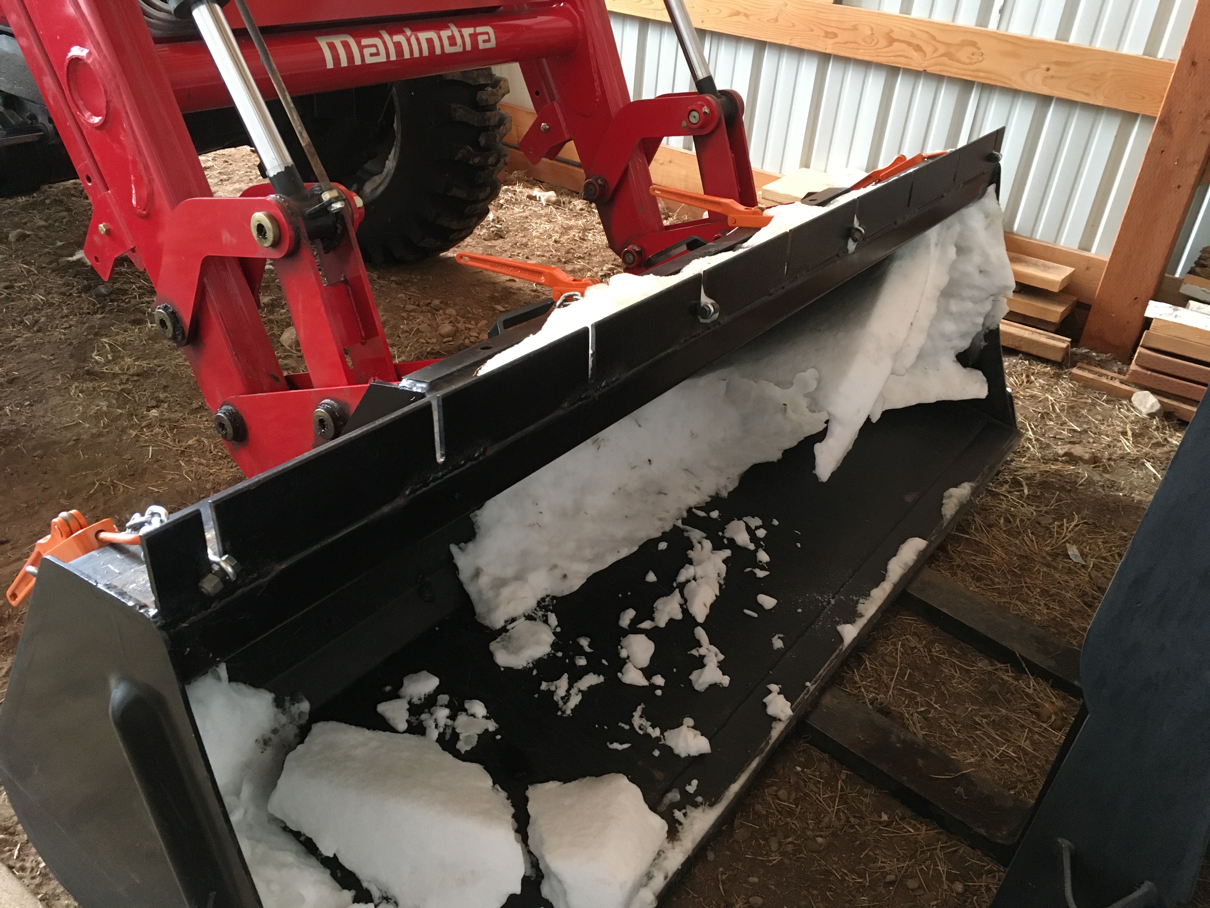

I sort of did my own thing.... I could make these for about 1/3 the cost of "other" options...
About 2 feet of 2 X 1/4 inch angle iron, 6 bolts (grade 8), 6 nuts, 12 flat washers, 6 lock washers...
Dale
The slots in angle iron is a great idea.
I will do it too!

You are welcome. I think some people do not realize that it can be pretty easy to develop several thousands of pounds of tension when connecting a chain from a bucket to some hard to move/heavy object. Unless the bucket is made of very heavy hardened steel they can be warped out of shape by mistake. A heavy duty plate across the top will help distribute those forces over a much larger surface area making it a lot harder to injure the bucket.

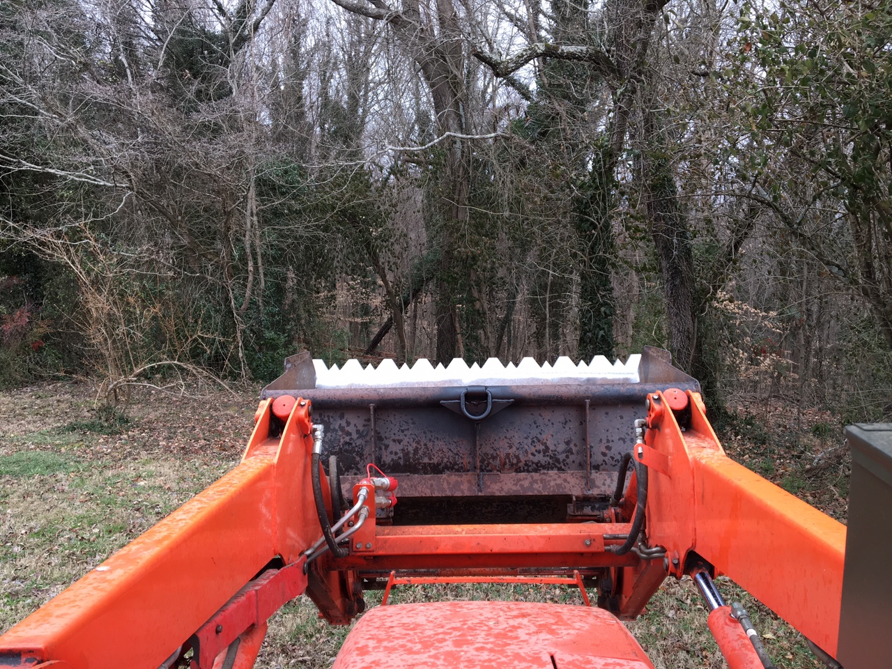

What I did is kinda, sorta like in the picture of post #19.....
I bolted a flat strap with a welded D ring inside and top side flange of the bucket. In line with the loader arms.
I use a pair of trailer safety chains with a hook on each end. The rings and chains are rated for more than my loader will lift. So I feel I'm good to go.
The 4' trailer chains will fit through the D rings, so I can choke a hook up as close to the underside of the Piranha tooth bar as I need to.
The 4 D rings assemblies, 2 safety chains, nuts, bolts, washers all for about $40 CDN...
Every ones needs will be different, but this works well for me.

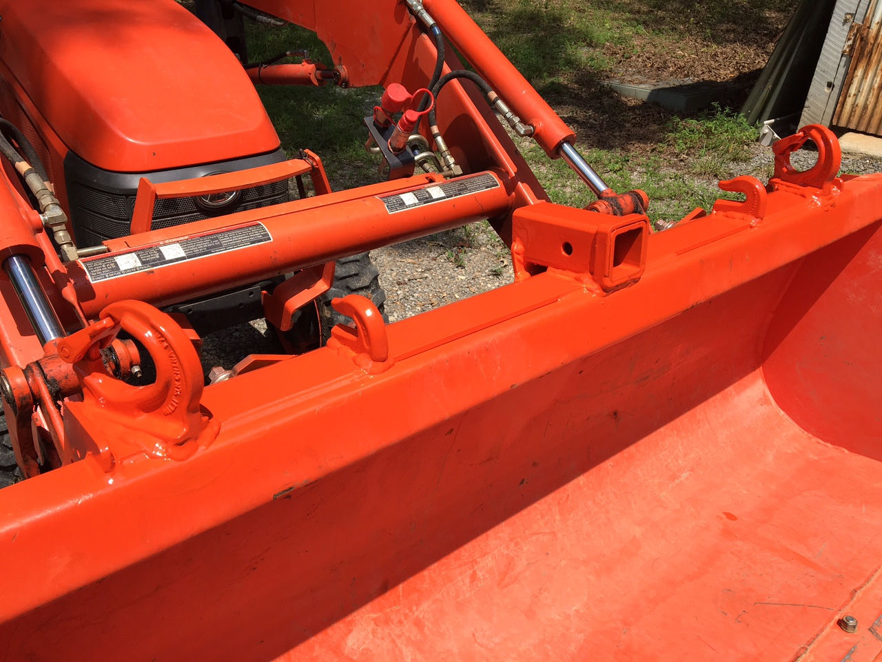

3ton Indusco hooks, 3/8” chain hooks and 2” receiver welded to top of bucket.
3/4” weld on ring with reinforced gussets.

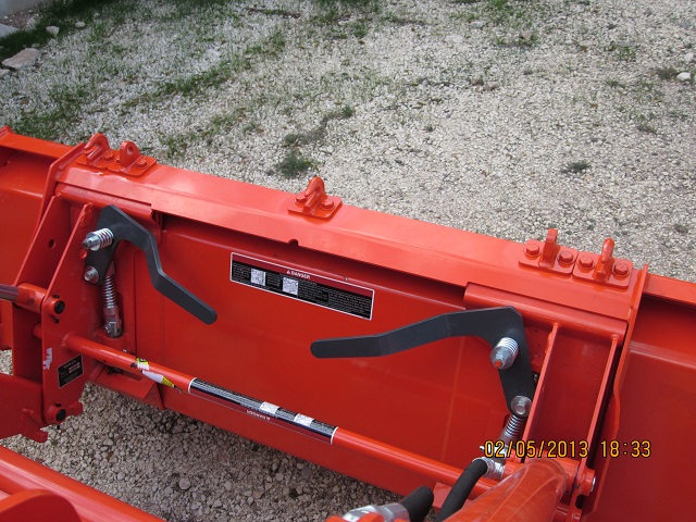

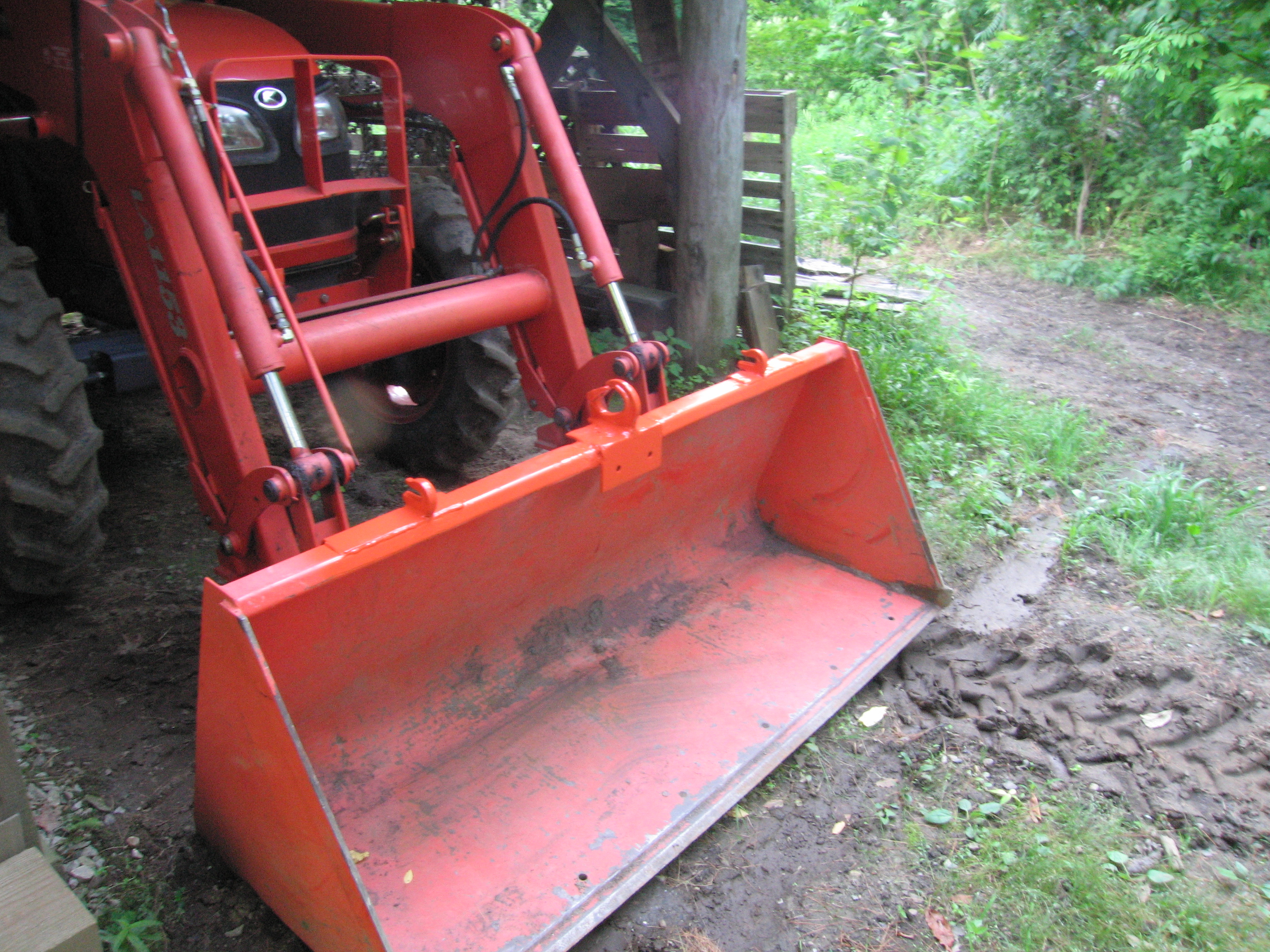

My dealer welded 4 hooks across the top of my bucket when I bought mine. I've used them many times since. Most have been very small, light loads of a few hundred pounds only. I also use them to steady a load I'm picking up with the bucket by wrapping a chain (usually) or sometimes a strap around something I don't want to fall out of the bucket during the lift and transport. Most common thing that comes to mind is when I haul my burn barrel (55 gal drum) over to the spot where I dump my cold ashes on an ash pile. The chain wrapped around the barrel keeps it from falling out of the bucket on the way.
I think this is the only pic I have that reasonably shows the hooks across the top, but you'll have to zoom in to see them well.
(found a better pic than I thought)

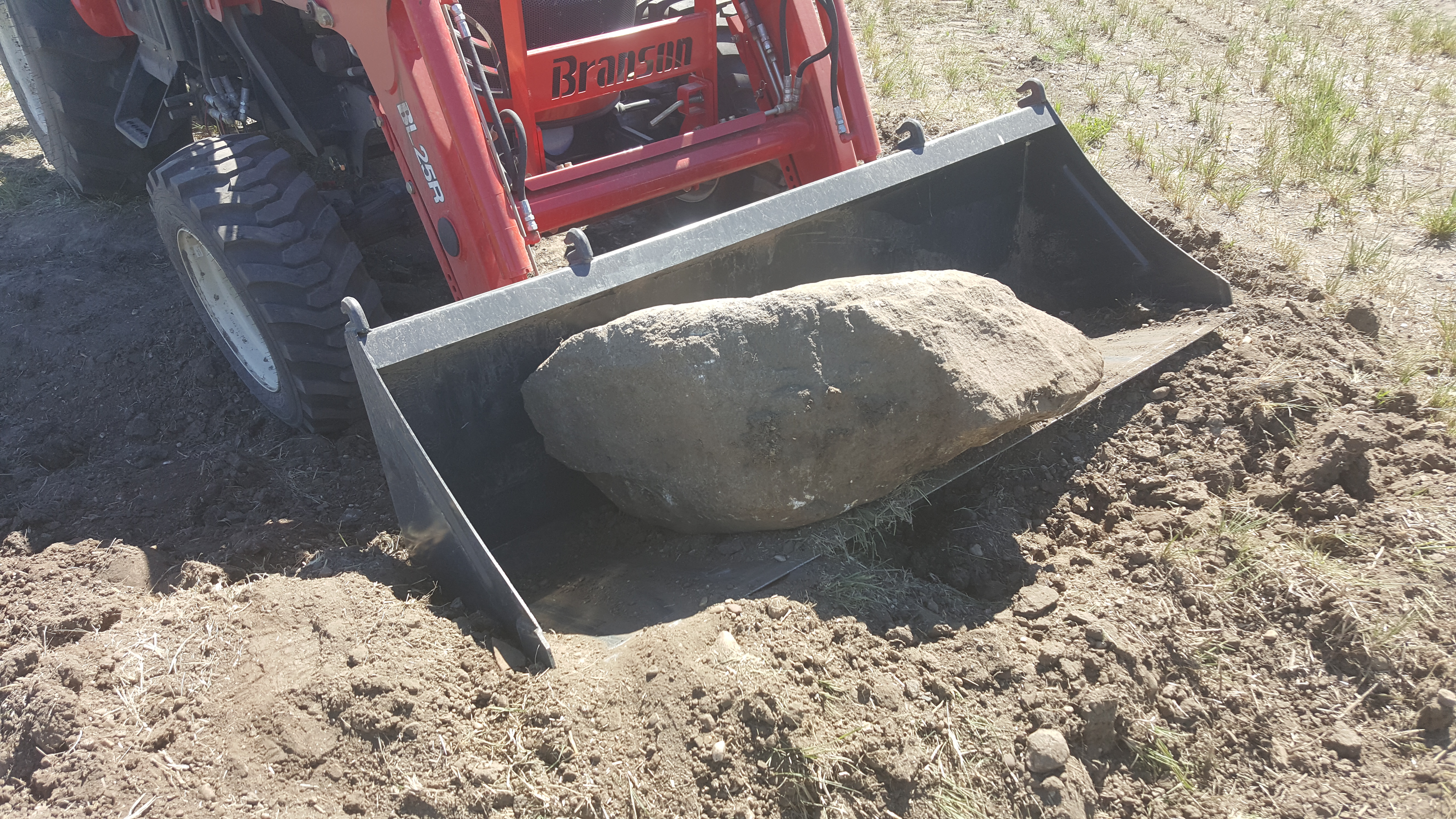

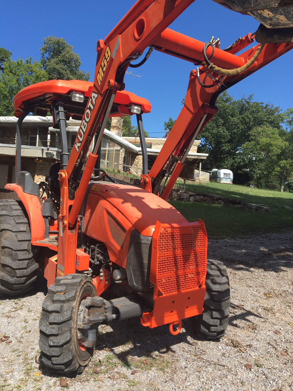

I just fabricated a bracket to fit front chassis cross member to accept a shackle... I have decided it's not really a good idea to use bucket for pulling even with the chain grabs.... Granted I will have to keep bucket up a bit bit its still below sight line over hood....Will still use bucket for odd lifts though, like the 350 pound granite pebble that refuses to move without some brute force... Pictures maybe later if rain stops...
Dale

Had a rock like that, that would not go into or stay in bucket.... Old snow tire chain used to form a "basket" [net] and linked to hooks kept it in FEL bucket...
Dale

I went a different route. I like to keep the top of my bucket clean. I welded a 3/8" piece of steel with a hole drilled into it in the inside top center of my bucket. A 3/8" grab hook fits nicely and is adequate for all that I want to do.
