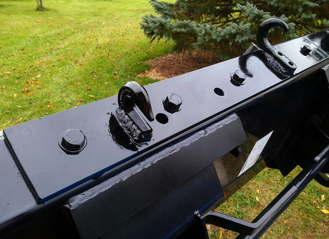

I would suggest welding hooks onto a solid steel plate then bolt the plate to the loader. That way if you ever needed to you could remove them very easily. I welded 3 hooks onto some scrap 3/8" steel plate that already had some holes in it and bolted it in place with 4 Grade-5 bolts I already had. I have used these hooks more times in the last 6 months then I can count ! Them and a piranha bar completes my FEL.
View attachment 633936View attachment 633938View attachment 633937

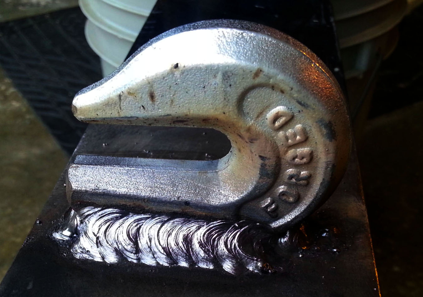

Very nice job. My Kioti came with plates factory welded on to weld hooks onto. If I say so, my stick welds look better than the factory MIG welds of the plate.

Sweet ! Yeah I have to use an old buzz box here so I get more splatter.
/ Hooks on Bucket #45
This is the little DC jewel that welded those.

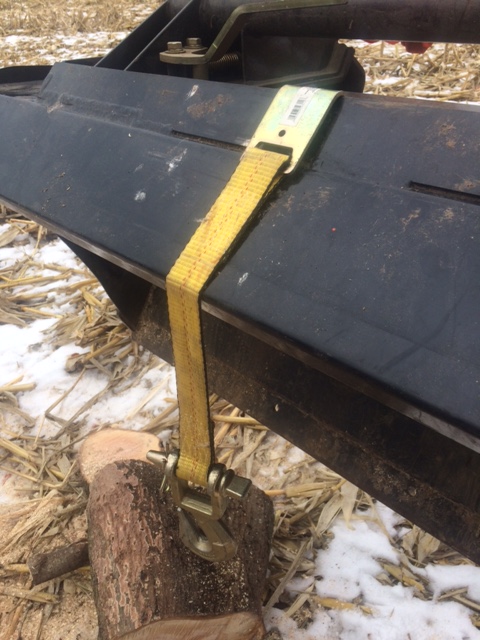

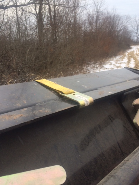

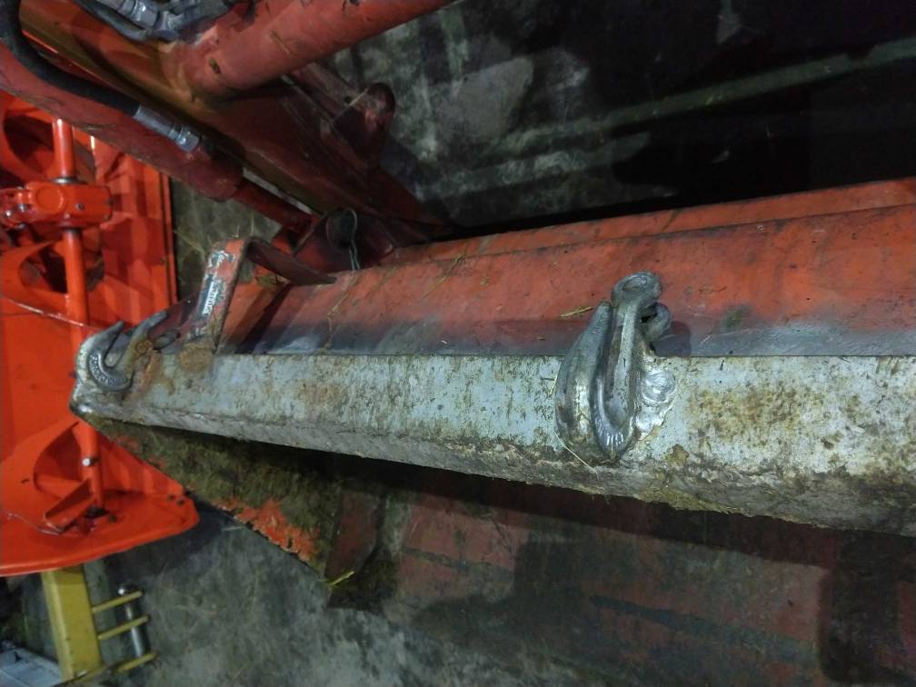

I have a Kioti CK30 and instead of permanent hooks I'm using a strap that comes with a flat hook on one end and a sown loop at the other. The strap is used by the tow industry to attach onto the rear axle of fwd cars. In the loop I insert either a D-ring or hook as shown in picture. The flat hook just hooks over the back edge on my loader or the cutting edge of the bucket. Easy and cheap and temporary and versatile HookA.jpgHookB.jpgetc. Dutchy
Yes they do, I am a fan of stick also James :thumbsup: I have both but in this situation I like stick.

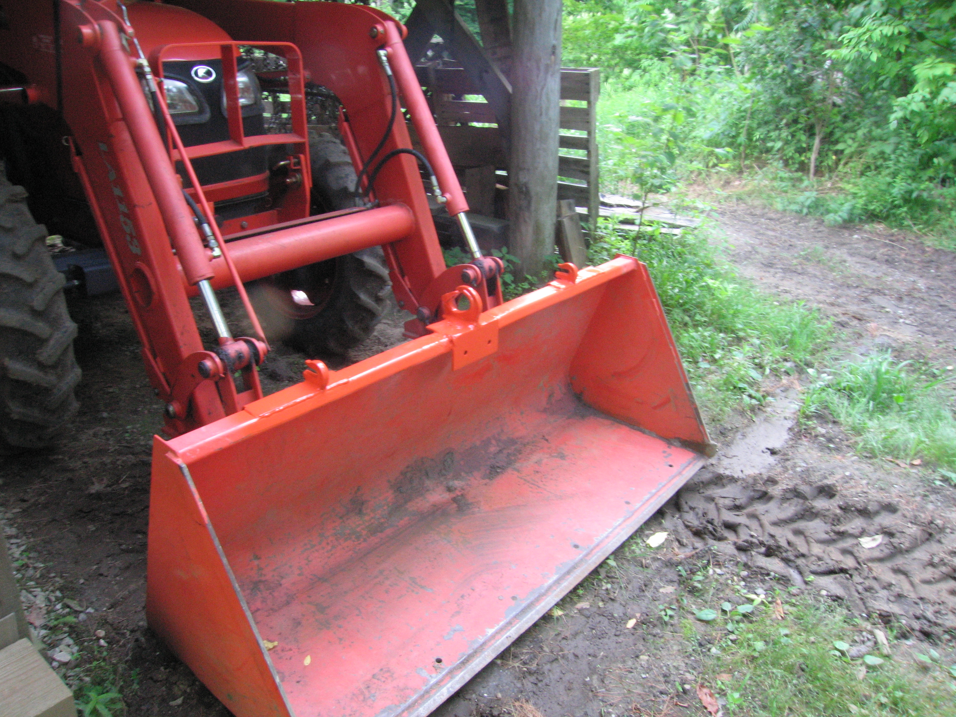

Here is what I did on our B7500 when I rebuilt the loader bucket.
I welded a piece of 2"x2" 3/16" angle to the top of the bucket and then welded hooks to that. I left the clevis part of the hook for the chain would normally go sticking out the back so that I can hook a chain through it if I need to pull from behind the bucket.
I'm not sure what it did to the ultimate strength of the hook, but given that it is a 19 horsepower hydrostatic tractor, I don't think I'm going to be able to hurt it.

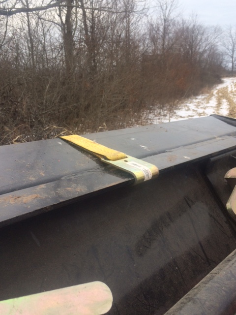

I have a Kioti CK30 and instead of permanent hooks I'm using a strap that comes with a flat hook on one end and a sown loop at the other. The strap is used by the tow industry to attach onto the rear axle of fwd cars. In the loop I insert either a D-ring or hook as shown in picture. The flat hook just hooks over the back edge on my loader or the cutting edge of the bucket. Easy and cheap and temporary and versatile View attachment 634300View attachment 634301etc. Dutchy
I like it

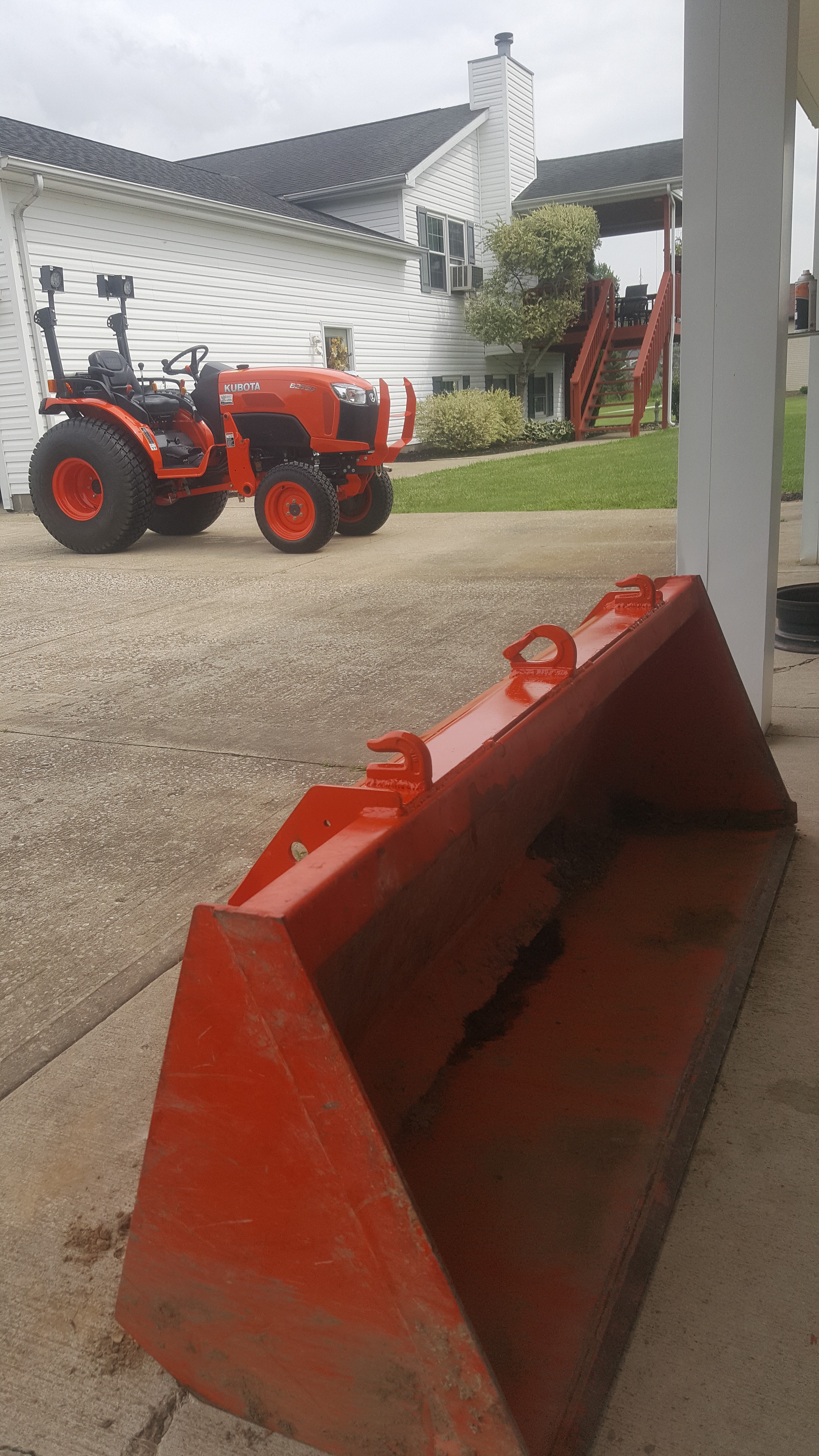

I welded two chain hooks in line with the loader arms, similar to what most guys do. I found they were lacking when I needed to chain the bucket down to the trailer or when I chain the bucket to the forks when loaded on the trailer, so I had some extra 1/2” D rings I welded on. I cut 4” square pieces of 1/2” plate to beef it up a little more. My loader will pick up 2 tons, so I wanted it plenty stout.
That is a VERY good looking weld in my book. Nice.
Thanks. I was kinda proud of it. AND another commercial welder took my photo he got from the internet and posted it on his own site as an example of his own work!. I was pretty pixxed off and told he so, but he didn't seem to care. It has been several years ago, and another TBN member had seen it and mentioned it to me.
