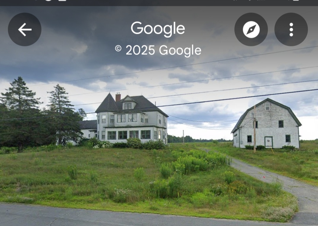

How people USE a house has changed overtime. Back when looking for houses, we looked at many, many older houses, but they were designed for a different age, and different life styles then most of us do now.
True, but due to the shrinking size of modern households in comparison to our agricultural forefathers, there's often plenty of room to reconfigure these big old farm houses. My house is very old, but has been retrofitted with 3.5 bathrooms, 3 kitchenettes in addition to the main kitchen, a media room, a small billiards room, an exercise studio, a practice studio for my band, and many other things you'd normally find only in a newer home. There's even a changing room with four closets off the master suite, which I'd guess was originally a bedroom for several kids. We have three dedicated laundry rooms with washer/dryer hookups, one on each floor, due to prior owners moving the laundry more than once. We only use one as a laundry today, the other two are now reconfigured as a walk-in closet and our pantry.
The amount of square footage per member of household has gone up in recent generations, but some of these older generations were very large. Based on my research of the history of this particular house, it seems the size of household might have peaked around 14 - 15 residents at one time, here. This forced prior owners to add on accordingly, leaving plenty of space for the modern needs our much smaller family today.
The trade-off is that our bedrooms are smaller than you'd find in a modern house of similar size, something that bothered me when we first saw the place, but which hasn't really been much of an issue. We've learned to trade public space (great room + living room + den + rec room = 4 living rooms) for private space (smaller bedrooms).
I'm not trying to talk anyone into an old house, it really should be left for those who have the energy or money to maintain and do proper restoration on things like old doors, windows, floors, and moldings. But there's also no reason to think they can't be made to suit modern requirements with some reconfiguration. We and prior owners of this house have managed to keep all the original doors, windows, floors and moldings, but have admittedly moved a few interior walls, added closets, and made some corner chases to provide space for plumbing, wiring, and HVAC ductwork.
