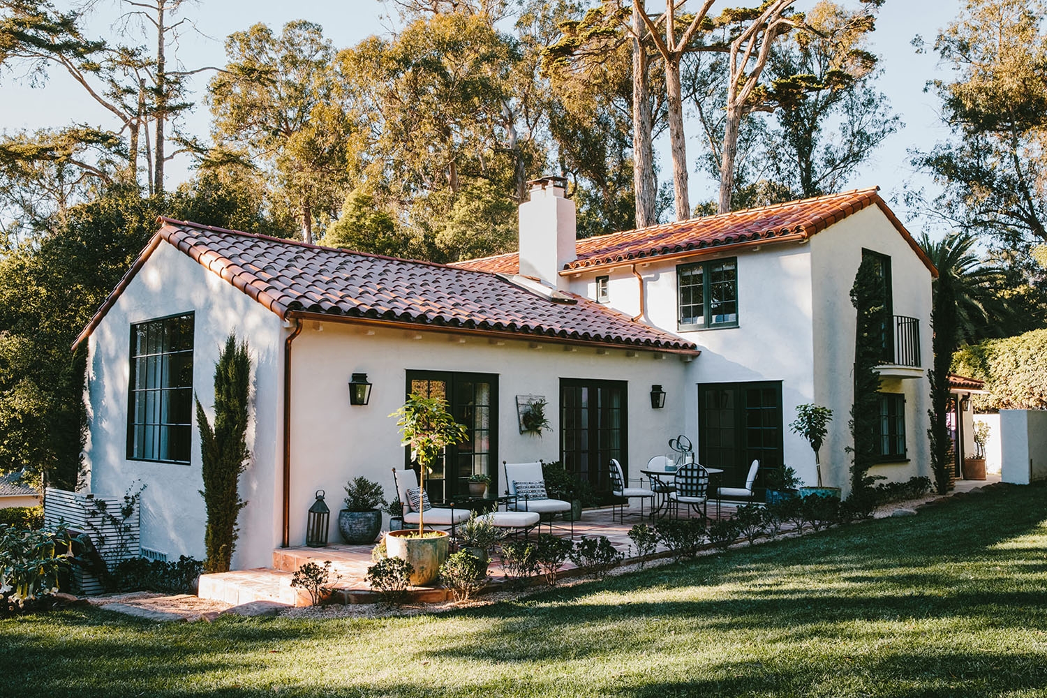

Bought a 1940’s house on a 50’ x 162’ lot last year. Fought off seven multiple offers to win the house, because the owners had been in it 40 years, loved it to death, and did not want to Builder to trash it. They were very happy to let us have it.
They have kept it up VERY well over the years, completed a family room and a rear addition with a lovely kitchen, and it is all we need
There are a few things to do, but I have a huge amount of construction experience and can handle it. (For example, putting in central vac.)
I have spent more than enough years, renovating old houses that I want to just basically relax in this place. My daughter, of course has other ideas, and wants to build a brand new house like the ones next to it when she gets married and has children.Fine. She can do that when I’m dead and gone.
This is definitely one of those examples where this very well built 75 year-old house is better than the new ones going up today.

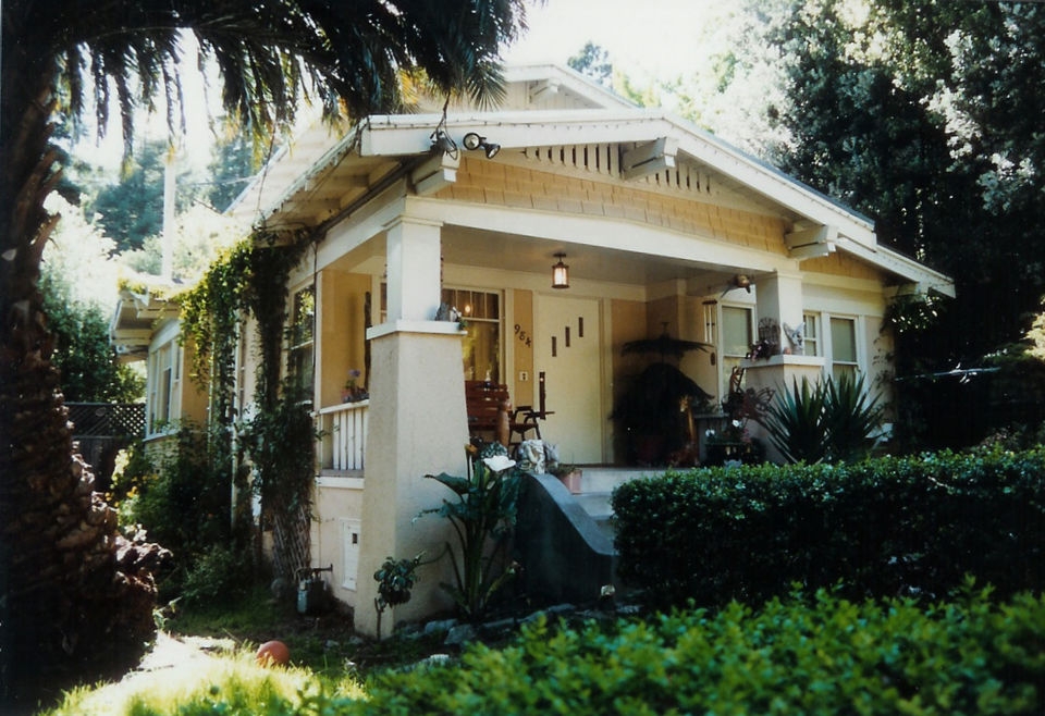

I think the reason so many 100 year old homes here have weathered well is the very mild California climate…
Somewhere I have the original bill of sale listing down payment in 1922 as $10 US Gold.
The layout and craftsman standards like the Bay Window, Built In Hutch and Matchstick Hardwood are appreciated 100 years later…
I like the original double hung windows, door hardware, 1922 high leg stove and gravity central heat…
