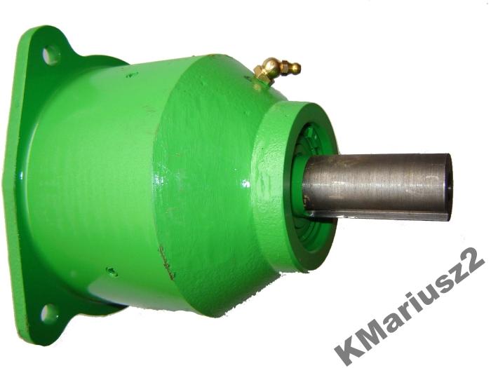

/ HOMEMADE TRACTOR START #30
I saw on a Polish auction site--the Polish version of E-Bay(although that is here too, just not popular.)--a small planetary gear reduction drive that was only about 30 cm long (1 foot). Something like that between the transmission and the rear end it seems like that would be ideal. I do not remember the hp rating of it. I am going to go look for it.
Mike
Ah found it. it comes from the reduction drive for a mower drive for BIG tractors.
i checked ebay quickly and found a planetary reduction 4:1 ratio, but also 5:1 and others. I searched on "planetary gear". link

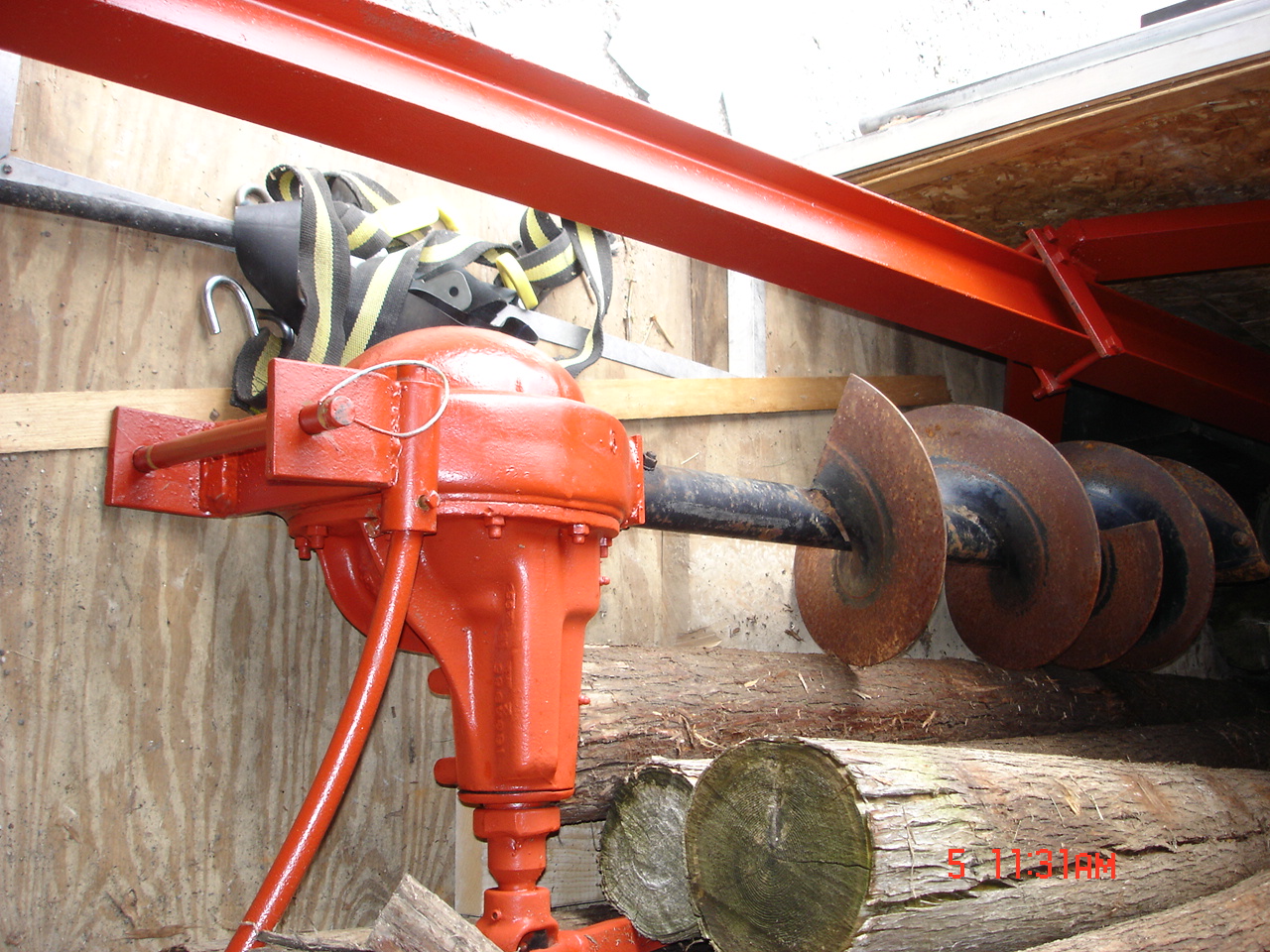

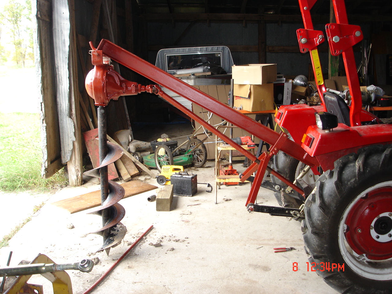

Nice project,
Like most projects it will evolve as it goes on, the other posters are right you are going to need more gear reduction that engine isn't going to like lugging around and your breaks are going to wear out fast tring to hold it back.
5.13 is the one of the largest gears you can get for that rear.
here are a few options that come to mind
2 transfercases linked together would give you a crawl raito of about 100 to 1and a lot of gears to play with but you will have to lenghten the tractor about 2-3 feet.
Another idea is 2 rear ends this idea would give you a lot of ground clearance.
take another rear end and cut the center (diff) out of it turn it 90 degrees so the tube or axles would point up and down and the input points to the tranny. weld/spool up this diff. and spline the bottem axle use a coupler to the original rear which will have to be rotated pointed up. so the input is of the new diff connects to the tranny and the axle pointed down is the input for the original rear end. cap off the top axle tube. I hope I explained it well enought that you get the idea this idea would keep you from having to lenghten the tractor with multiple trannys and transfercases.
I hope this help I have built a few monsters in my day and have learned something new from everyone of them.
That is a great idea, if he uses a 3-1 or 4-1 rear end ratio to drive his origional 5-1 he will end up with a 15-1 or 20-1 overall for the rear end. I don't think you would have to raise the tractor to do it, just think outside the box a little. A post hole digger gearbox would be perfect for that application. The one on my PHD was made from an old outomotive axel and it would also work but isn't as compact .:D:D.
the origional axel could be rototated with the input shaft pointing up. The post hole gearbox could be mounted behind it and offset to one side with its output shaft pointing up and the input shaft pointing forward, and located just above or below the origional drive axel shaft whatever worked out best, I suspect below would be better. Then a chain and sprocket drive could be fabricated to connect the output shaft of the PHD gearbox to the input shaft of the origional rear end now that they are both pointing up and the ratios could be almost infinitly adjusted by just swapping out the sprocket sizes to best fit the desired overall ratio. The chain drive could live in the area under the seat, and the position of the origional rear axel could remain the same. It could be a very compact arrangement with great results.:D:D:D
You could even build a sealed chaincase.
On second thought you could just fab a chain reduction. Rotate the input shaft of the axel up a little, fab a pillow block bearing support for the driveshat end that places it below the axel input shaft and parallel to it, you might have to shorten the drive shaft a little. mount a 15 tooth sproket on the driveshaft and a 45 tooth sprocket on the rear end input shaft, fab a cover/scatter shield for it and you are done with no sacrifice of ground clearance and without taking up a lot of realestate with mechanical parts for an efective overall ratio of 15 to 1 or use a combination of a 12 tooth sprocket and a 48 tooth sprocket for an overall ration of 20 to 1. Some good 630 O ring chain and sprockets from an old Kawasaki 900 or 1000 should do the trick.
