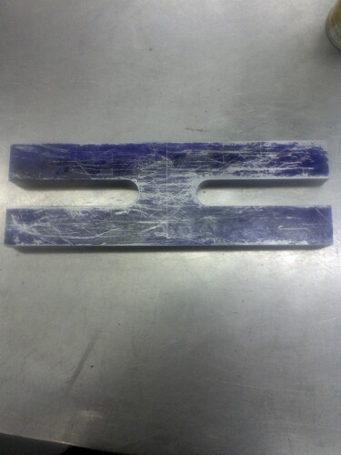

Thought I'd make me some quick hitch hooks like the carter EZ-hitch ones:thumbsup: Seems every one likes them that has them. And my implements have just gotten too heave for me to want to wrestle around. A 700lb blade and an 1050lb bushhog arent fun to hook up.
Here is Where I am currently. Had a peice of 1" x 4" x 12" steel. I have got the slots milled currently.:thumbsup:
Back to work on them:confused2:

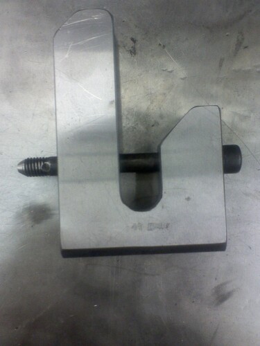

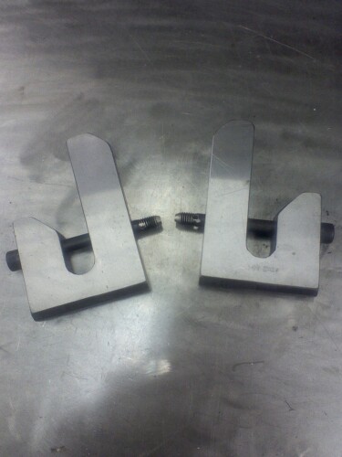

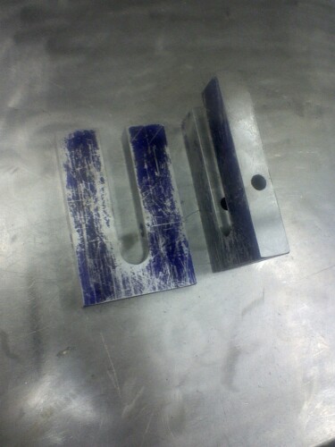

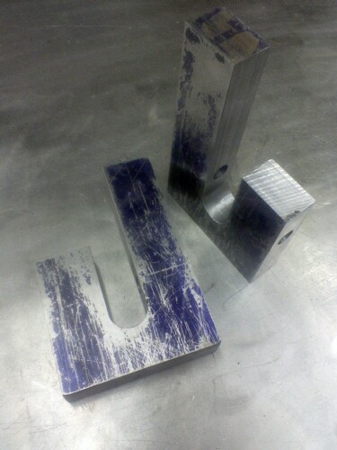

More pics as we go.
Got the holes drilled, and rough cut. Just need to do the beveling
/ HomeMade Quick Hitch hooks
Finished product. Now all I need are some 3/16 cotter keys or 3/16 lynch pins. I havent decided yet:confused2:

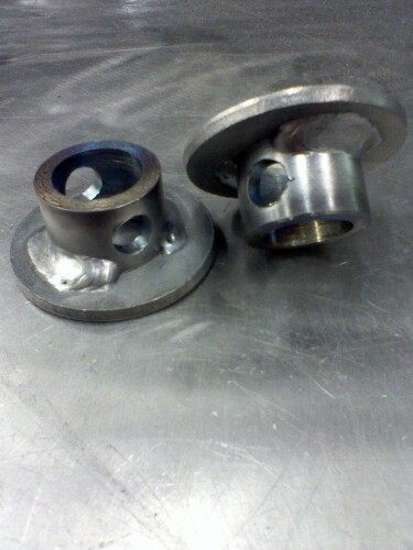

As promised. Heres my take on the washer things to keep the implement on.
The washers look nice too!!!:thumbsup:
I dig the washers. I just bought a Pat's Easy Change and it came with 3 sets of their washers, but I like yours better. Guess it's off to the shop to go make some. :thumbsup:
Yea, I thought I'd put my own twist on them. Instead of just the bent washer, or smaller washer welded to big one, I thought this would help keep the wasker from flopping around as much and doesnt look as tacky.

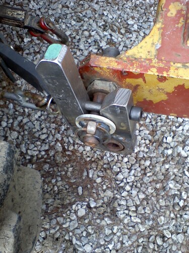

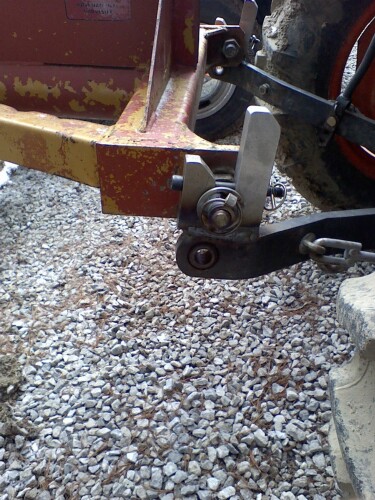

Well...I got around to installing them today.
The welder was at dads and I didt want to cart the tractor over there so that is why I said it would be a few weeks earlier. BUT, I just took the lower arms off and ran over there.
They work pretty good:thumbsup:
/ HomeMade Quick Hitch hooks #15
Nice lookin' job!!:thumbsup:... I really like those because they stay on the lower arms all the time!!
Thanks for sharing!!:)

Nice work, and they look good too! That should help things hook up a lot easier.

That's very cool. Always on the arm, but out of the way in case you need to use the original mount holes. Very slick design. Thanks for sharing.
Thanks for the complement, but I must confess, it is not my design. It is made by carter and sons tool and die. I just copied the idea the best I could.
