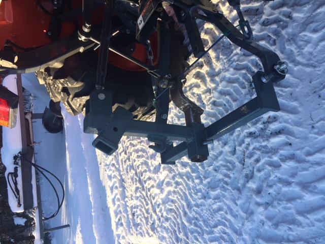

I have been wanting a quick hitch for some time now, especially since I built my counter weight. It is not fun at all to hook up and because of that I don't use it as much as I should for loader work. My snow blower is a bit of a pain to hook up also. I have never used one before but I think I would like something like the Pat's QH better than the standard frame one. The only part of hooking up to the 3ph is trying to line up the pins with the holes in the lift arms. I have searched high and low in Canada for a place that sold the Pat's but came up empty handed. A member on here had one that he was willing to sell to me but when I checked on the shipping to Canada it was outrageous, so I built my own. It was really quite easy and took minimal material. 2x2x1/4 rectangle tube fit nicely over the lift arms of my L2501. I cut up some 1" plate, drilled some holes and welded them together. It is attached with L9 bolts and a grade 8 bolt for the keeper pin. I will be drilling a hole in the keeper bolt to install a small linch pin for easier use. All together it took about 3 hours to build and it works great. I don't have pictures yet of it on the tractor but here is one before paint.

That's pretty slick, nice job. I modified my lift arms so they telescope, but I think I like your way better. Took me a lot more than three hours too.

Interesting. I actually borrowed the idea from titan but modified it a bit but it's actually neat to see that the exact idea is out there already. So I guess I can't take any credit for the design, it's already been done. I never built a spreader bar because I don't think it is nessesary and it's just one more peice to complicate things. I keep my turnbuckles adjusted and use a bungee to hold the lift arms secured from spreading. If I need to spread them I can easily. If I accidently lose the bungee, I have several others. I'd probably just run the spreader bar over any way. I always have my trailer mover on the 3ph anyway when theres nothing else on it.

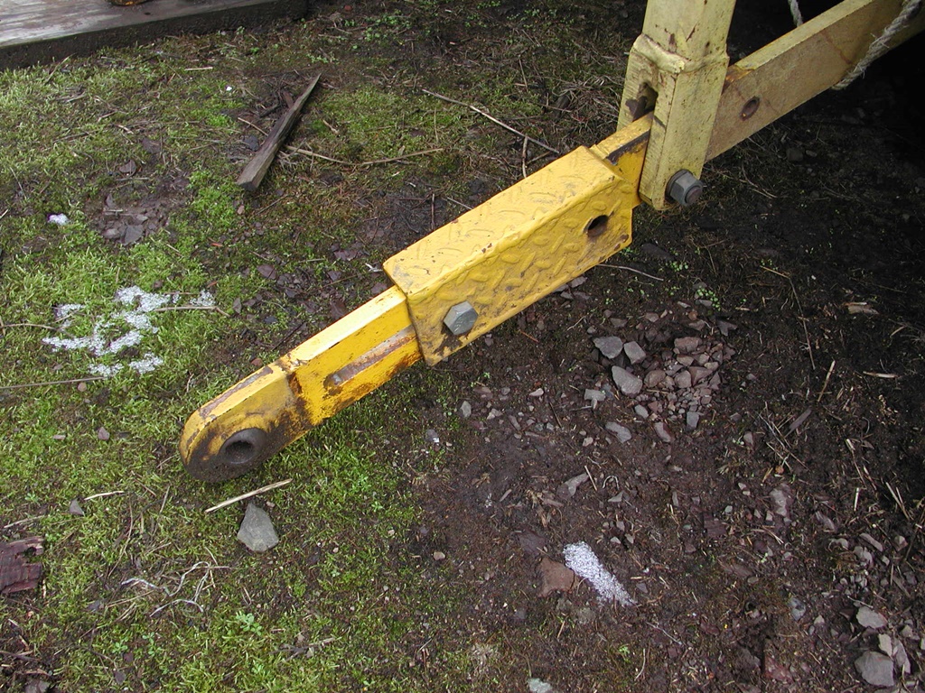

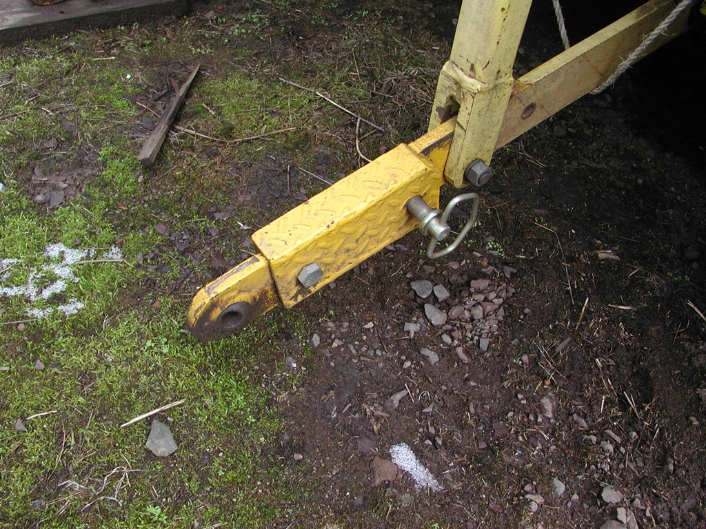

Can you show how you did this?
John Deere has some that do this made out of square tube (3020/2640 and others). Due to that that I have considered make new lower arms for my tractor out of 2" receiver hitch tube so they can extend.
/ my simple quick hitch #12
I cut the end off the arm and welded an extension on it with a slot in it. I made the arm into a box with some 1/4 diamond plate I had.
