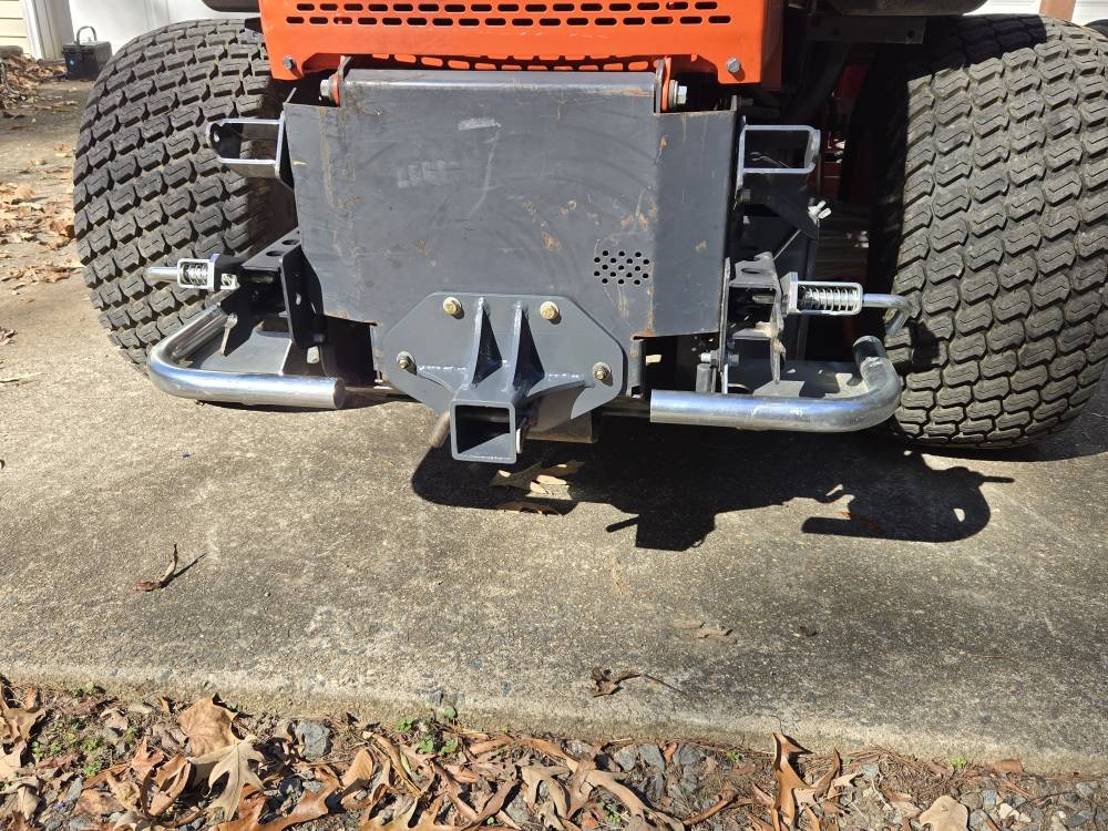

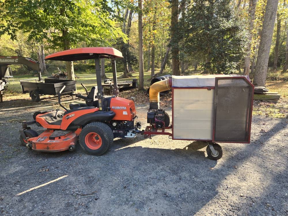

I wanted to be able to hook up my vac to the ZD for leaf cleanup this year, normally the Wheel Horse 520H handles leaf pickup but I wanted to be able to use both in case the old 520 goes down.

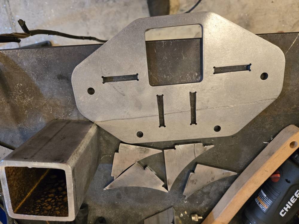

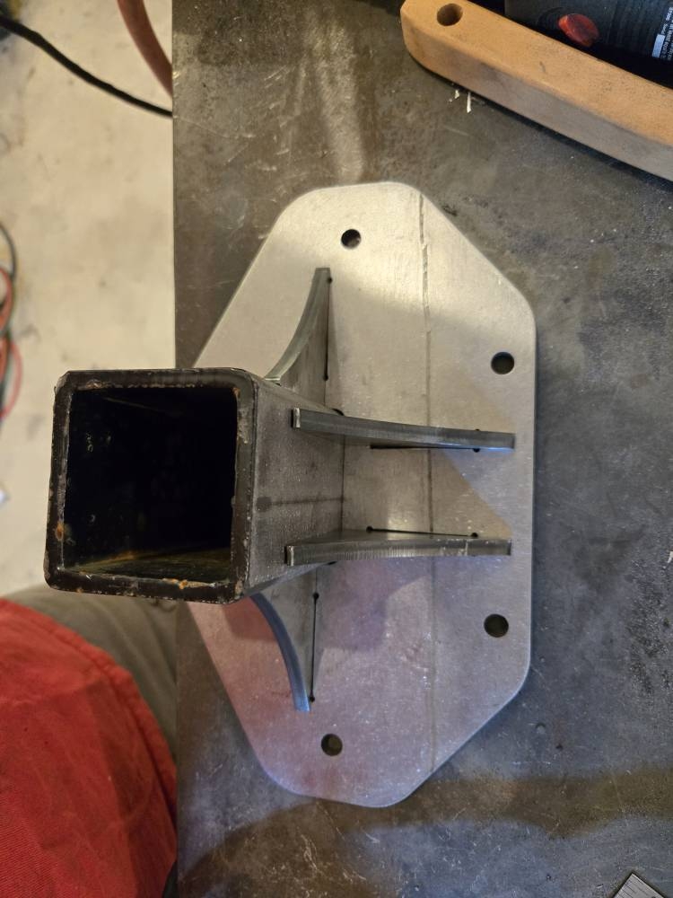

I've been extremely busy but finally got time to cut out and weld up a hitch, we'll see how well it works here soon, only had to drill 2 new holes and put in riv nuts.
It is a long setup to maneuver.

Nice looking fab & finish work.
You should make those & sell on FBM or Ebay.
   / Tow hitch for Kubota ZD331
Thanks, not sure what the market would be for these, Im going to see how it holds up this leaf season and make adjustments if necessary.
   / Tow hitch for Kubota ZD331 #4
Excellent work, once again. Just re-read your tractor remote thread again too...
