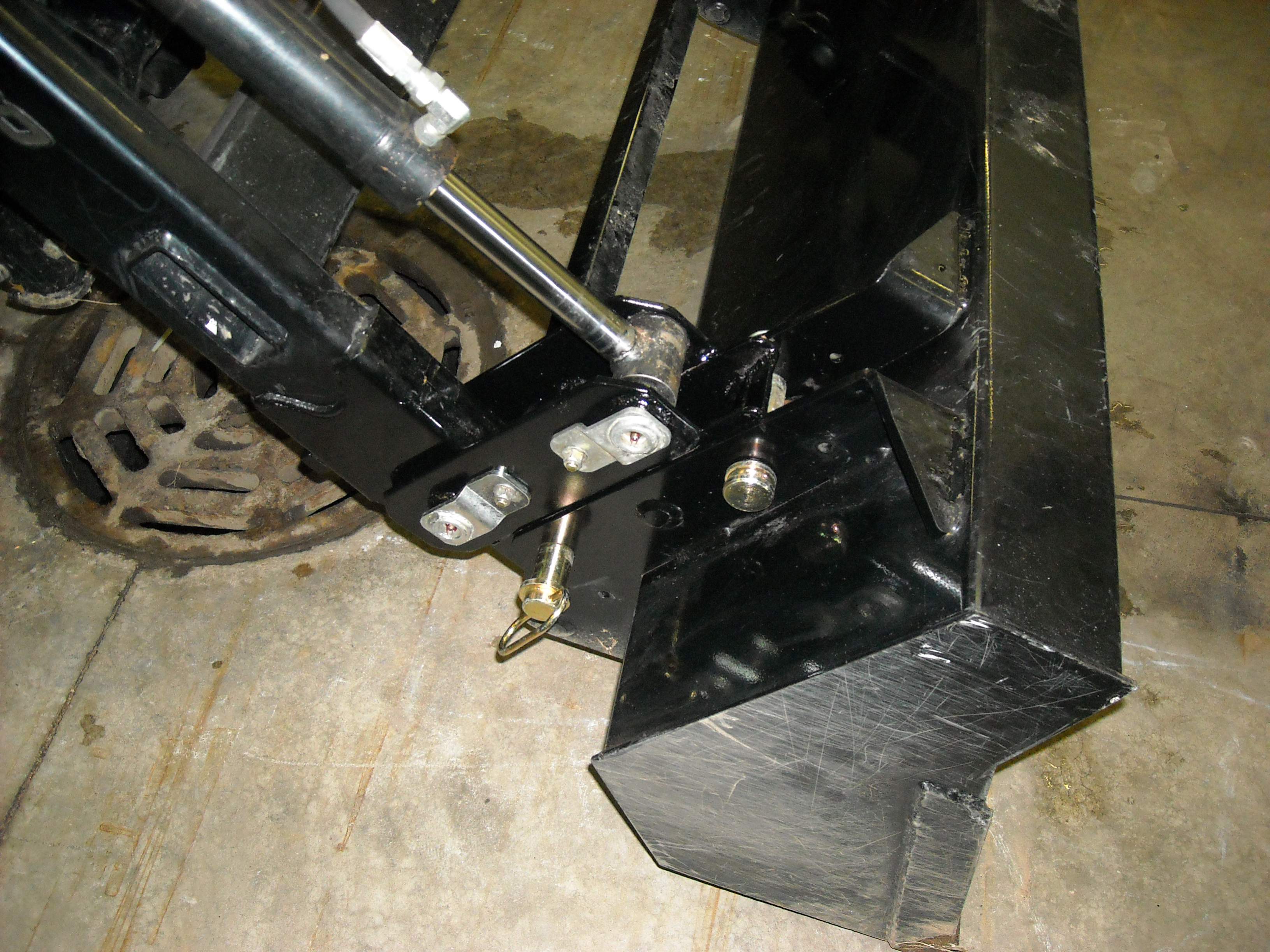

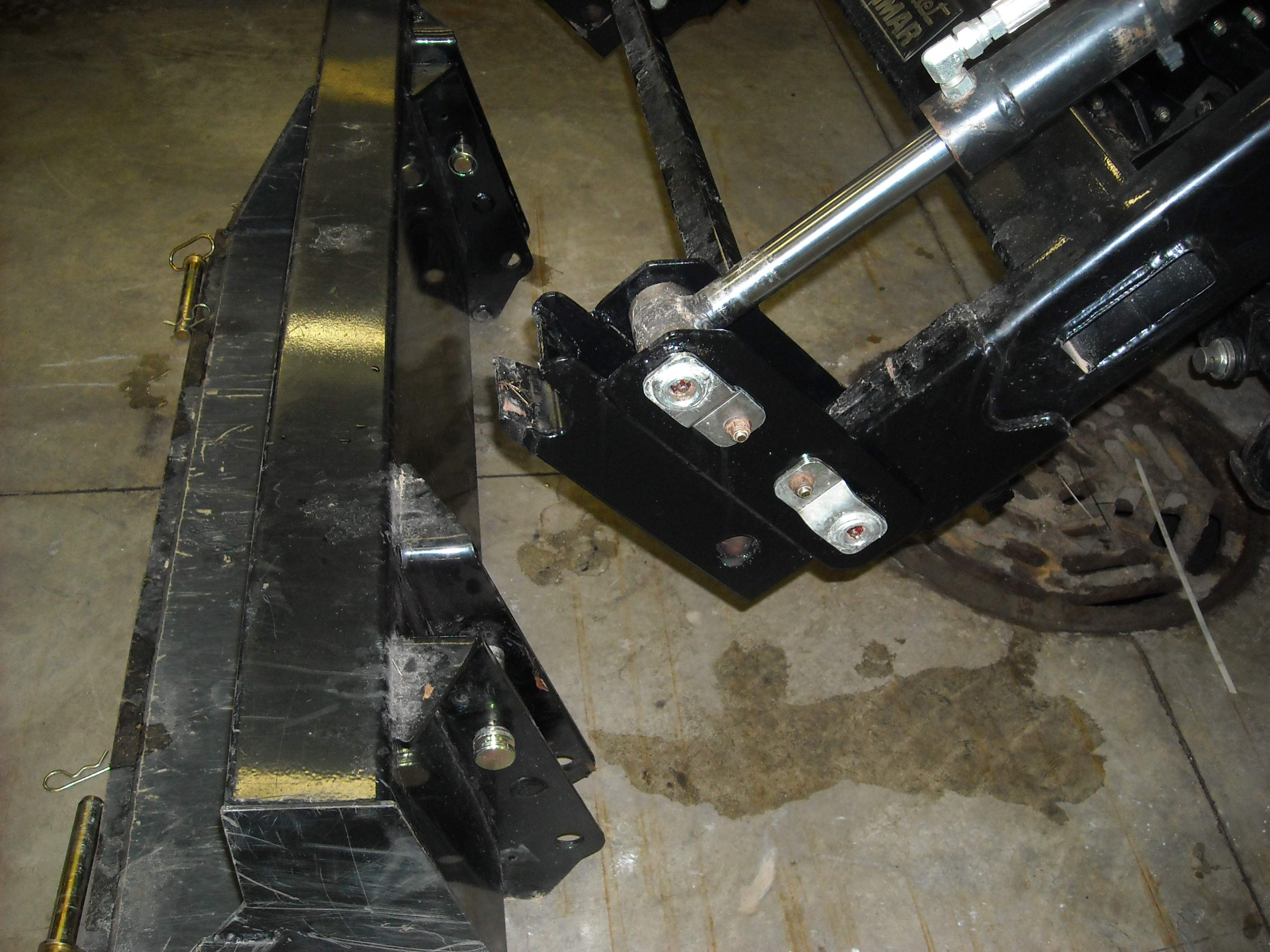

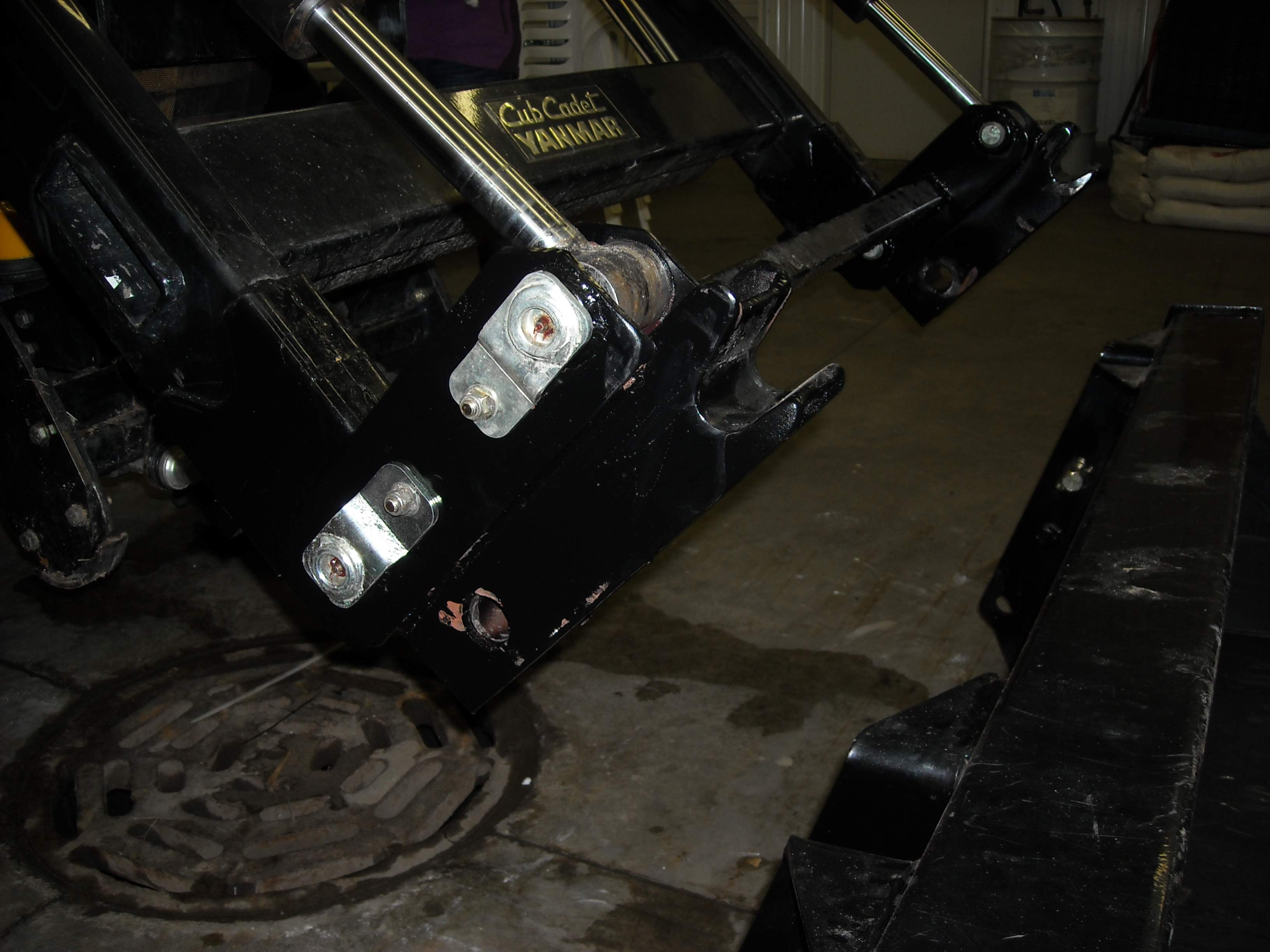

I added a piece of 1 1/2" x 3" tube with a 1/8" wall thickness. I added a 2" receiver to it so I can move my trailer around.
