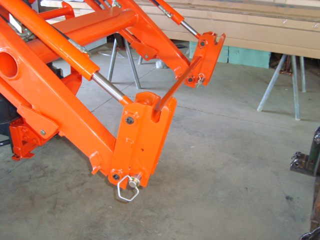

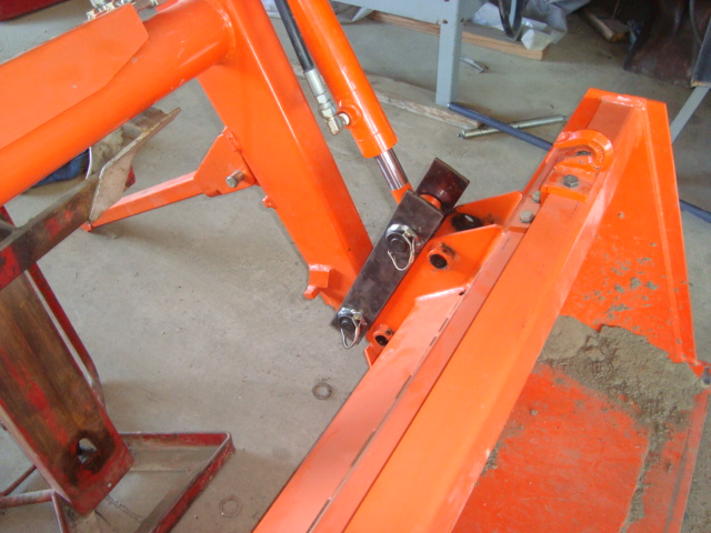

The one question I have that I really cant figure out is it looks like your pins from the tractor side are staggered lower by an inch or two from what the bucket side pins are, whats the reason behind that?
edit- I think i answered my own question but, you must want the pins in the same plane when the bucket is level on the ground and the loader pins are the same height as the bucket pins would be correct?
/ Homemade quick attach #22
Very likely the reason he did it that way. My Kubota one is like that, I presume for the same reason.

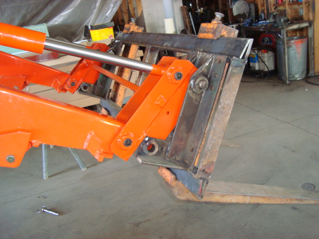

I live close to the Garner store so if you need me to stop by, not that I need a reason to stop by :D, I'm sure I can fit two into a small priority mail shipper which is around $6 to ship. I'm thinking of building a rake for my quick hitch that I built when I built my dethatcher awhile ago so I could easily pick up them up while I'm there.

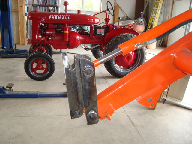

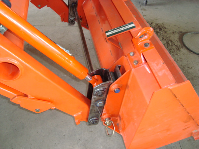

OK guys, I've been away from the computer for a couple of days so it looks like I got some catch up to do. Puckgrinder, yes, the pins are staggared to keep the bucket at the same level. I thought about using my press to form the cradle like you had stated but wasnt sure that I could do a good enough job. You will still need some sort of pipe for the lower forward pin mount. If you do yours that way, take some pictures for us, I might need to do this in the future as I plan to build another bucket. VTmaple, I had a piece of 1/4x2-1/2 flat bar that needed to be used somewhere and it worked out to be just the right size. I did my very best to built this thing so that the bucket was as close to the loader as possible and the 2-1/2 flat bar was perfect. Are ya getting the bug to build one for yourself? The pins? I believe that I paid like $12.00 each with the grab handles on them. I picked them up from our local Shiptons "Big R". I suppose a guy could just weld something on some regular pins if needed. Bukitcase, sounds like you have some boogers to take care of first before you can build a QA. Is the 580B a loader/backhoe ? or was it the 580C? I know what your saying about not being able to see the tips of the forks, its hard to do on mine as well, and then when I stand up to see, the engine quits because of the saftey switch in the seat. Im sure I missed a question somewhere so ask again if needed.

Chilly807, It looks like you have the same tractor that I have. I looked at tractors this size for 15 years before I could finally afford one. When I was looking at this one on the dealers lot, the thought of changing buckets didnt occur to me. I was given a set of forks some years ago and they were sitting it the "Roundtoit" pile. (was thinking for 3PH) It wasnt untill after I build the cradle for the forks that I realized what a PIA it was to un-pin and pin attachments when needed. I agree with you that the SSQA is the way to go and should had have gotten it at the time of purchase. Hind sight they say. I researched pretty heavy about building a SSQA style set up but the thought of the added (high) expence and the fact that I had to cut into a near new bucket didnt appeal to me. Then if you buy a different attachment, you have to buy another $129.00 adaptor if its not allready on it. There are some nice builds here on tractor bynet and else where, but it wasnt until I seen the video that puckgrinder posted here that made me build the "Pin" style QA. You hit the nail on the head with "How many attachments am I looking at ?" I used the forks pretty heavily when I had to replace the roofs here after a hail storm and also when replacing siding on the house and such. Now thats done and the bucket is back on and dont see a need for the forks in the near future, but its sitting there if I need it and only takes a minute to change it out.
I spent about $30 dollars for a short lenth of heavy wall pipe and $24.00 dollars for a pair of pins with grab handles. The rest was scrap steel that I had laying around. Even if you have to buy everthing that you need, it will still be under $100.00 bucks. You (or anyone else) will not be sorry to build one and I am very happy how mine turned out. I have a manure bucket off of an old Farmhand F-11 loader that Ill work over to use on the L3400DT and that is about all that I need for attachments that I can think of. OK, I may or may not have a use for a manure bucket but could use it for brush work? No? How about the fact that its there and I simply gotta do something with it. Yep, just something new to tinker on.
