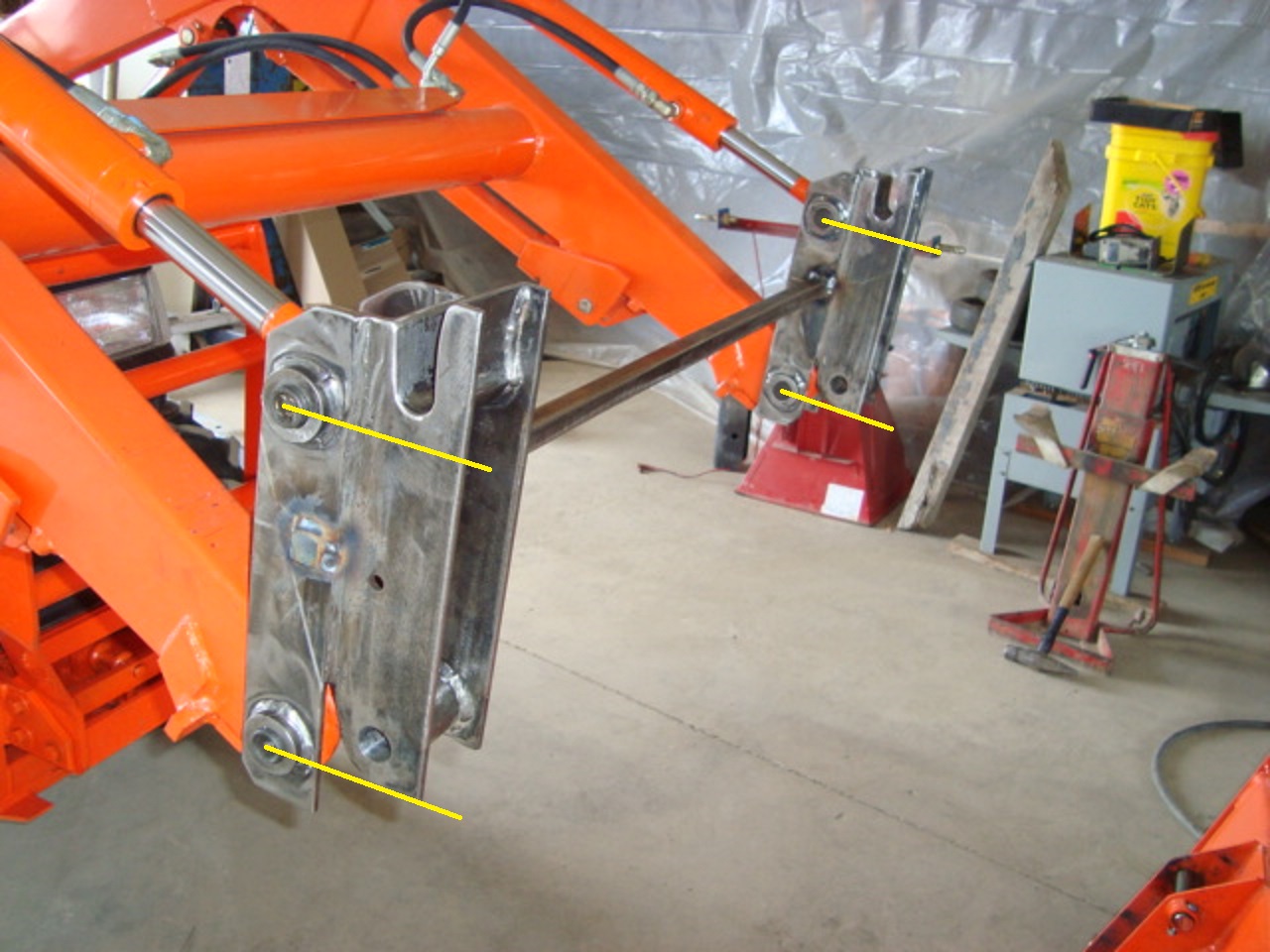

The one question I have that I really cant figure out is it looks like your pins from the tractor side are staggered lower by an inch or two from what the bucket side pins are, whats the reason behind that?
edit- I think i answered my own question but, you must want the pins in the same plane when the bucket is level on the ground and the loader pins are the same height as the bucket pins would be correct?
I might have been a bit foggy when I asked that question, reading back over it really isn't clear what I'm asking. On the bucket side of the adapter, the holes for the pins look to be raised about an inch or a little more in relation to the holes in the loader side of the adapter, at least they would be if the whole thing was vertical.
In the picture of Steve's adapter, I've drawn the yellow lines as close to right angles with the adapter as I can, the front set of holes is quite a bit higher. Mine should have the same angle on the bucket (same loader), so if his works fine, mine should too.
Sean

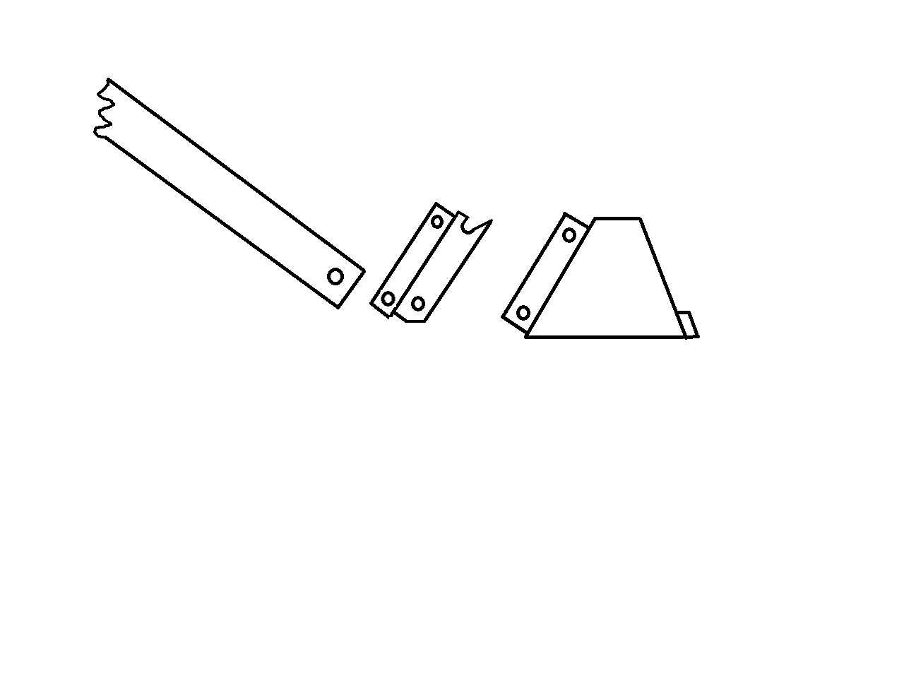

The goal is to make it so that when the bucket is level with the ground, the holes on the QA adapter are also parallel with the ground, so as to avoid changing the bucket's orientation relative to the loader arms. I think the easiest way to accomplish this would be to tack up the two halves separately, then install the front half in the bucket, with the bucket off the tractor, then tack the back half on such that the holes are level.
/ Homemade quick attach #215
I see what you're saying, that way you keep the amount of curl and dump pretty much the same, as well as the bucket height in relation to the holes in the end of the loader arms.
So, it would look like this if everything were level and flat.
Sean
/ Homemade quick attach #216
Yes, exactly. At least that's how it seems to me--bear in mind, I never finished building mine! But it makes sense that you would want to keep the relationship between the lift arms and the bucket the same. The bucket should be pushed outwards an extra few inches, but its orientation shouldn't change when pinned on vs. when QA'ed. Some clever person could work out the math (tangents and such), but I tend to make mistakes or overlook things, when I try to do it that way, so I would just take off the bucket and tack it up in situ.
