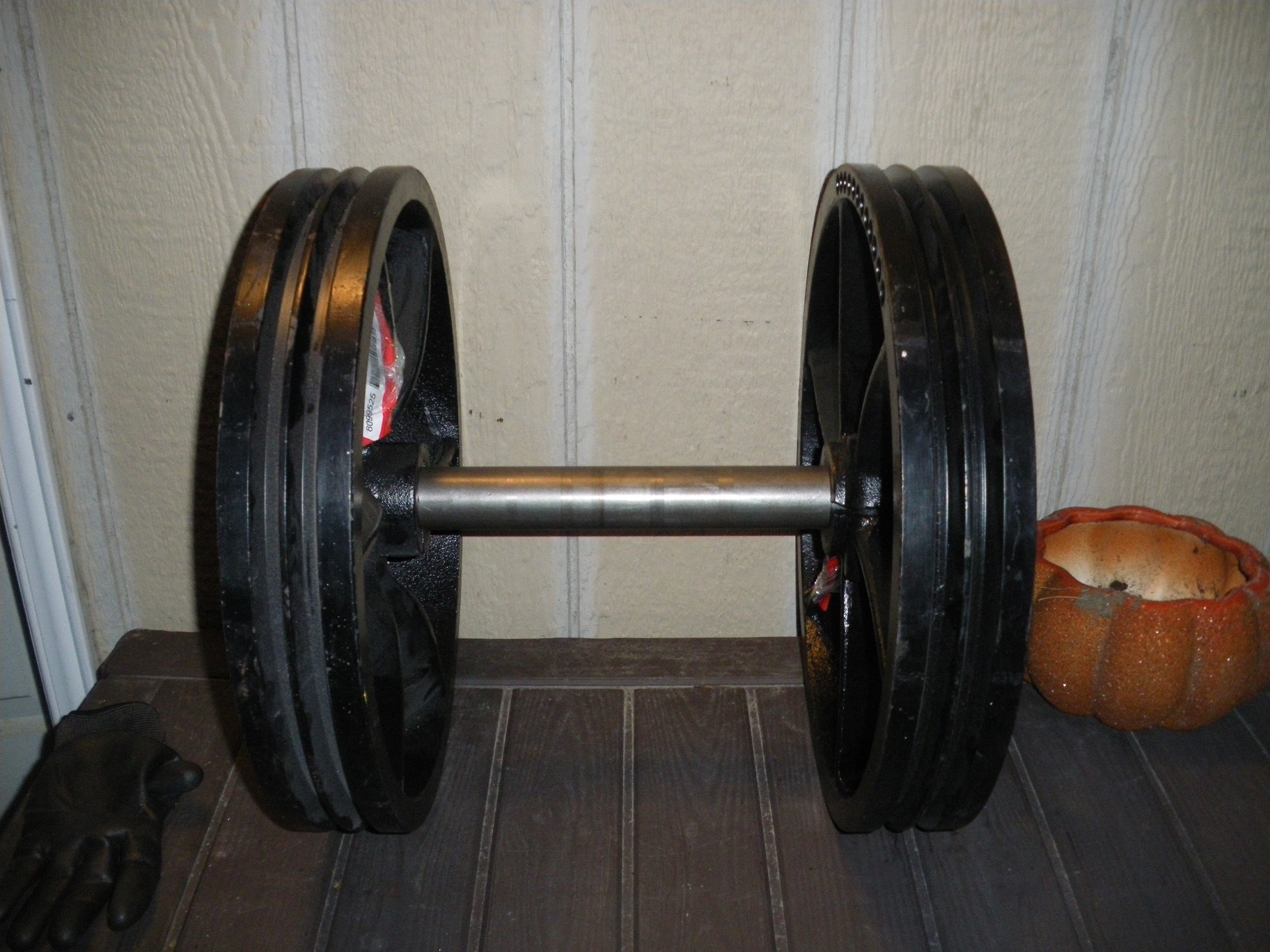

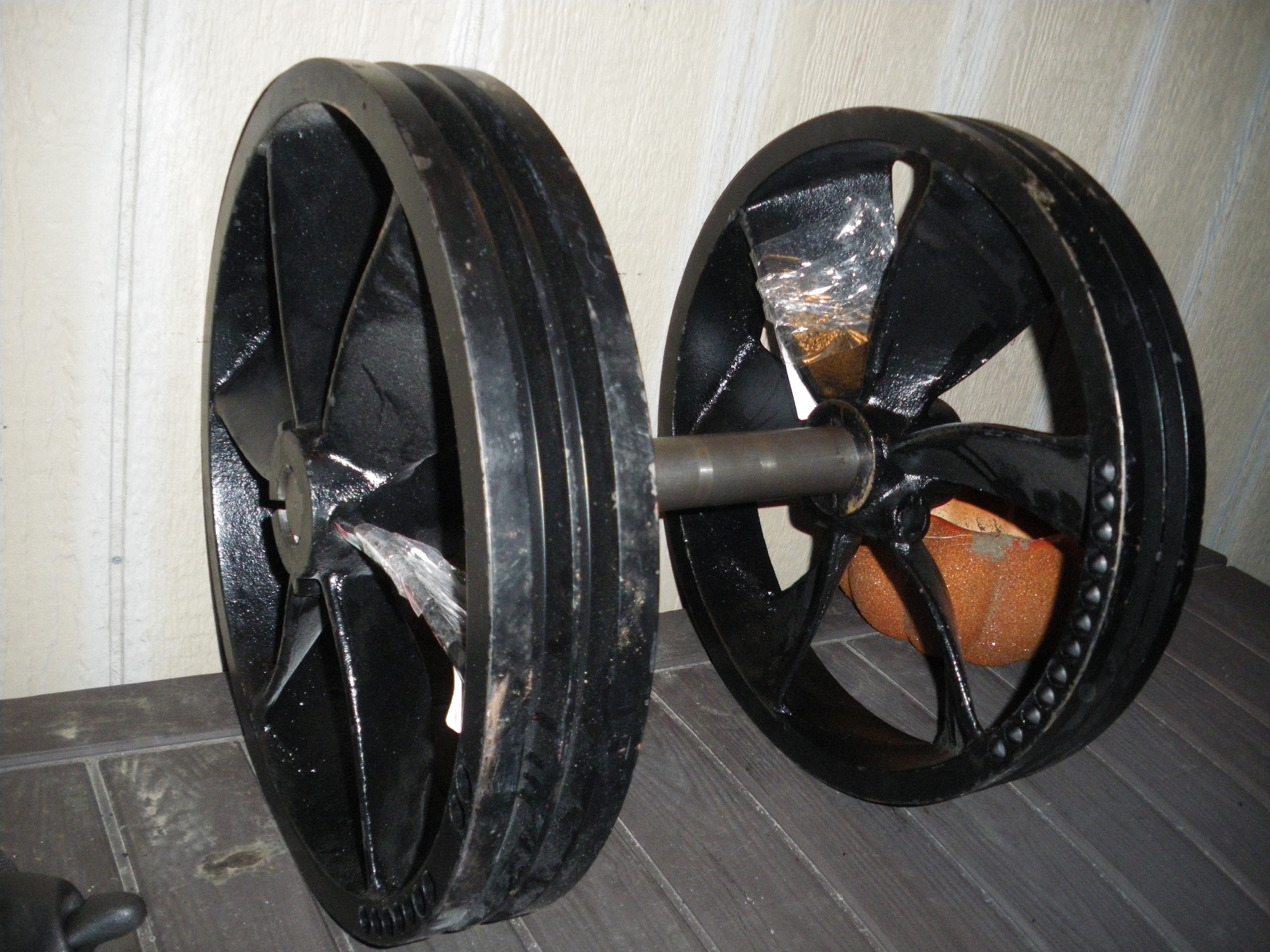

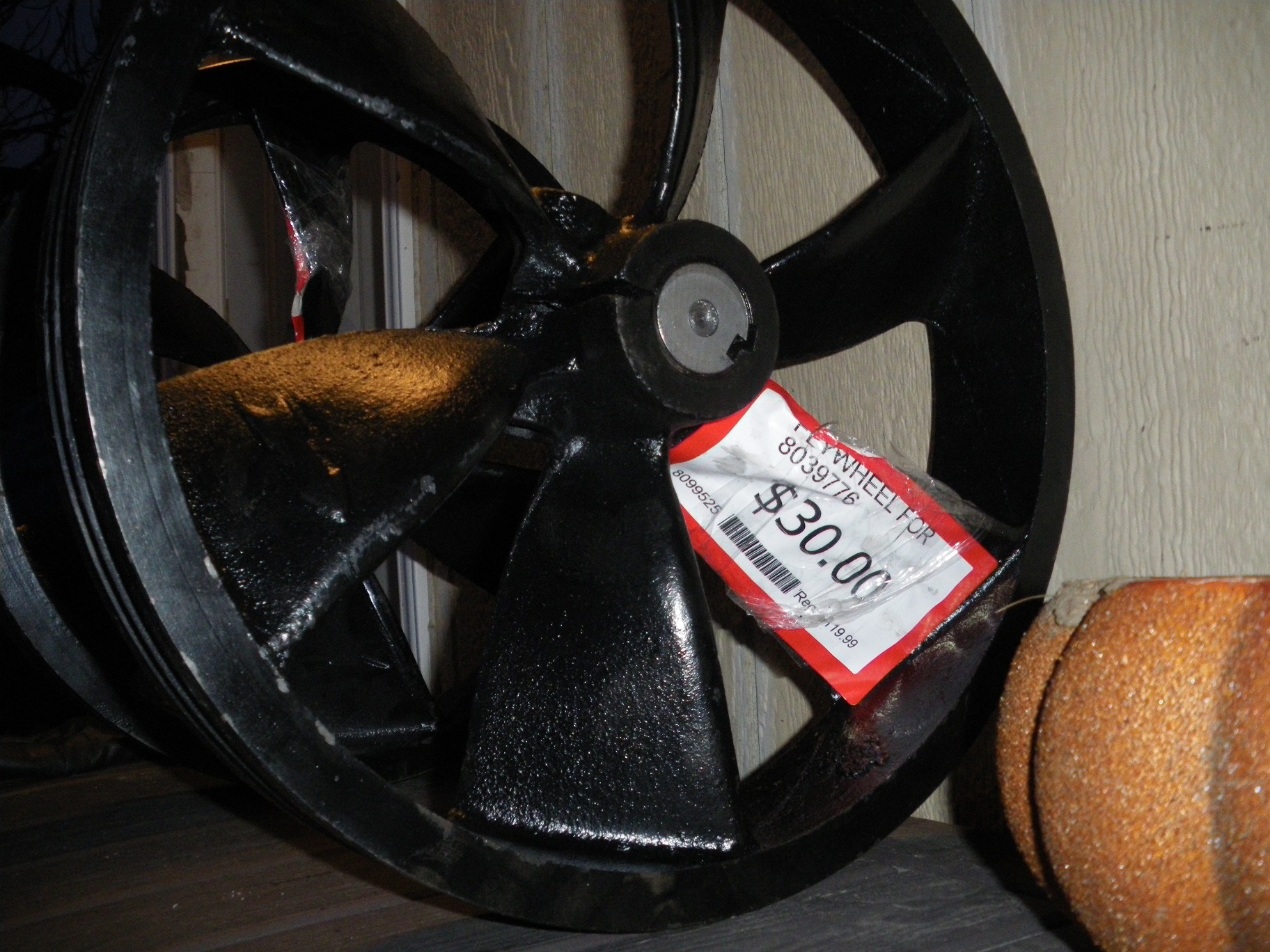

In 2013 I found a clean gravel seam on my land. In 2014 I built a gravel screener to remove the larger rocks (greater than an inch). So a few weeks ago when I found a large cast Iron air compressor flywheel I started thinking about building a rock crusher. Luck would be that I found a second flywheel also marked down at 75% off. So I bought a piece of 1.625 inch Rod and a couple of 1 inch thick chunks of hardened steel. I plan to cut grooves into the plate, run a bead of weld and fashion some teeth. Next on my list is a set of 1 1/2 inch pillow block bearings and see if I can get a set of 2.5 in pillow blocks for a reasonable price. It will take a month to come together if I can stay focused. I am looking at a 4inch x 5 inch wide jaw. Flywheels are 17 inch cast Iron. I am into it for $265 which includes a new 6.5 Hp gas engine and hope to keep it under $500,

Since the Flywheels are also fans I am not sure how much air they will push at 250 RPM so I will set them up to push dust outwards from the crusher.

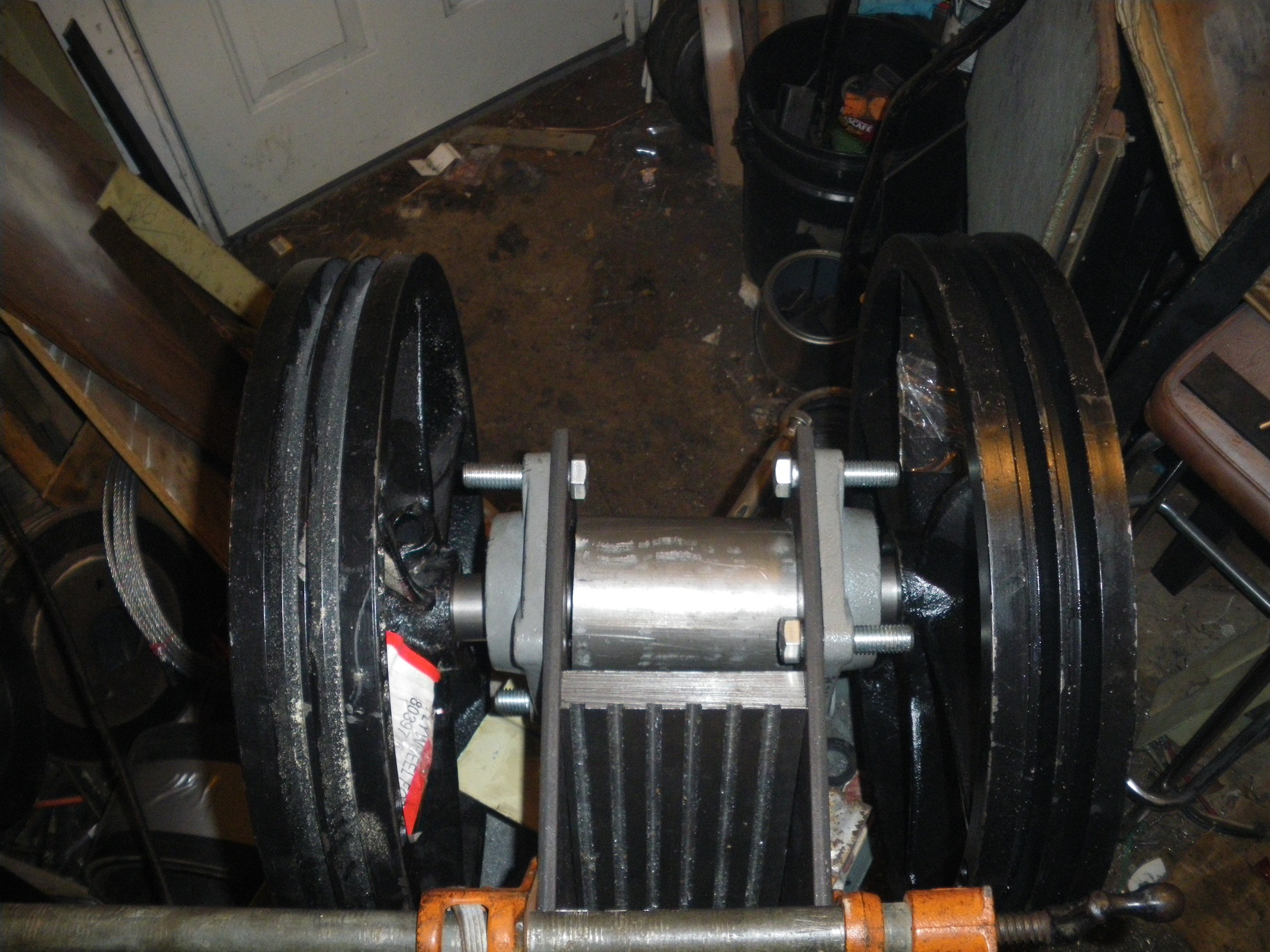

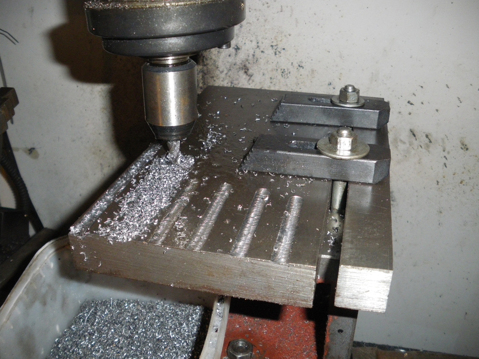

Eager to mock up the pieces I have cut so far. Lots of welding on the teeth, ends and much bracing to weld on. Flywheels are 17 inch. Jaws 4x5, bolts are 5/8"

How are you making the offset in the crankshaft to move the jaw?

The shaft is 1 5/8 inch. I am going to weld a 3/8 chunk of steel on one side of the shaft and build up a lobe to match a set of 2 inch inside diameter bearings. I am looking at between 1/2 and 3/4 inch stroke. That is unless I can think of a better way.

Ah - so glacial till. That's the stuff that's left from the mountain that the glacier didn't finish pulverizing. Learn to recognize quartzite and try to wash the stuff before crushing, then pull all the bigger quartzite cobbles you can out of the input stream. It's very hard, tough rock and really has no grain to help initiate fracturing. Anything with a good grain structure should crush up nicely. Looks like you're making the jaws nice and heavy - maybe think about reinforcing the sides with ribs or similar as they may be taking some high wedging forces from the fragments as they break up - maybe not.
A rock crusher operating at 300rpm is a high fatigue machine. 300 strain cycles per minute is 18.000 per hour, is 18 million in 1000 operating hours. Welding reduces the fatigue life quite a bit, so IF you weld in the middle of that jaw plate, it has to be a substantial reinforcement or the fatigue life only decreases...
The fatigue of welded joints is the reason many crushers are cast steel: No welding joints :)
/ Homemade Jaw Crusher.
#19
The Jaw plates will have weld beads along each ridge and ground into some form of a point. The jaw plates will be bolted to 3/8 reinforced plate so that I can remove them and reweld as required. This is a 110Volt welder project which limits the size of steel I am using. It may work, or it may self destruct with the first rock I put in it. As far as the rock, some of the rock has lines in it looking like tree rings, hopefully that means I will get some good results.
