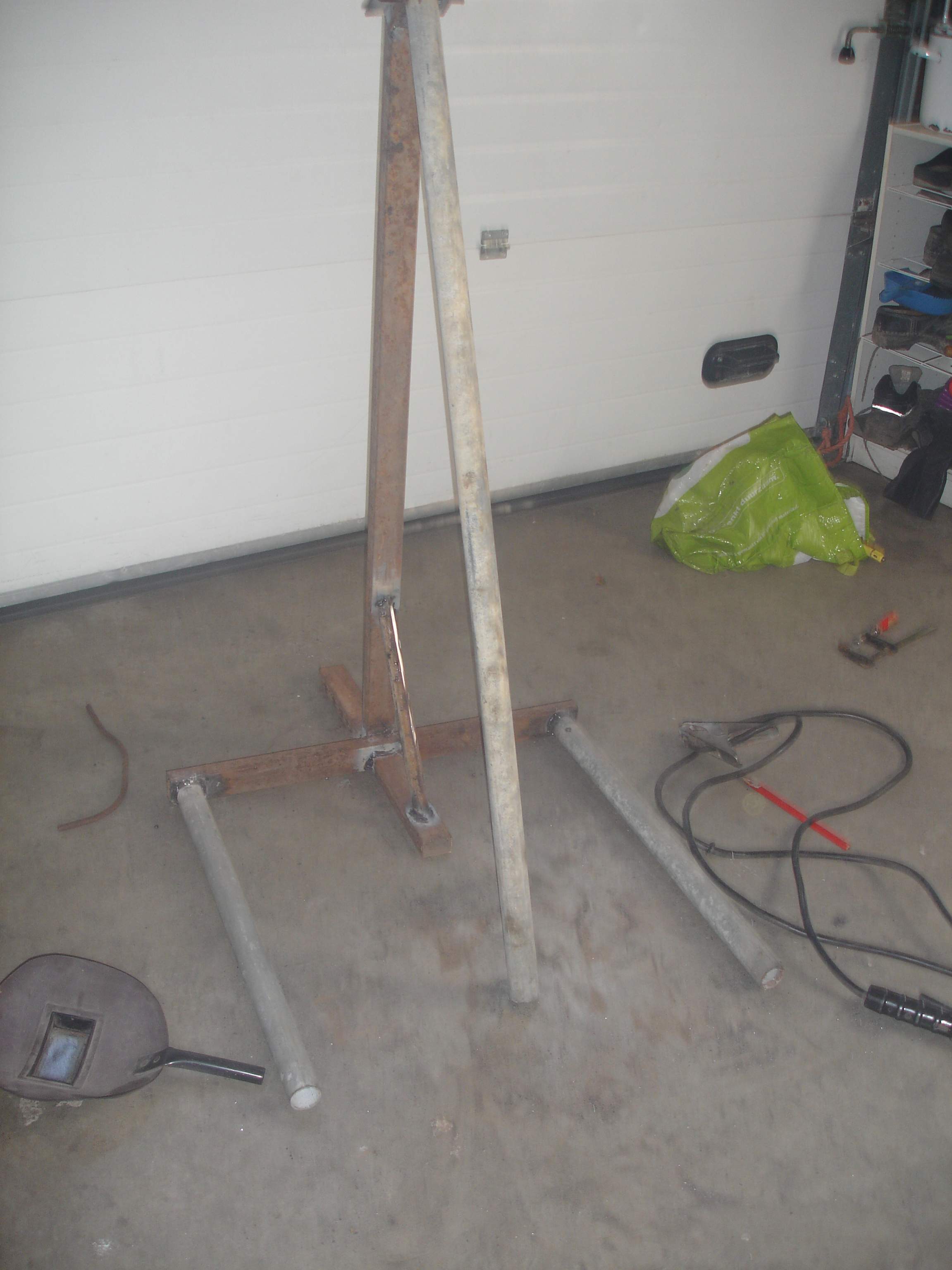

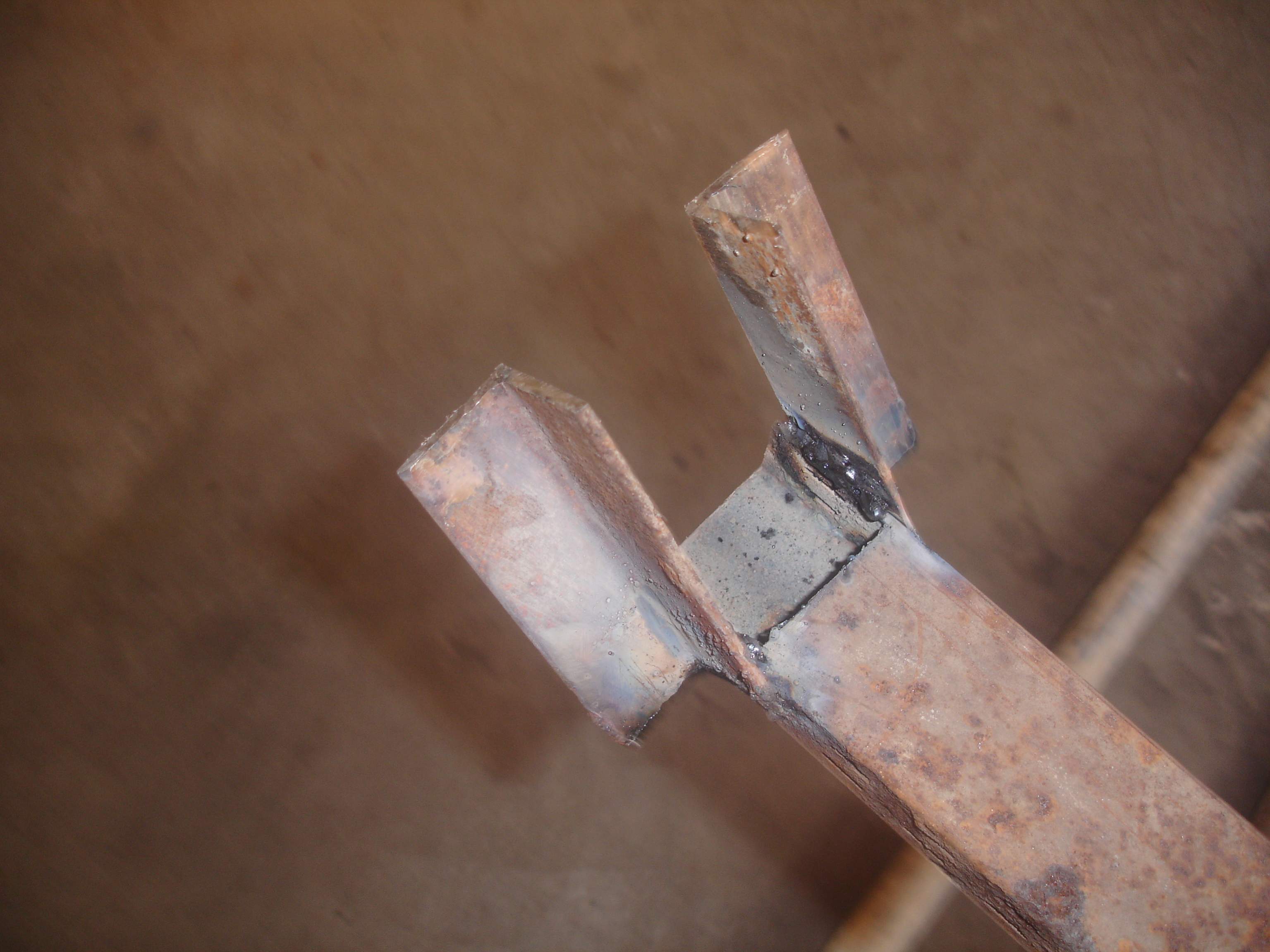

first of all i wanna say hello.
my name is Sander and im 14 years old and live in holland.

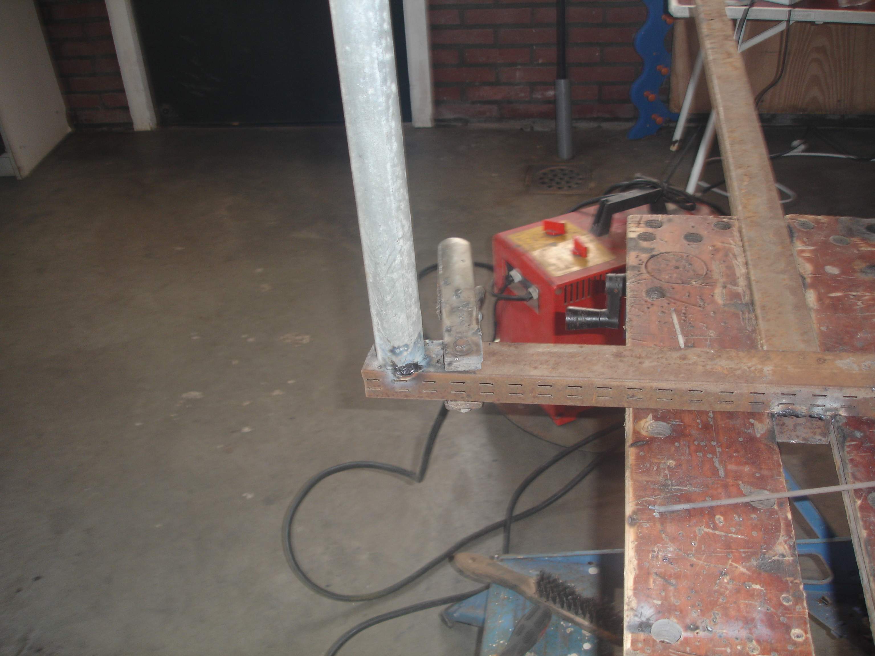

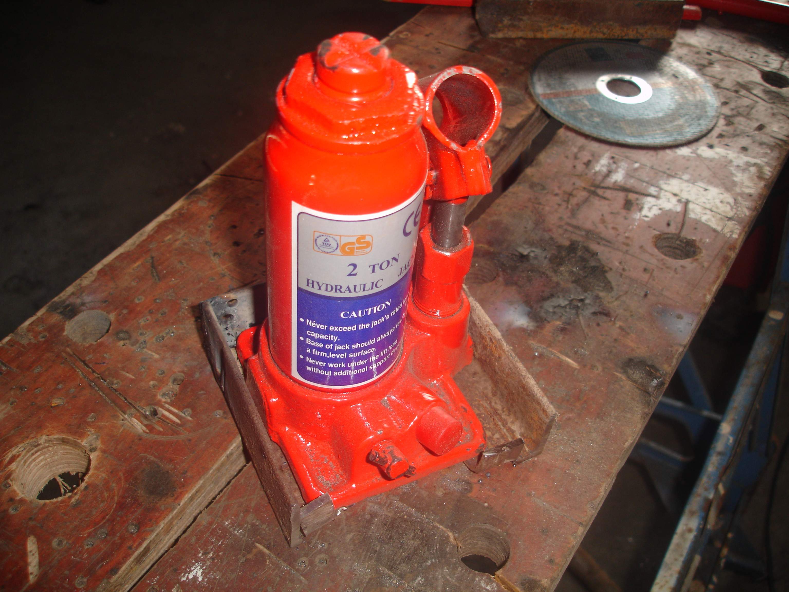

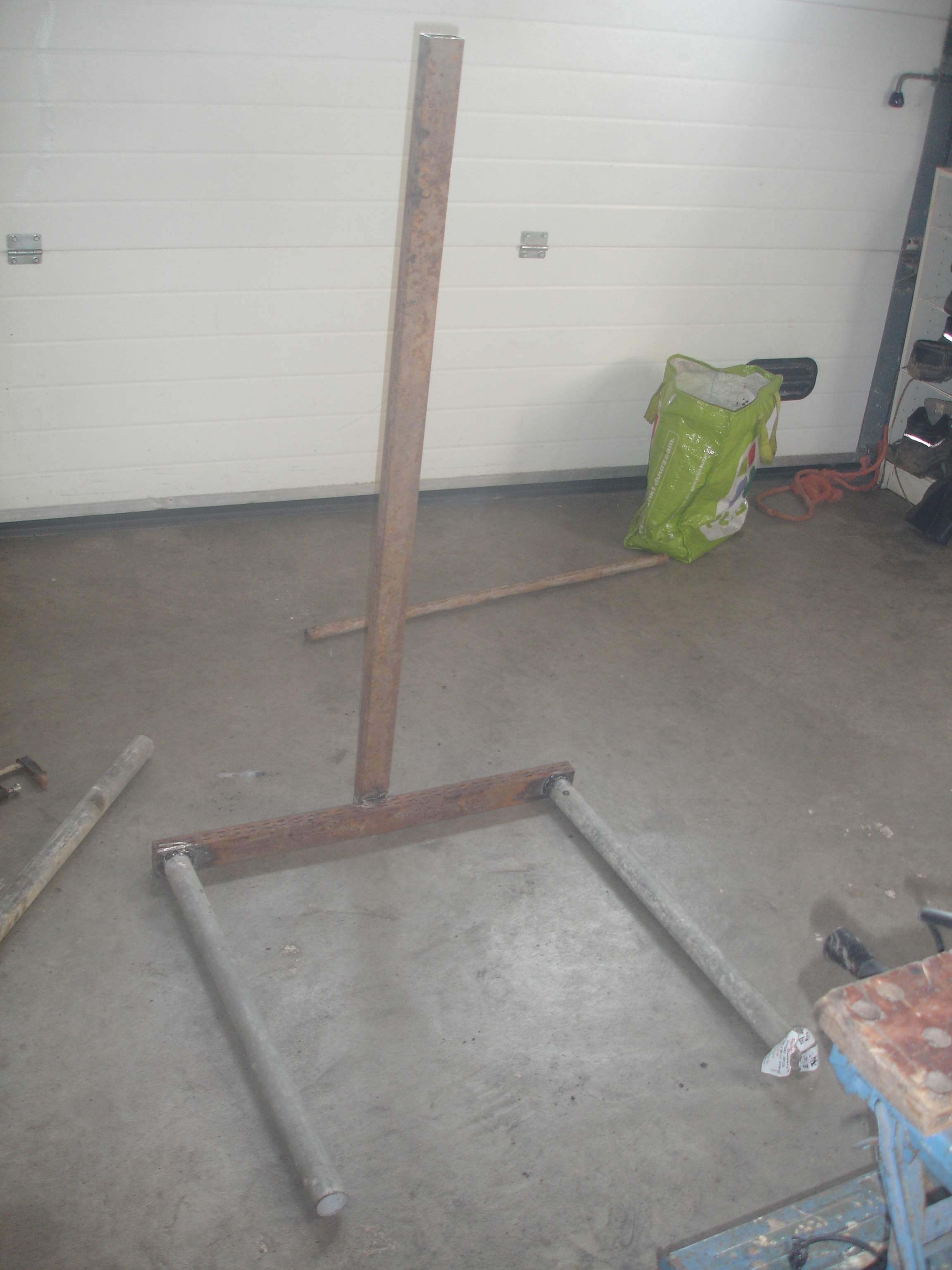

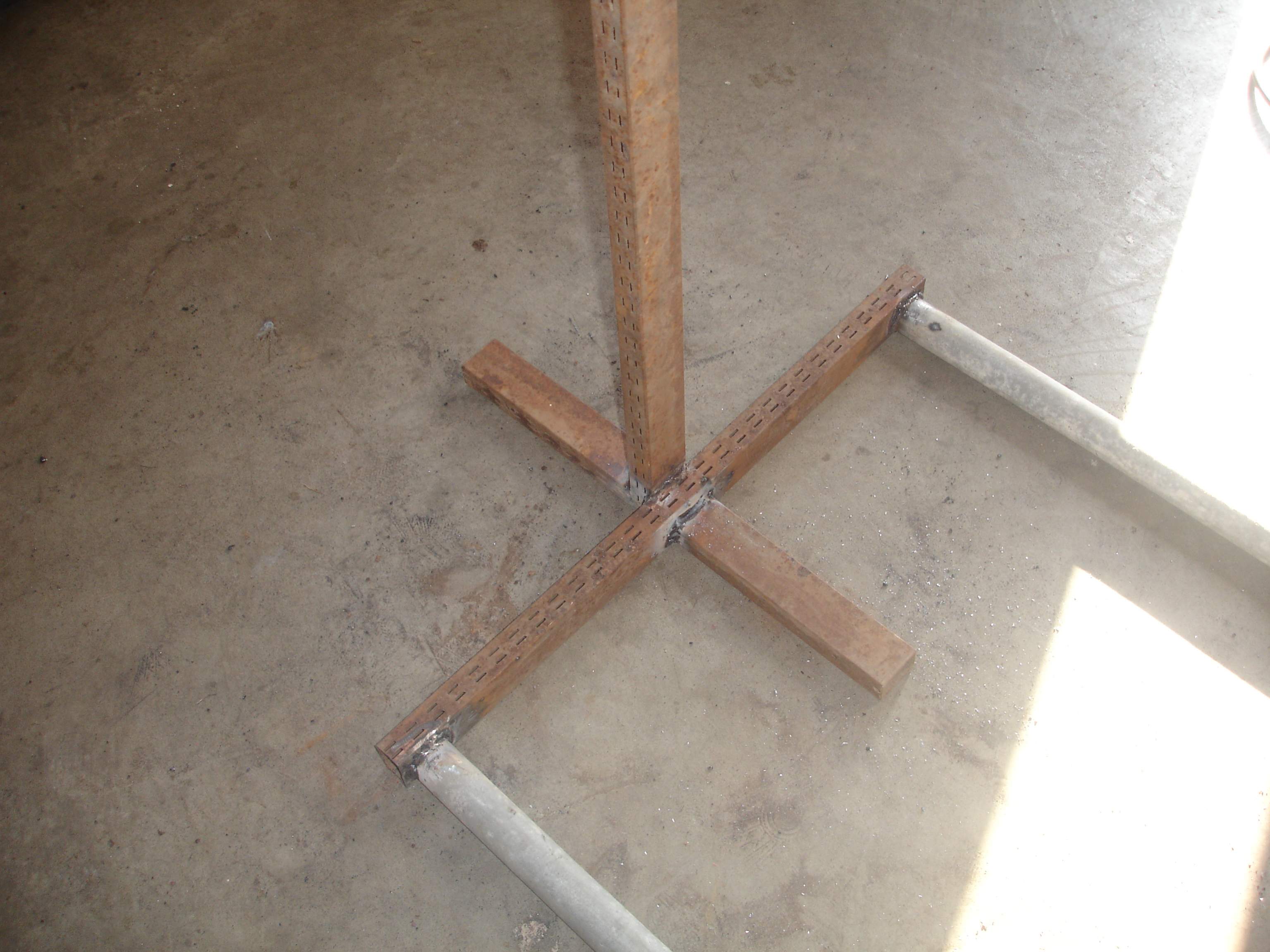

this is the homemade engine/lawnmower lift im making.

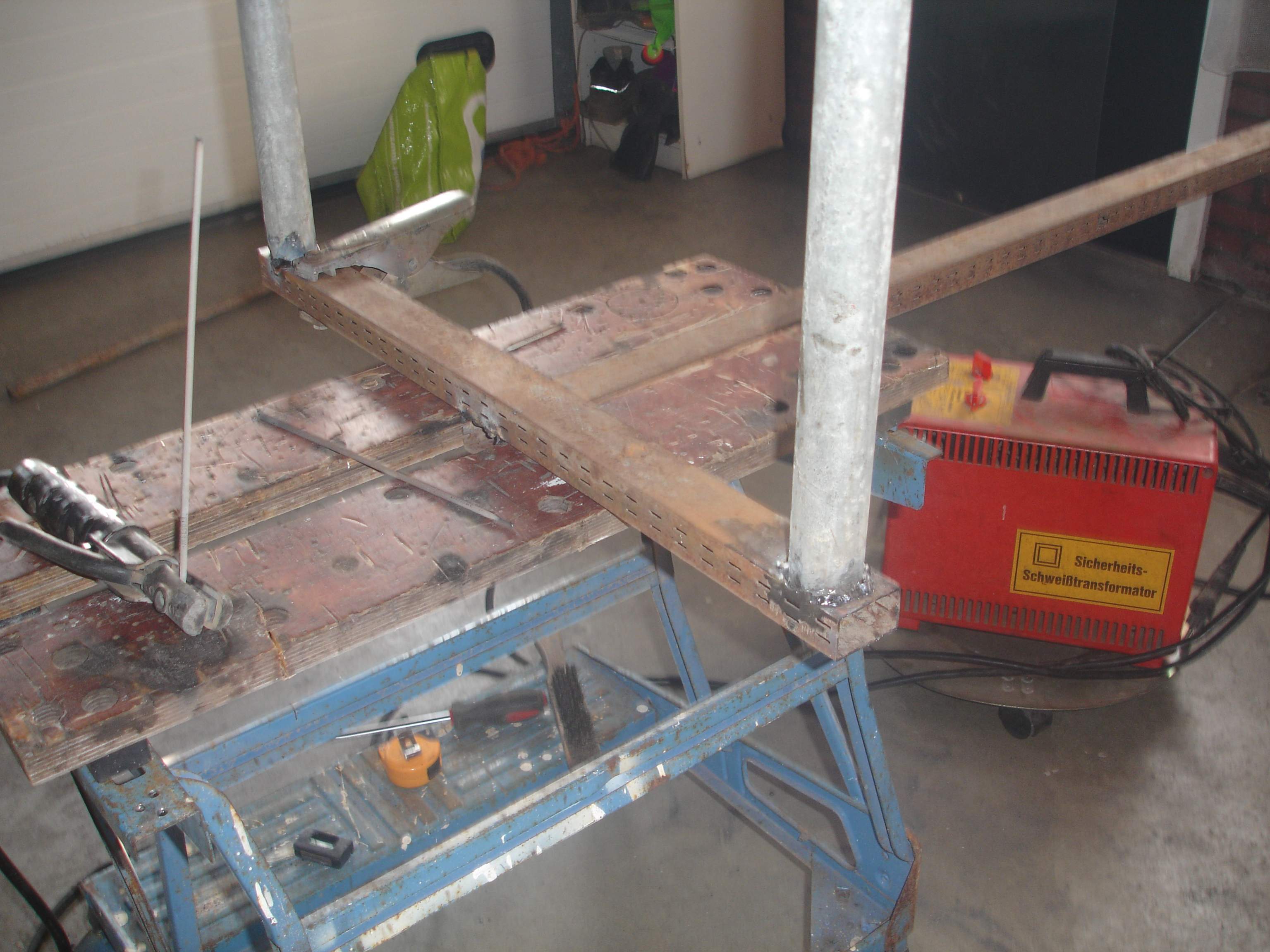

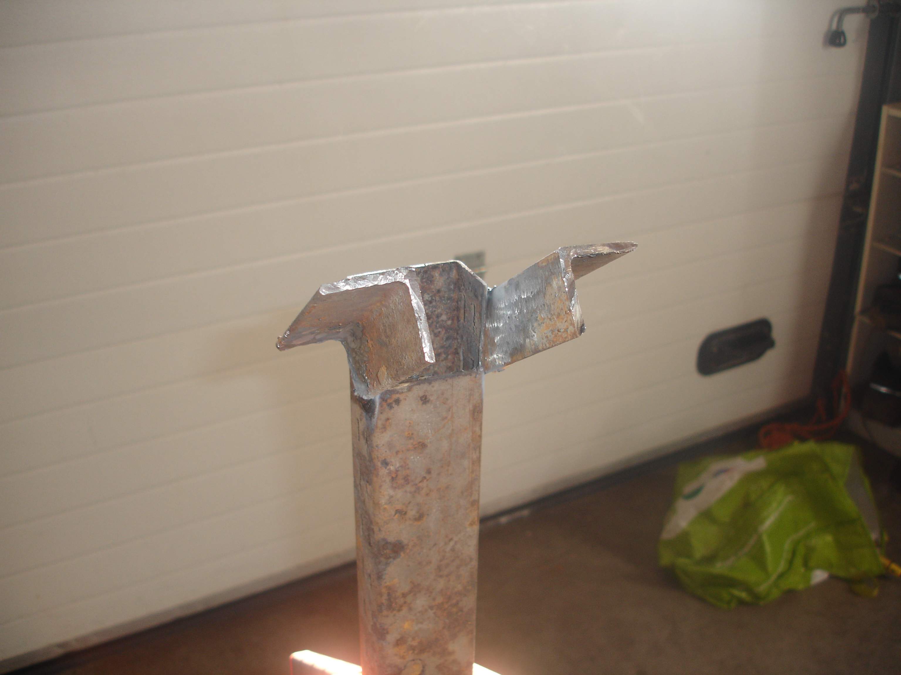

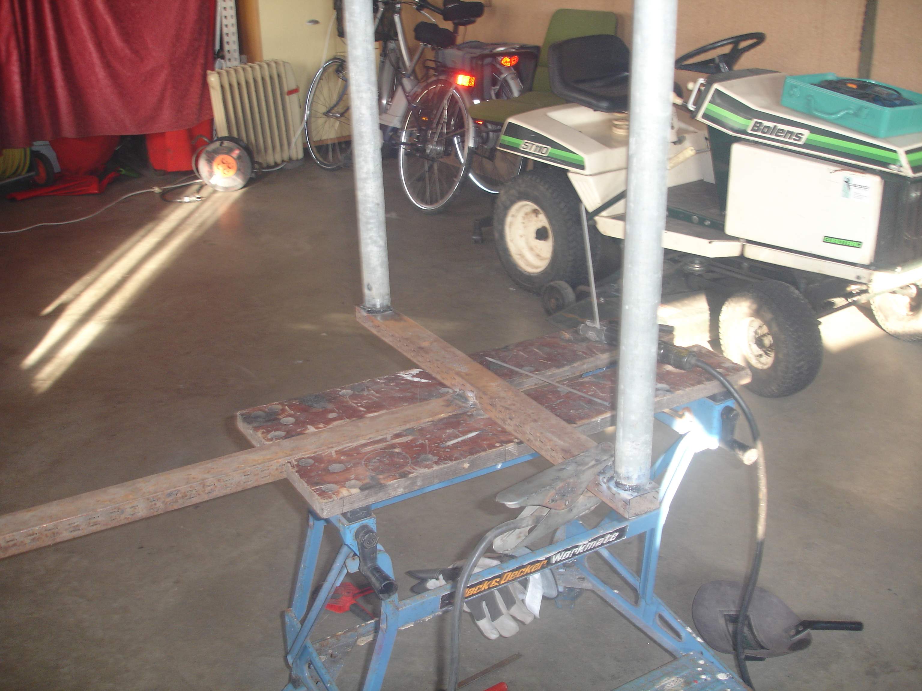

i am going to use it for lifting te front end up of my lawnmower so i can clean the deck en sharpen the blades without having to get the deck off.
so far the build is coming along pretty good. the only problem i ran into is mounting the bottle jack. it doesn't stay in place when the boom rests on it.
so my questin is. Can i weld or drill holes in the the bottle jack?

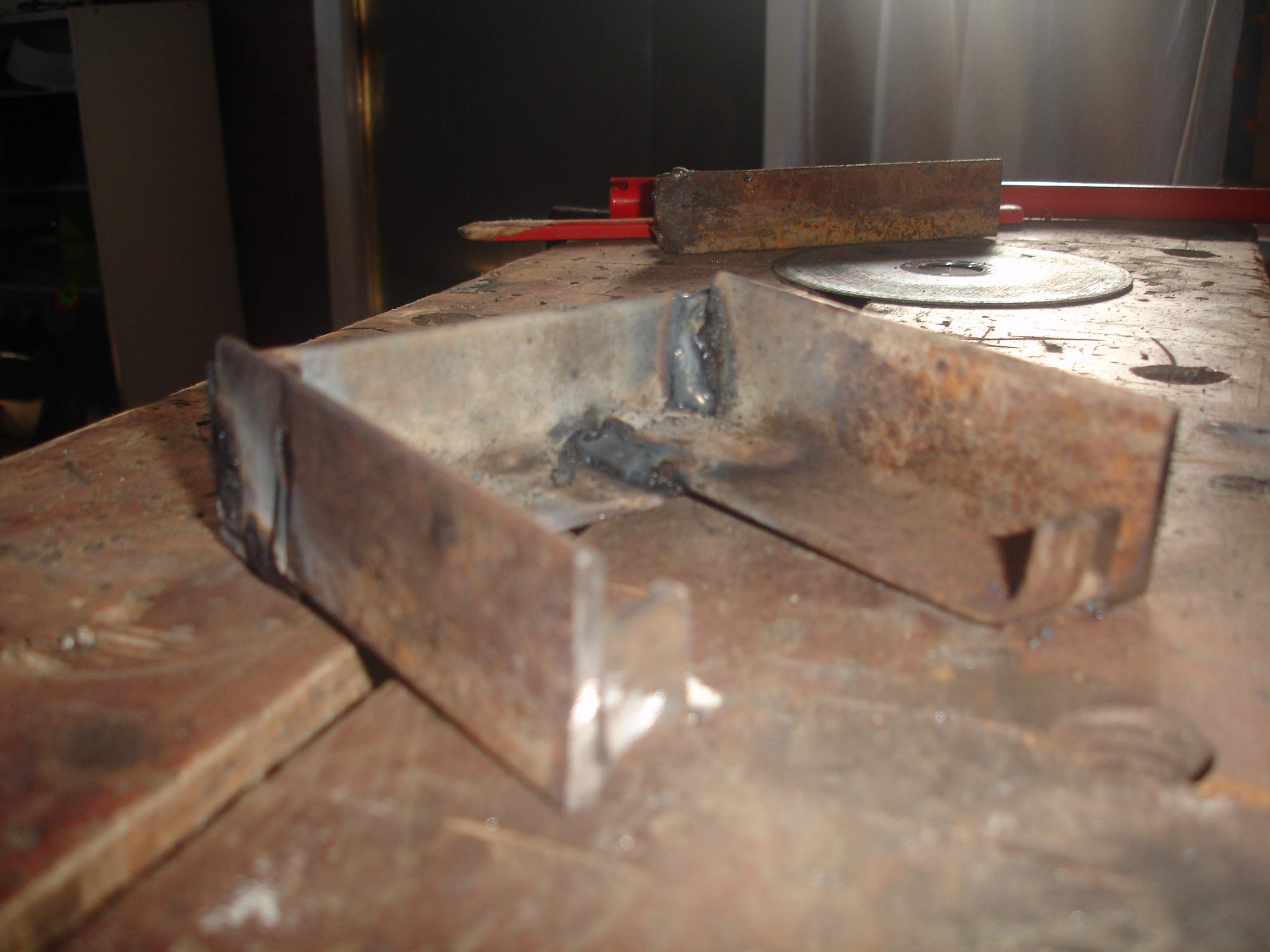

can i drill holes in the area of the black dots in this picture?DSC08664 drill dots.jpg
/ Homemade engine/lawnmower lift. #3
I have a similar jack on my store bought bike lift. They fabricated at cradle for it to sit in and had it clamped in place. Works well and solid.
You might be careful where you drill as there my be fluid passages in that area.

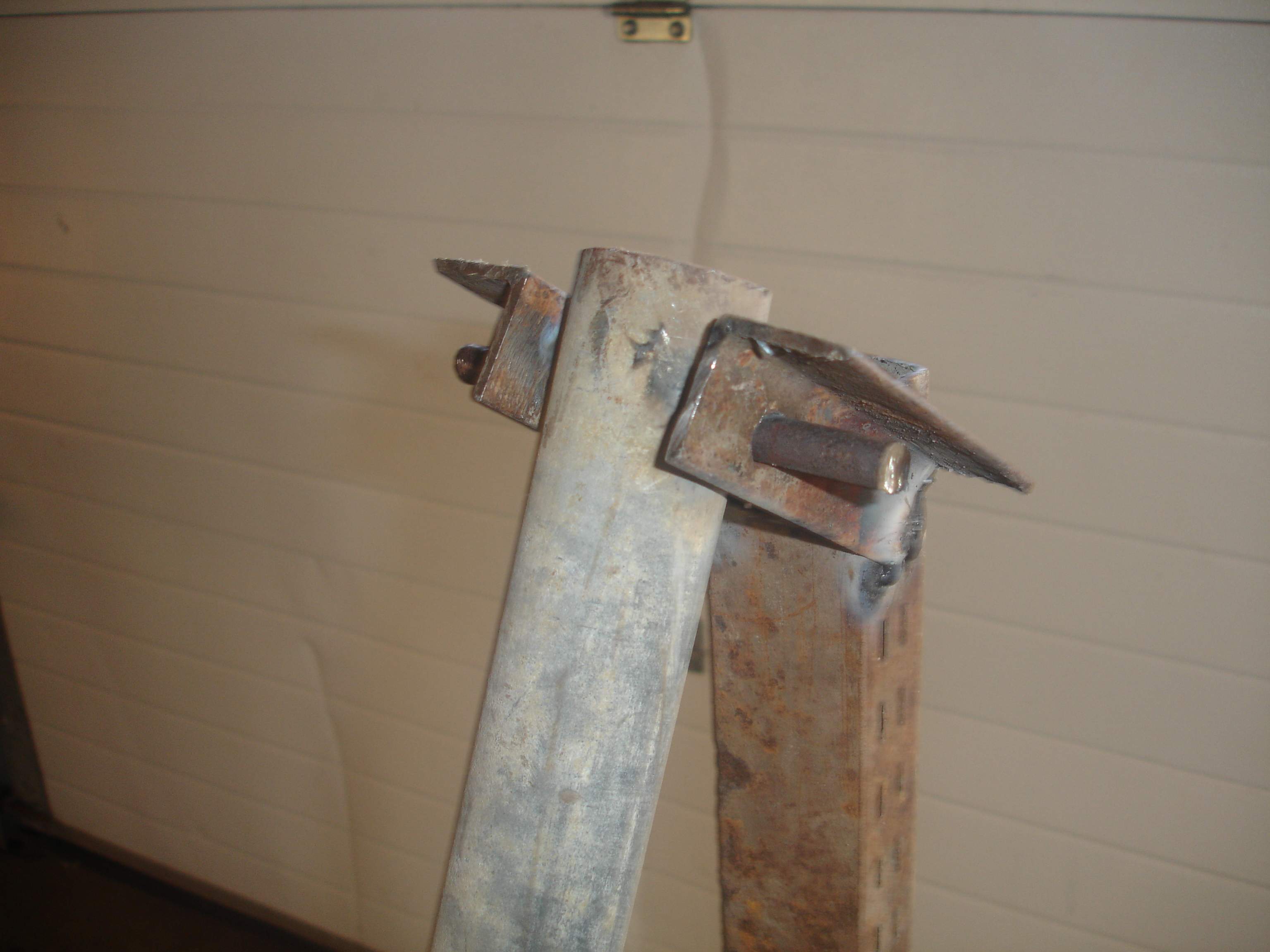

I made a lift out of a tall hydraulic jack and was before I found a place to buy with the clevis under the jack,
I made a mount out of a flat piece of steel and welded on the edges two small angle irons strips that would hold the jack, on the sides, not sure with out looking but I am guessing there is a bolt that can be removed from the base to keep in place on the out edge (not the jack) but the base,
It has worked now for about 20 years,
a friend made a smiular lift and did not make the base pivoit, and the stess caused the jack to leak at the base, ,

/ Homemade engine/lawnmower lift. #9

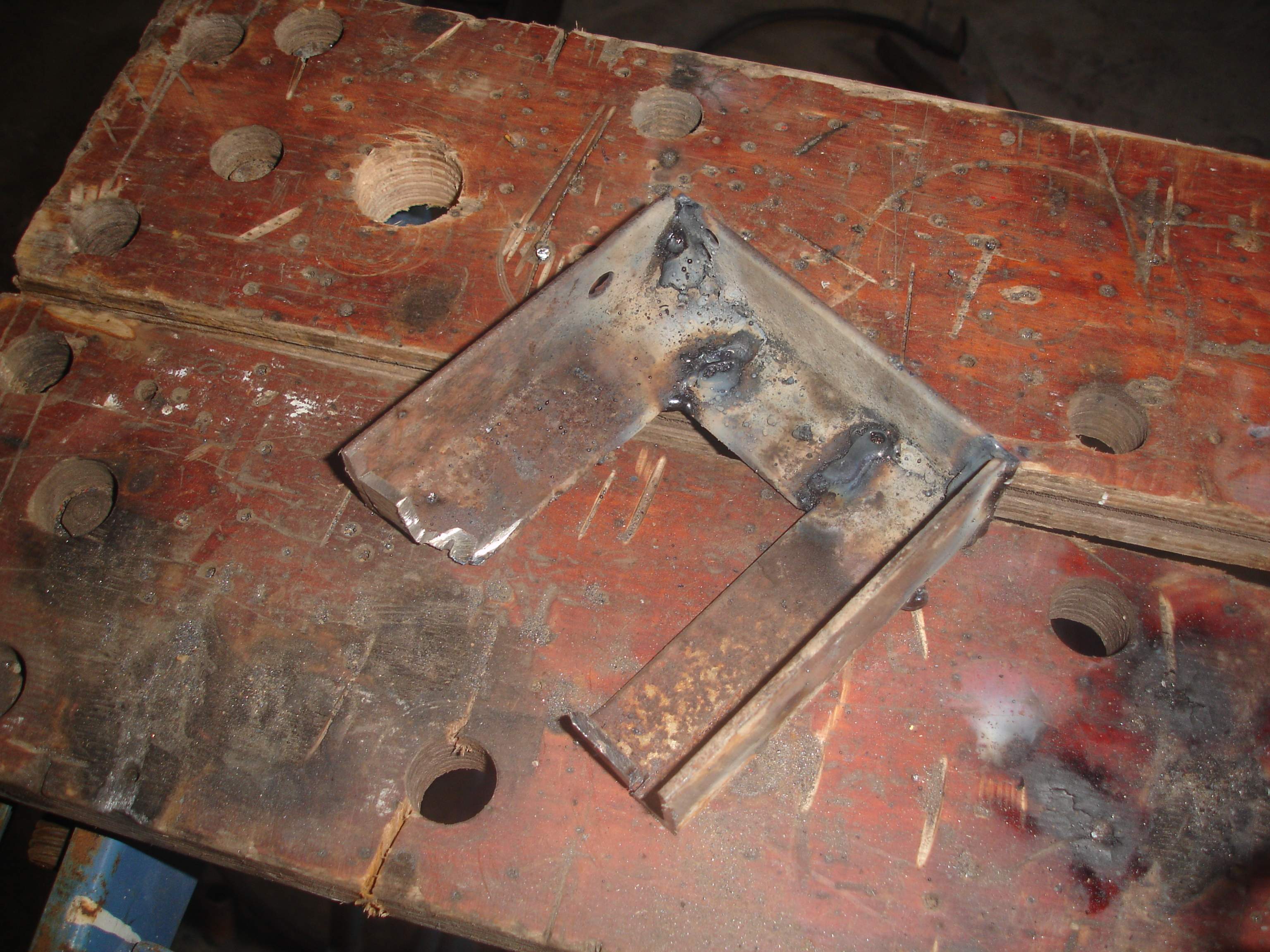

When I went to college and I was taking welding I wanted to build a drill press. My welding was good enough to pass fillets welds with 7014. I built the column from 2" steel pipe and the drill platform from 2" angle iron. The clamping means for the platform was poorly designed by me. One of the instructors was a calm man from Norway and he said my clamp did not really look PROPER. He was right it was a bad design by me. One of the other instructors said I will show you how to make a pipe clamp from pipe. He welded for me 2 pieces of 1/4" plate on the pipe and my eyes lite up because it was just perfect for my needs. I machined the quill and mounted an electric motor and I used the drill press for a number of years.
On your stand design you might take the advice the instructor from Norway gave me, it could use some help to make sure it does not break.
I did not see a 4 1/2" mini grinder in your pictures as these are great tools for fixing a weld that was cold.
On the bottle jack you might design a hold down clamp for each corner as it is only a 2 Ton jack.
My neighbour is from Holland and he has been welding for many years and he is now 77 years old. I know he will be in the shop working at the time of this writing or I could give you a saying in Dutch.
As the others stated work safe and maybe get some advice from an experinced adult.
If your design does not work at first just get the mini grinder. As time goes on your projects will become bigger and safer.

That jack is cast iron and as such quite brittle. Any shocks or side loads would probably result in broken corners.
I'd suggest you consider some sort of clamping arrangement instead.
Are you sure? it looks like harbor freight so I think it got that cheap pot metal so either you can drill it or its just gonna break once its drilled out. you will know your answer when you drill the first one out.
If you are handy with a welder and can use one, I'd run a bead on the outside of that base and see how it reacts. If the metal shrivels and beads up, I'd venture a guess its a crappy piece of metal and shouldn't be messed with drilling nor welding.

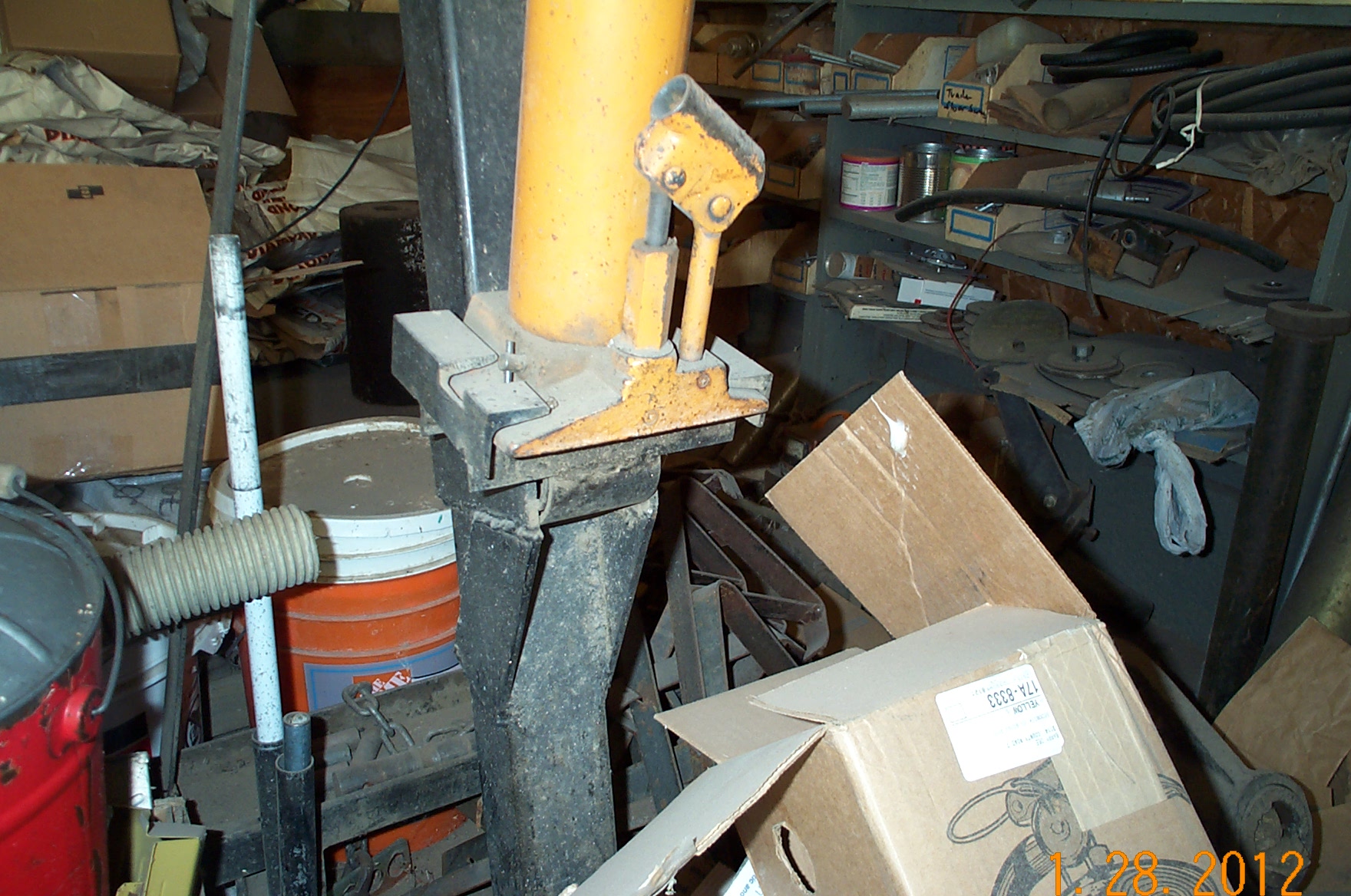

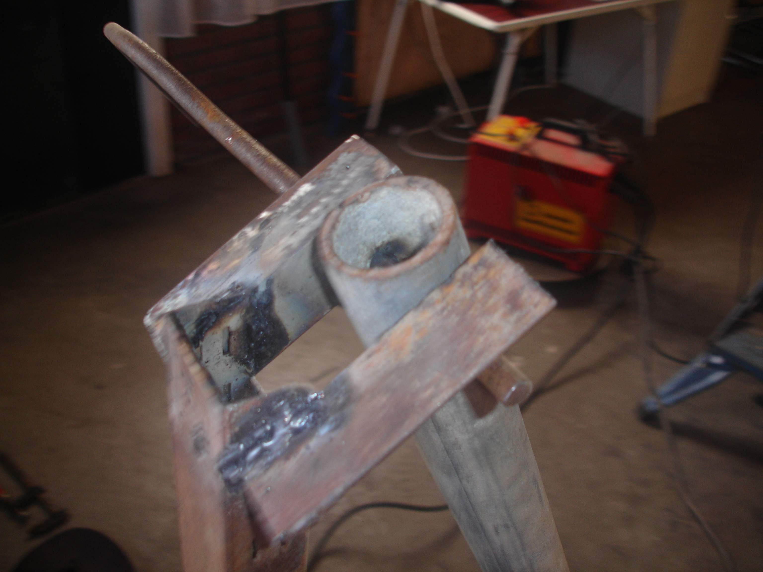

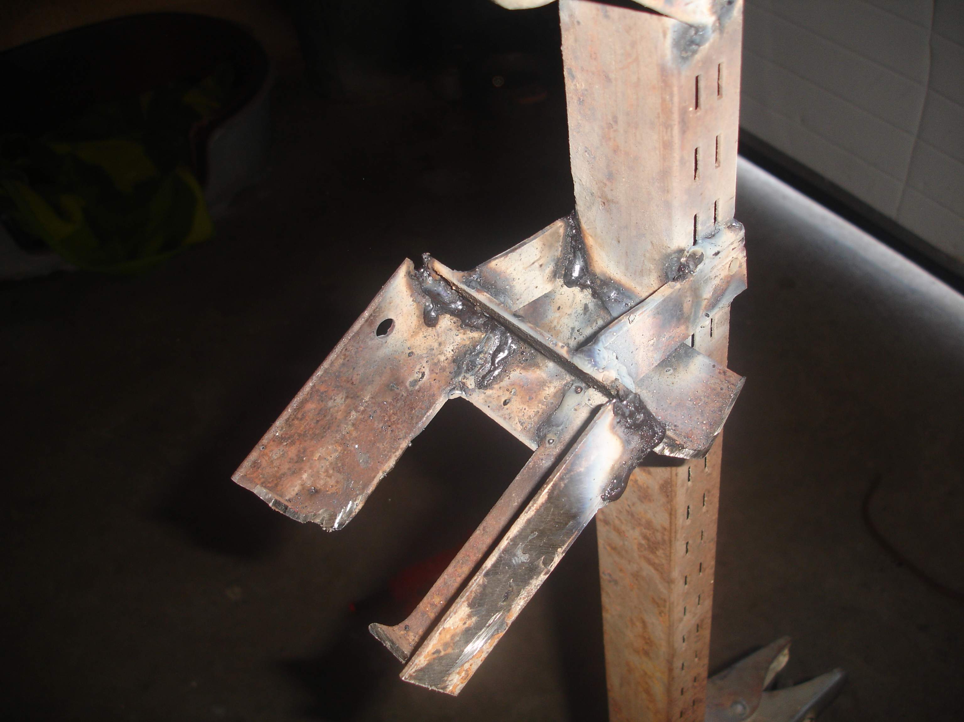

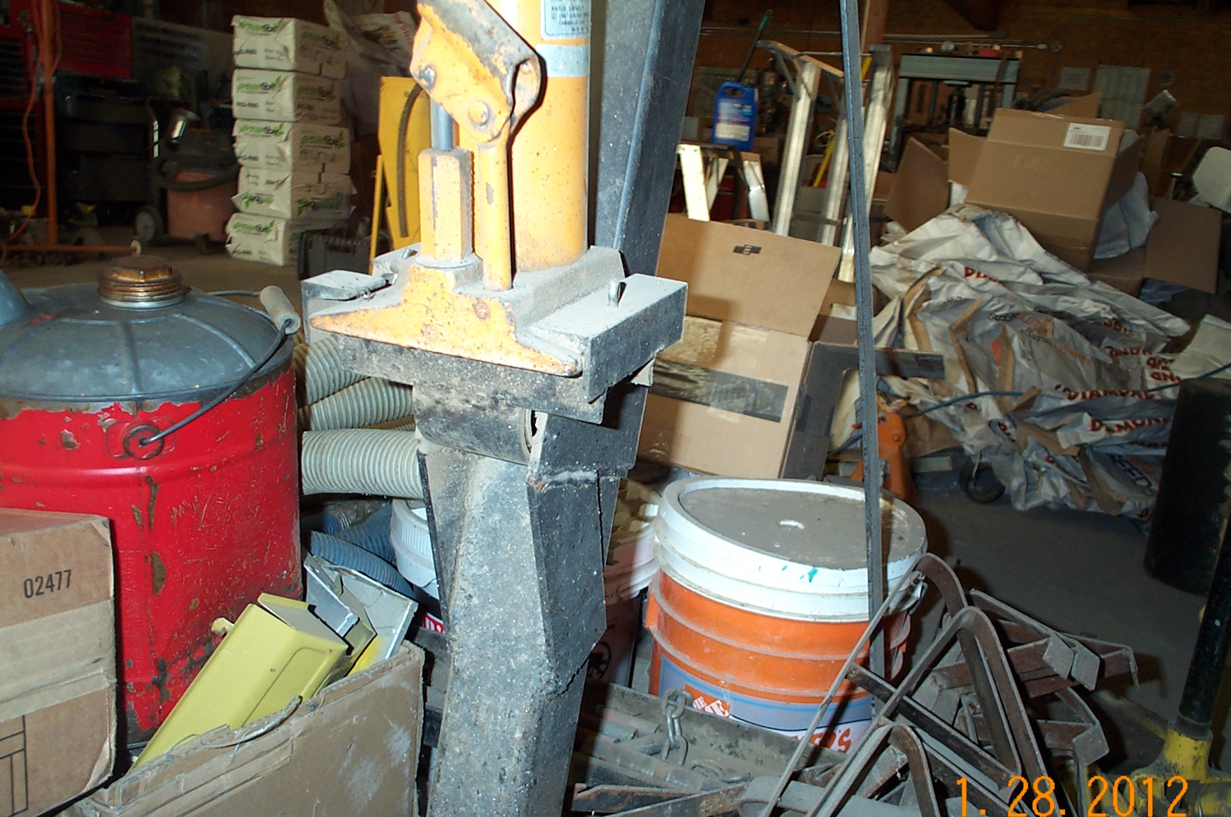

Here is the picture of the jack pivot I made on the old engine hoist about 30 years ago, I had very little to work with so that is why the pivot is made with two pipe sections, (it works amazing well), and you can see the angle clamps on it, on the one side you can see the cotter key I use to hold it in place. (I would think the same type of idea would work for you as well),

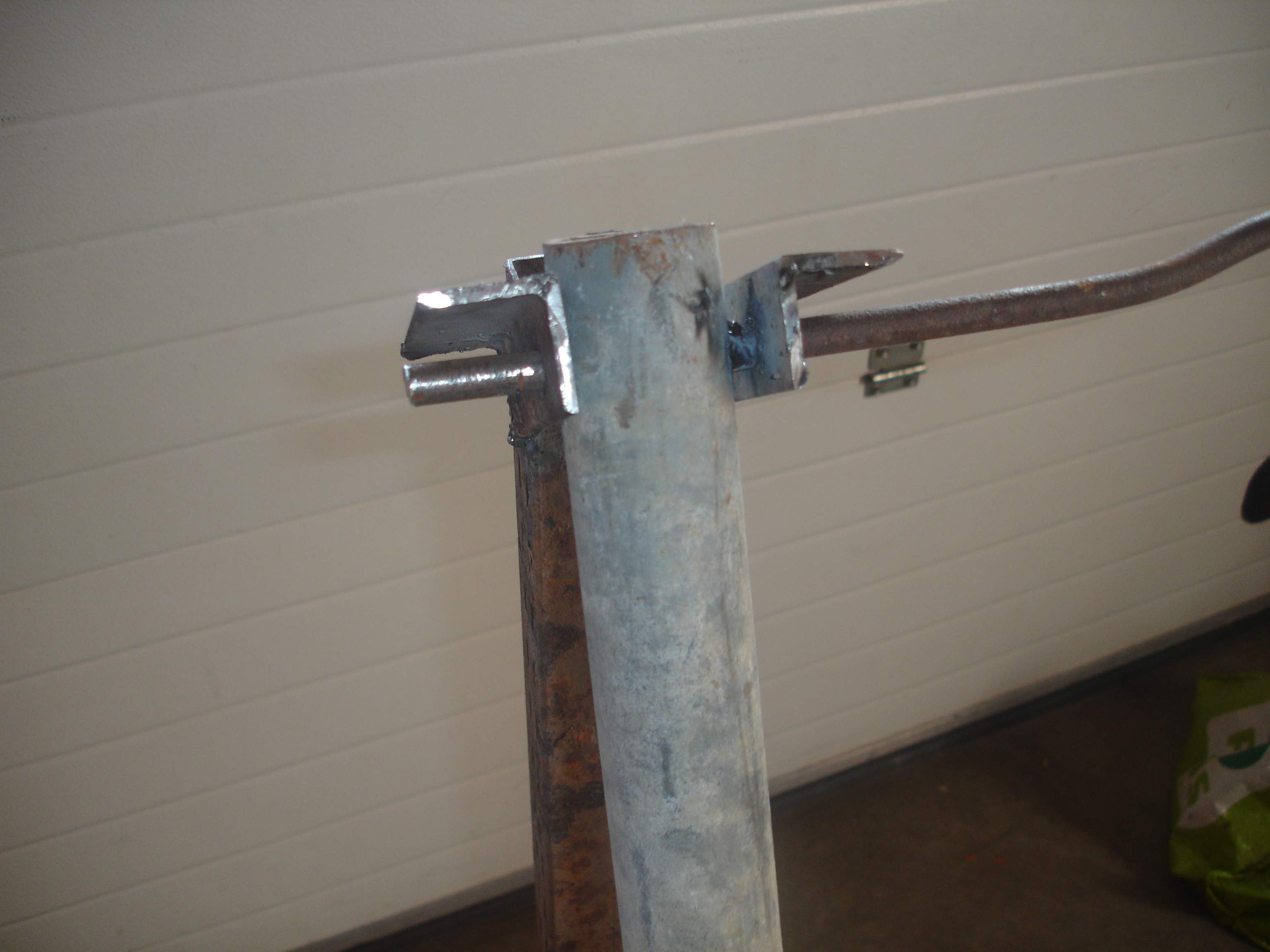

Hello guys.

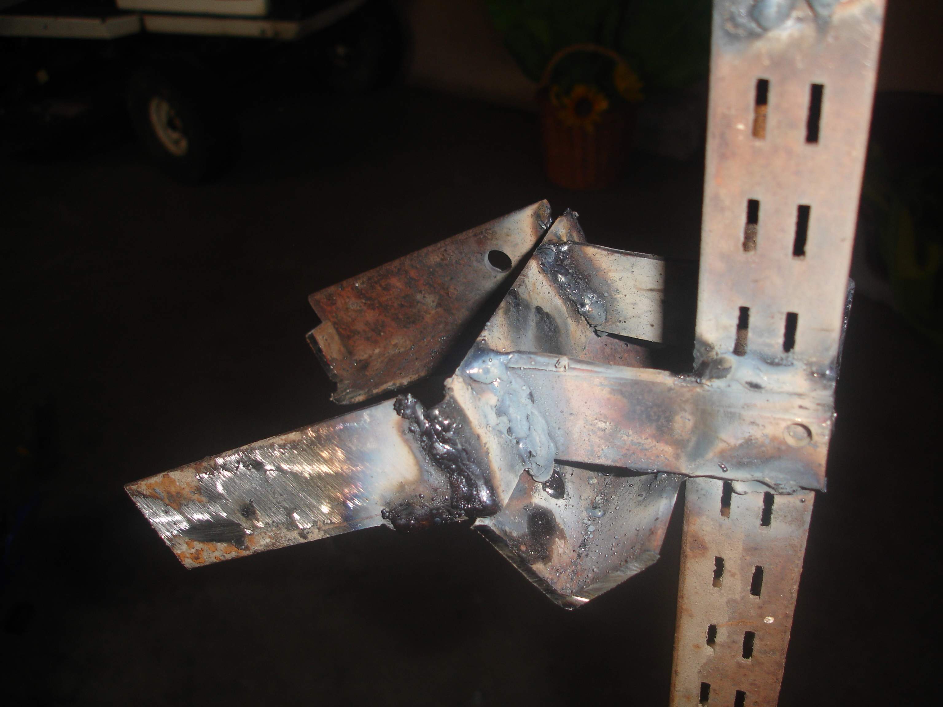

I have decited to stop this project.
I have put some loads on the lift and the metal is just not thick and strong enough.
Aventialie i will pick to project back up, but with better and more materials.
Thanks al for the nice and helpfull reply's.
