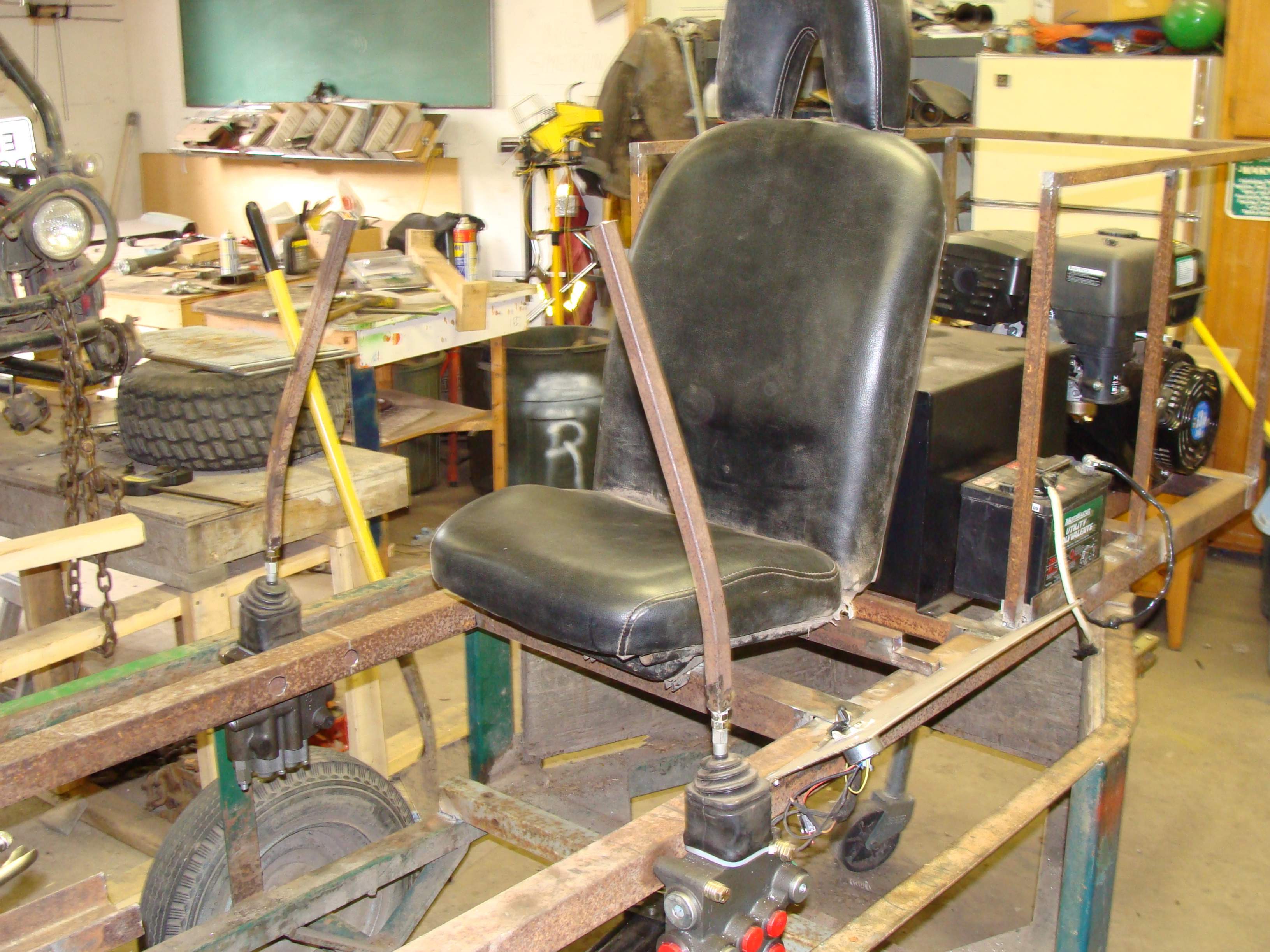

Well Long Time no post,
Anyway still havent got any pictures yet.
but so far i have basicly (besides alittle welding) finshed the boom and stick and the engine and tank mount are done, joysticks are mounted and seat are mounted.
and today i got the hydrulic pump and pump to engine coupler, i ended up getting a 6 GPM pump, i was just going to get the 3 like most people suggested but then i desieded that i was going to make a brush mower for it so i went with the 6 insted of the 3
My question is what size hose should i use.
Thanks

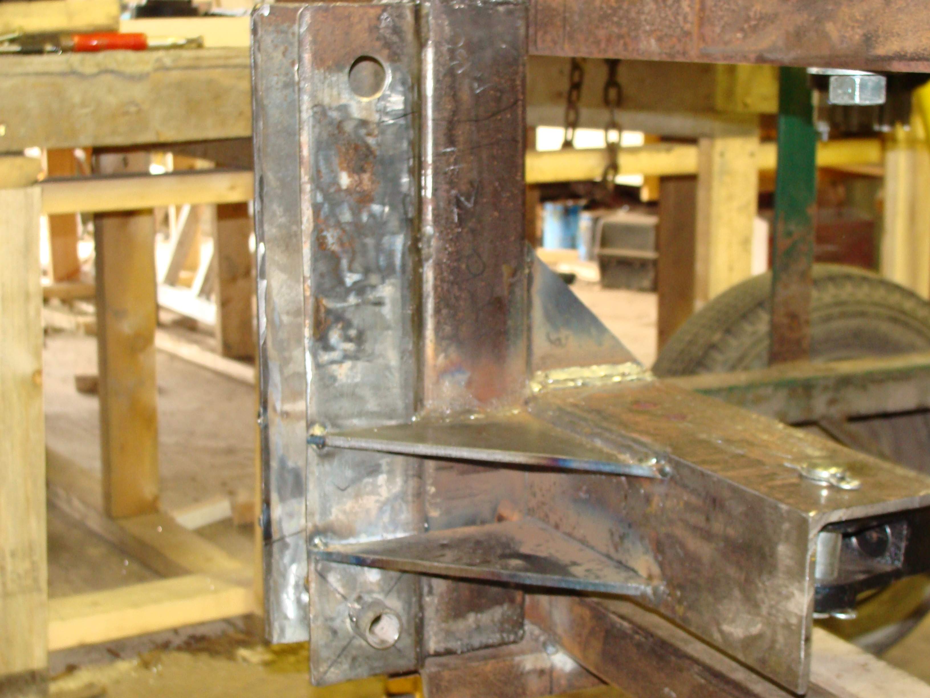

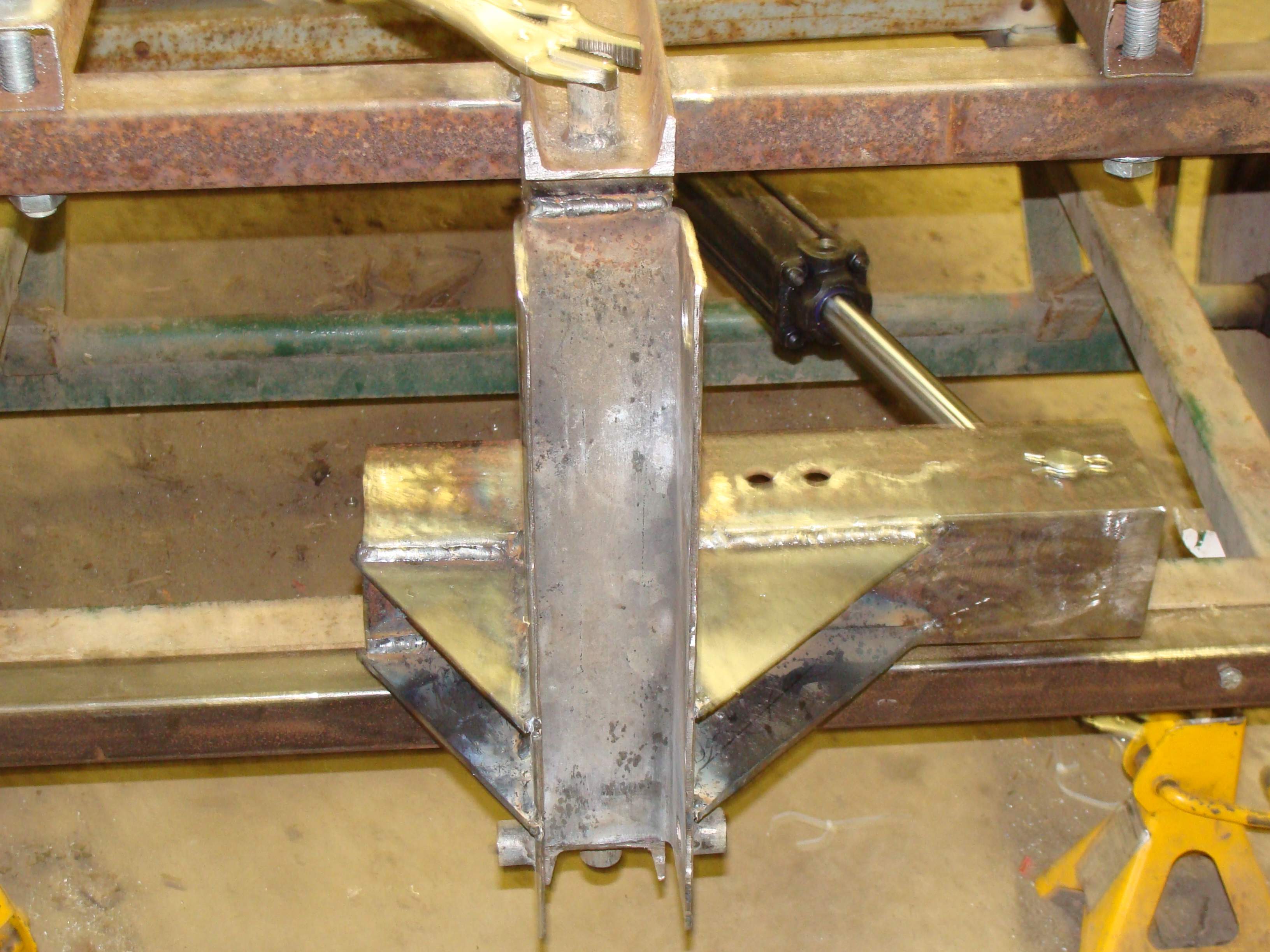

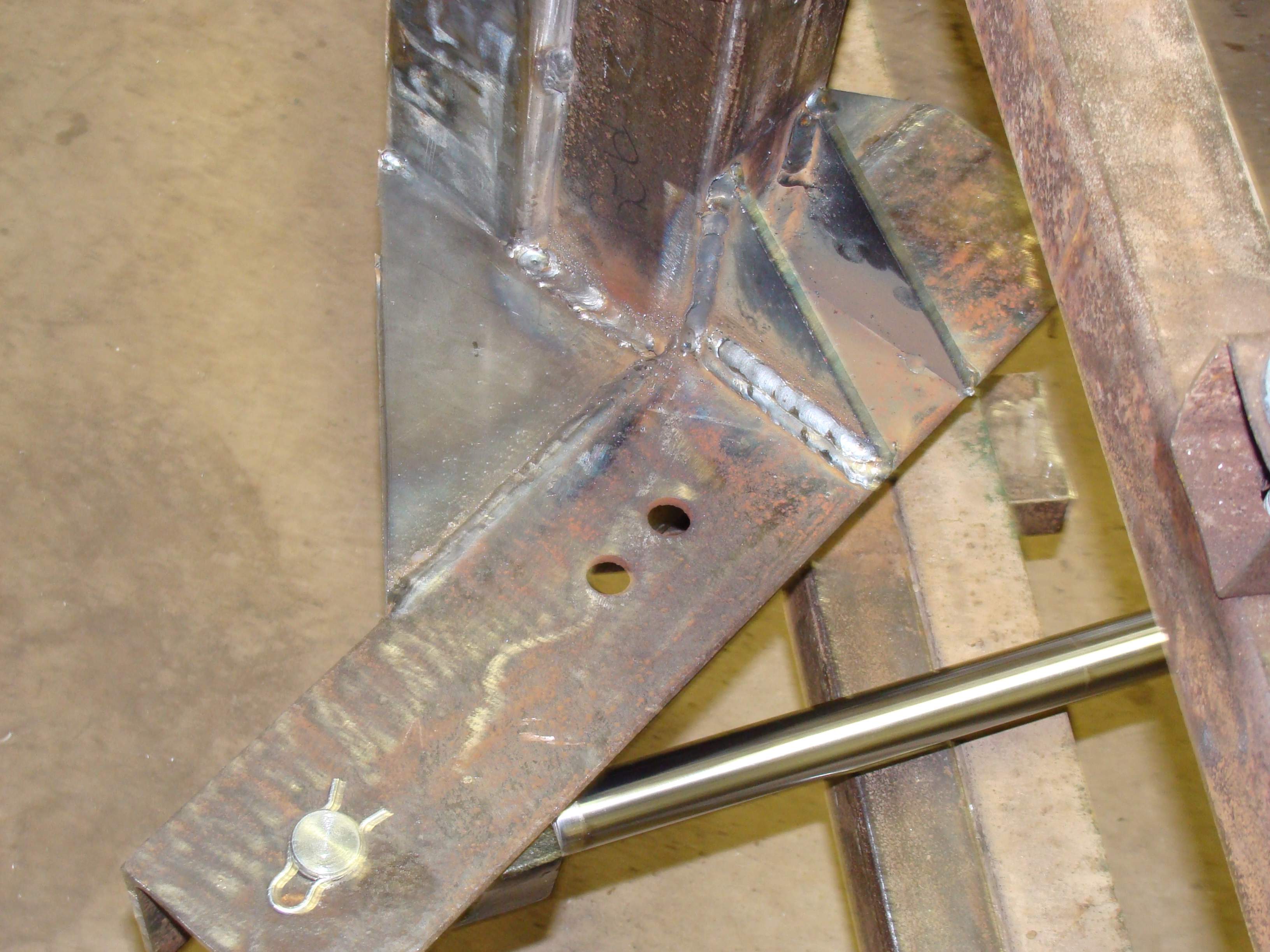

Hey,
Here are some pic's!!
/ homebuilt backhoe #66
Today I checked hose sizes on the TSC wood spliters. Not sure about pump size but had a 6 HP engine and 1/2 and 3/4 ID hoses so that I am guessing that is an overkill but over is better than under. :)
/ homebuilt backhoe #67
1/2 or 1/4 should work fine. Even at 6 gpm you'll not have huge flow rates, and in some cases you'll want to reduce the flow rate, I'd think 1/4 would be fine, I'd use whichever you can get at less money.

ok thanks,
I will take this in to acount when i go to buy the hoses.
another thing whats the best way to measure for the hoses, i was just going to use some rope.
thanks

Well here's some new picture's
for the door I Made a frame out of 1" square tubing and then used a old fradge rake for the top and toke some 10ga sheet.
havent made hinges yet tho
/ homebuilt backhoe #70
That screen should keep the squirrels from burning their lips on the exhaust pipe for sure.
