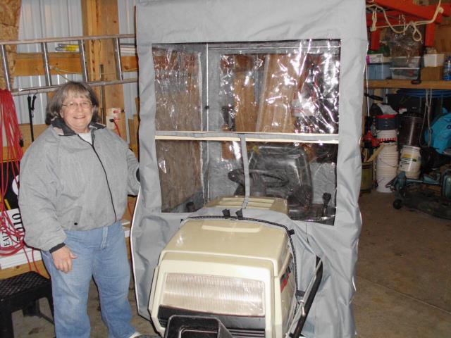

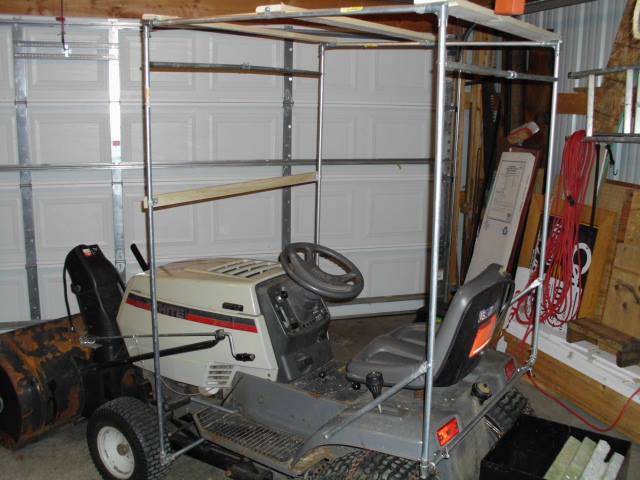

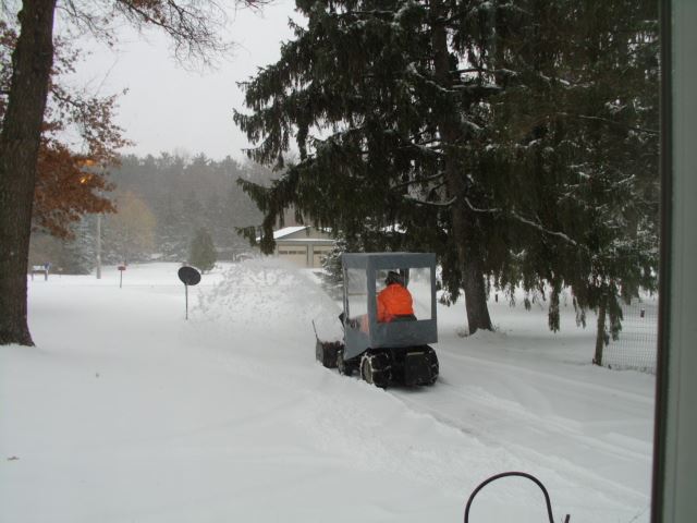

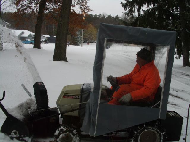

Wife and I just finished a soft cab for my White 185 garden tractor. Frame is out of electrical steel tubing and the cab is from 10mil vinyl and a treated duck fabric, both from Walmart. wish i had done this 20 yrs ago but we think it worked out well. Nice to be free of snow and wind. Will try to get photos uploaded tomorrow. Have under 100 dollars in material and about 18 hrs of labor, most of it in sewing.
/ Home MadeTractor Cab #6
Wife and I just finished a soft cab for my White 185 garden tractor. Frame is out of electrical steel tubing and the cab is from 10mil vinyl and a treated duck fabric, both from Walmart. wish i had done this 20 yrs ago but we think it worked out well. Nice to be free of snow and wind. Will try to get photos uploaded tomorrow. Have under 100 dollars in material and about 18 hrs of labor, most of it in sewing. snow 2014 cab.jpgsnow 2014 drive.jpgsnow 2014.jpgsnow cab frame.jpgsnow cab proud wife.jpg

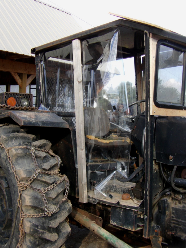

IMAG0005.JPGHere's a link to a cab I made from velcro and vinyl a couple years ago. http://www.tractorbynet.com/forums/build-yourself/266143-velcro-vinyl-cab-max.html
Now I'll give an update;
It has worked out very well except for one thing. I found out that the clear vinyl shrinks when not attached to something and wrinkles up the velcro. It still works OK but is a little smaller than when made. If and when I do it again, I would permanently attach the vinyl to furring strip frames then either velcro or screw the frames in place for summer removal.
I have drop shutters that close my porch in the winter made this on 1x3 furring strips and the vinyl is still like new after 7-8 years.

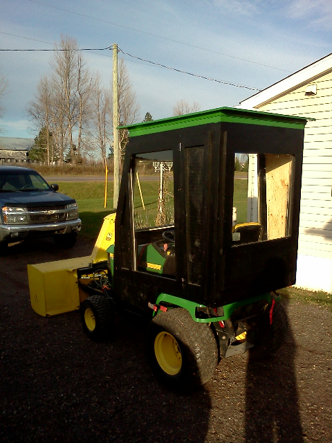

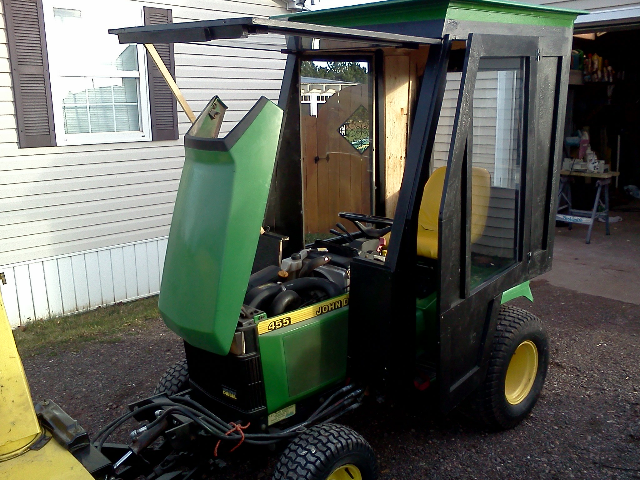

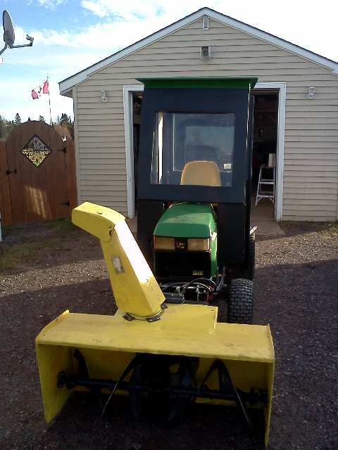

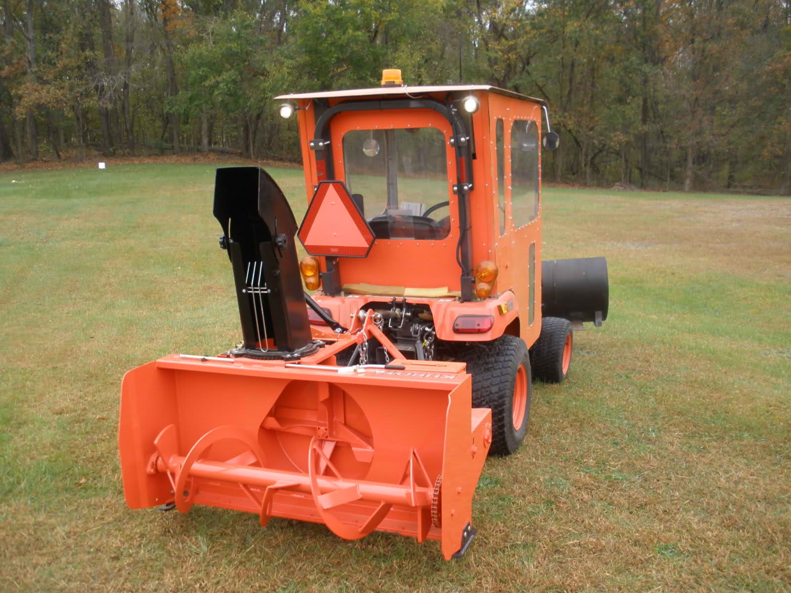

I just started building this cab for my john Deere 455. I started working on it around the first of November first, it's almost done. I can't weight to test it out.
/ Home MadeTractor Cab #9
looks similar to the cabs i build for my B1700 and My L3240, which are sold. Havent build one for my GR2120 yet, and dont think i'll bother....

Wife and I just finished a soft cab for my White 185 garden tractor. Frame is out of electrical steel tubing and the cab is from 10mil vinyl and a treated duck fabric, both from Walmart. wish i had done this 20 yrs ago but we think it worked out well. Nice to be free of snow and wind. Will try to get photos uploaded tomorrow. Have under 100 dollars in material and about 18 hrs of labor, most of it in sewing.View attachment 399493View attachment 399494View attachment 399495View attachment 399496View attachment 399497
I like the looks of your cab.
What you folks have done really looks great and maybe just what I need.
I have my electrical steel tubing frame almost completed with a golf cart plastic top and was undecided on a covering material.
I was wondering about the sewing of the treated duck fabric and the 10 mil clear vinyl, if you were able to do it on a regular light duty home sewing machine ?

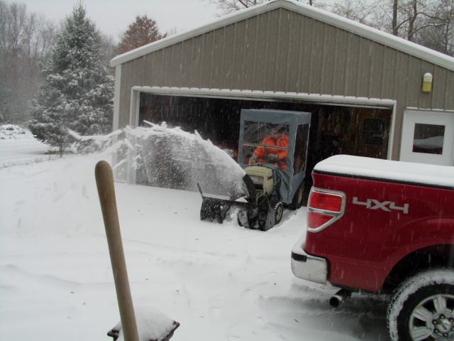

If your using a blower any type of cab is a way to go. Snow Blower.jpgfront&rear plow.jpg

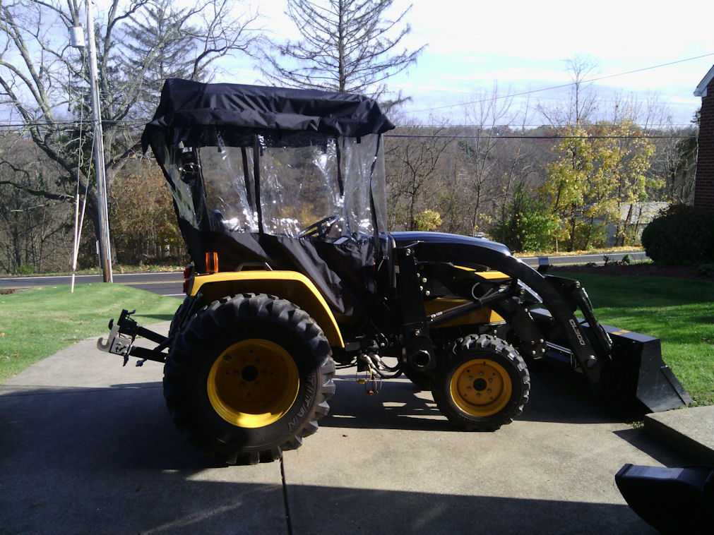

("Most of these problems would be solved if you have a sun shade and buy a golf cart cover to hang on it,,, It would be cheaper as well,, lexan is expensive")
I agree with this statement and it's exactly what I did and have done on every tractor I've owned for the past 10 years. A solid cab wouldn't work for me because I like the open air in the summer time but need something to cut the wind and cold in the winter. Below is a picture of the soft cab I used this winter, which worked very well and only cost me $130.
