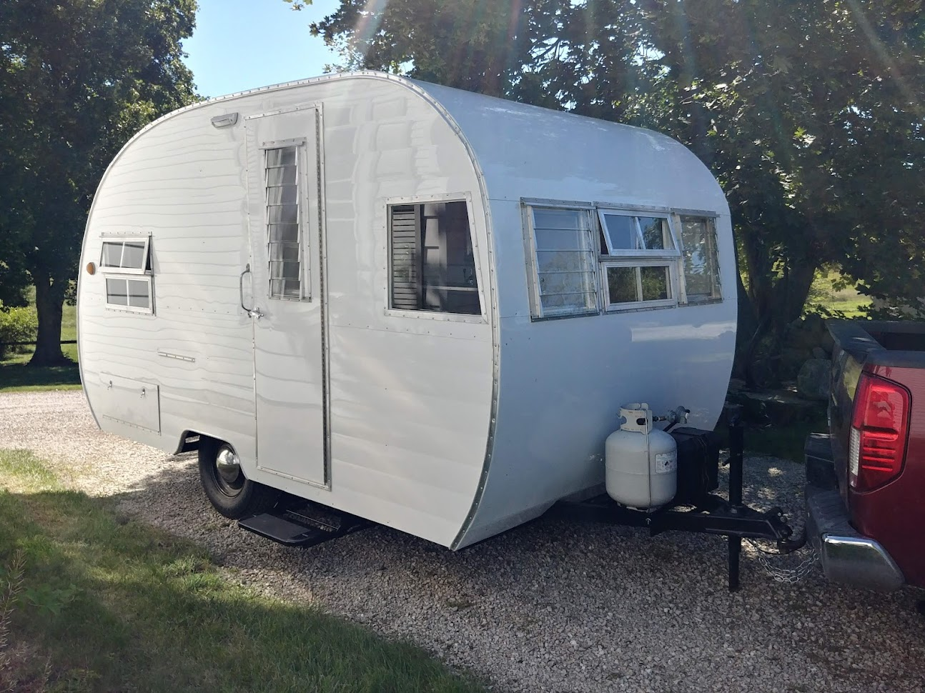

sell it to those people who renovate small old campers, they had nothing but thin plywood on the walls and ceilings.
