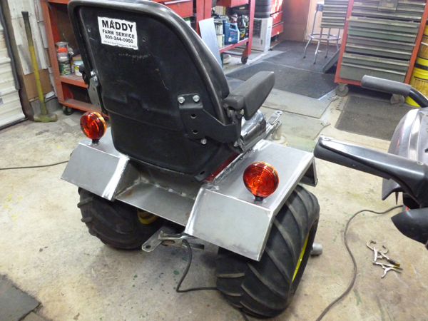

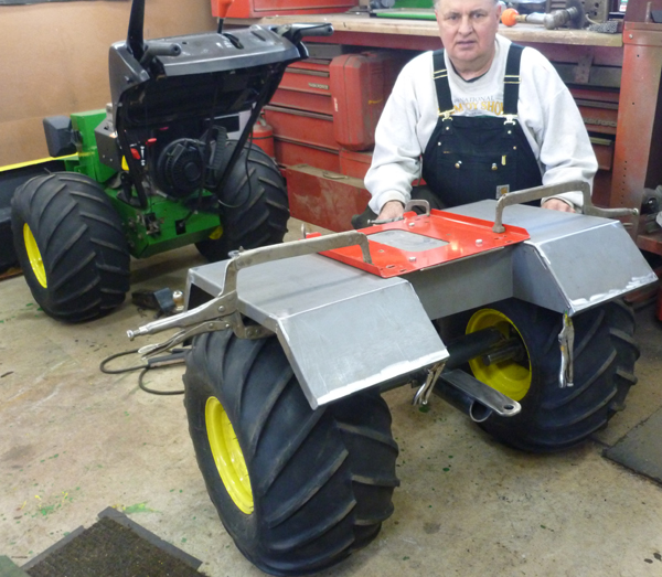

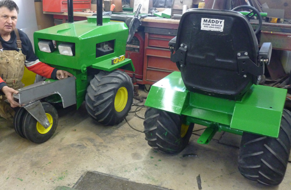

I was asked to start a new thread for this project to be sure people might see it is a new project.
You can see a series of pics as I took my walk behind snowblower and converted it into a riding doodlebug /tractor . The blade will come off for the summer and just use it to putter around with the grandson. I have 9 garden tractors and I now I am going to count this one as number 10 :laughing:
The latest progress picture shows the front fenders on and side covers and a hood over the engine . Also duel exhaust because I know chicks like those :thumbsup:
You can also see today I started building two storage boxes on each side of the seat.

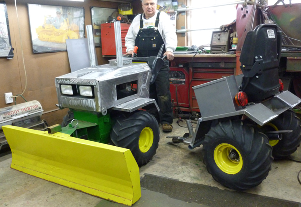

So, it looks like the back part you can hook up to anything, and it's like a trailer/surrey to pull around a passenger. Then when you hook it up to the snow blower, you have a front drive articulating tractor. I just love this latest project of yours!
/ HOME-MADE DOODLEBUG/TRACTOR PROJECT
Thanks ,

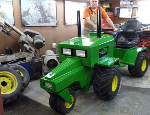

Yes , the rear can be hooked behind my garden tractors for my grandson to ride on . I would not have the rear section hooked on for plowing snow either. I will remove the blade for summer and just putter around the yard looking cool:laughing:

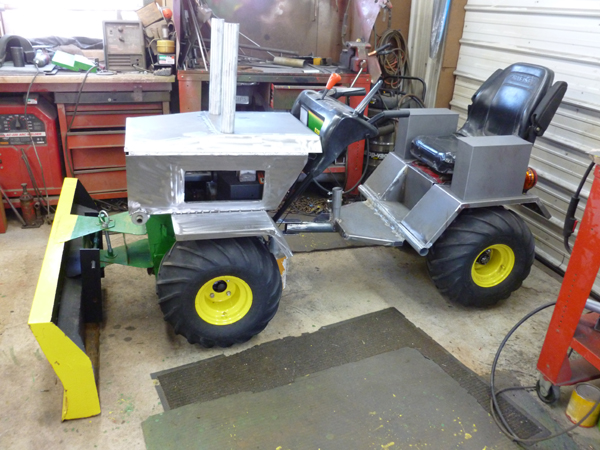

Today I worked on the front of the hood and boxed it in and remounted the headlights inside . This should increase my top speed :thumbsup:
I also attached the exhaust stacks and made a little hood ornament :confused2:aaahood.jpg

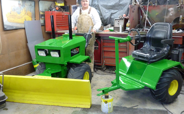

The back weighs around 100 lbs. Then add my weight on the seat at another 100 lbs, :laughing:
Just move the handlebars side to side to steer it. Kinda crude but should be fun to ride around a tractor show on it.
Today I am grinding the welds and applying body filler to the welded seams. aaabondohood.jpg
aaapaint.jpgTodays progress picture shows it now green . After a few days I will sand and buff out the paint . then I will paint a yellow stripe on the side . It is slowly taking shape. You can see the t-handle and the steering wheel for my little grandson . They can be removed when hooking up both units together.

Todays progress I decided to use the two tri-rib tires I bought 2 years ago at the Walloon Lake Steam Show.

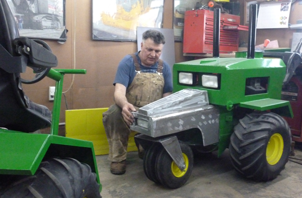

aaalight.jpgNo Nuclear reactor projects ha,ha.
Today I worked on the front section sheetmetal and boxed in a 3rd light on the front nose. I should get it all roughed in tomorrow and then next will be the last step to build the hitch that will connect them together .

Todays progress shows the sanding and painting done on the narrow front nose. 8 bolts and the front comes right off and the snowblade goes back on for winter use. Once I get the hitch made I may remove the narrow front and just build a cute normal bumper on front:confused2:aaadoodlebugnarrow.jpg

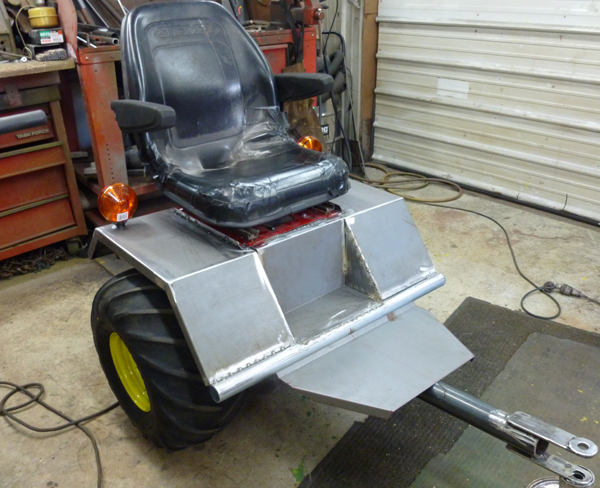

Been gone on vacation and got back to welding in the shop again yesterday . Todays progress picture shows the hitch and the steering wheel done. I took some 1/4 inch steel plate and cut out the parts with the Plasma Cutter. The steering wheel was just a added touch for more confusion:confused2:
I should get the yellow stripes painted on this week and finish the project and take it for a test drive.
now I am finishing the fender mounted storage boxes.
