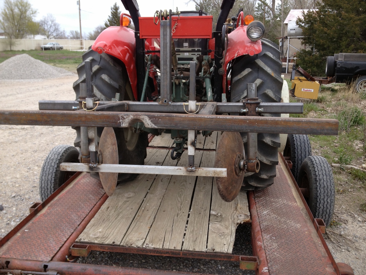

I took the time today to add a flattener and get it garden ready I built it so I can lower it down far enough to support the tool bar level when sitting.. It looks like if I don't get in the garden tonite there is 70% chance of rain and snow tomorrow and I would make so much of a mess out of it I would be who knows when getting in so I will post pics of how the garden turns out tomorrow hopefully.
You guys with good eyes will notice the rear bar is bowed there on the right side I saw it and thought I had it crowned where I could balance the bow between the 2 strut bars. But using saw horses is not an exact science as far as welding. So I plan on using a 10 ton bottle jack and a good chain later before I paint it and fix that. So just so you don't think I am some kind of hack artist it really did bother me when I stood back and saw what I did. It will work fine I just like things as perfect as I can get them just me. fwtw
The garden pics on this post are just me playing in the dirt the ground is as I left last year just tilled and sat all winter till now. I plowed it and disced it and tilled it Sunday so its prepped now and ready to be seeded once I get the hilling done. At least I am crossing my fingers I get the whole hilling thing figured out. :laughing:

I like the idea of the bar that flattens the hill rows...I bought a tool bar and 14" discs last year...This year I'm adding S-tines with tips to cover the rear tire treads and I'm also adding a bar to flatten the beds...but I'm taking it a step further and behind the knock-down bar is three shallow furrows.. one on each side of the bed for seeds and a little deeper one in the middle for side dressing (fertilizer)...
Taking it even a step further (future modification)..I will remove the furrow bar and add one or two seeder/planter hoppers and drive wheels...I plan to use the seeder/hopper assemblies that are used on the hand pushed seeders...they can be purchased as parts for the walk/push seeders for about $35. ea...if I go with the 2 row setup I may also set up a third hopper in the center to side dress...then add another bar at the tail to slightly backfill over the seeds/fertilizer...

Yup I can see some interesting mods as well! I think I will add a couple small shovels on spring shanks right behind the discs on the back bar to create an irrigation furrow on either side. I already plan on irrigating using the dip the disc creates but a shovel would do it better. Maybe a shovel right down the middle to irrigate heck if I know?

Safety police here!!! That looks like a trailer with MH axles! you know those things are one time use only right??? Your whole wheel could ffall off and you could kill the old lady planting flowers in her front yart with a loose tire.
Haha...just had to get us on another tangent.

Wow good eye Clemson haha! I even dropped them about 6 inchs that makes them even more unpredictable and dangerous! :D ;)
