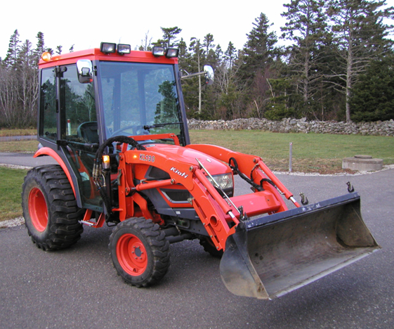

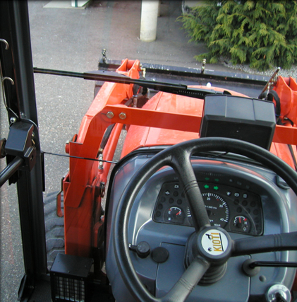

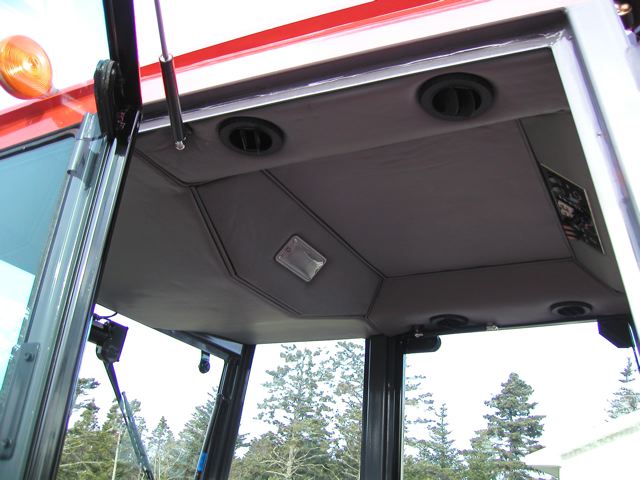

I just started looking into this forum a few days ago. I love it. It's full of interesting stuff and interesting people. Though some of you may like to see my home built cab. I had a Sims cab that I did not like. Too much steel and not enough glass. I saved the door latches, the roof panel and the heater. All the rest is new. I made patterns and ordered tempered glass with holes for hinges, wipers etc. Had fun designing and building and now have fun using it.

/ Home built cab #2
Welcome to TBN!
Very nice job!
You done such a great job that it looks like a factory cab.
What kind of metal did you use for the frame ? ... It doesn't look like tube.
Thanks for sharing.
/ Home built cab #3
What a nice looking cab! Do you have build pictures? I would love to do something like this... Any details and more pictures would be greatly appreciated.
/ Home built cab

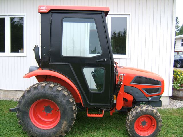

C'mon DEON, who do you think you're fooling ?? ;);)
How about a before and after photo.
Can you tell me what brand this cab is if it's not home built?

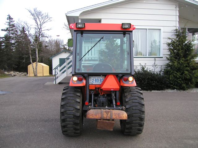

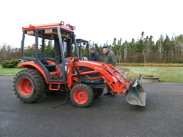

Built of 2 x 2 x 1/8 square tubing with 1 x 1/8 flat bar welded to it for door an d window stops. Yes I really did built it, with a mig-welder, chop saw and aerosol spray cans.

Nice Build. Do you have any unfinished / in construction pics? Looks like you lengthened the cab a bit
