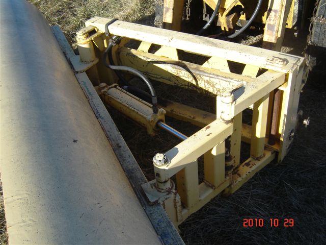

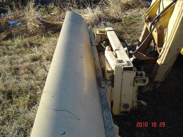

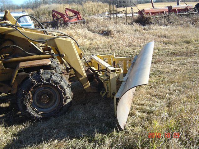

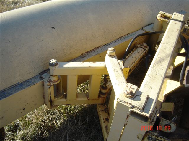

Among other things i build this dozer blade for my little loader.

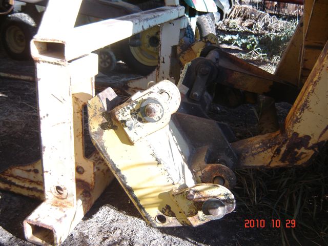

10' wide and hydr angle + 1 pic of the home build quik attach(extra ears so it can be used on the tractor loader as well) on the loader, hooking up to the bale fork(made as well)
works good for both snow and dirt.Its indestructable

That's a very impressive build! I can't say that I have ever seen an angling system quite like that one before. Is it an original idea of yours or did you adapt it? Slick idea regardless! :) Any more pics of it in action?
/ home build mini loader dozer blade
I never seen it before either or after for that matter.
I designed it that way,i wanted the blade as close to the loader as possible and weight was a factor as well.I find conventional angle blades stick out to far ahead anyway.
This setup also gives me the abillity to flip the blade over forwards and run up close to a fence or building in tight corners and scrape material away from it,like a snow drift or so.
Sorry,no action pics

Very nice. First thing I thought was how nice a tilting system you built. Very good idea. Put some thought into it and built it right the first time. Everything looks very sturdy and strong but not bulky.

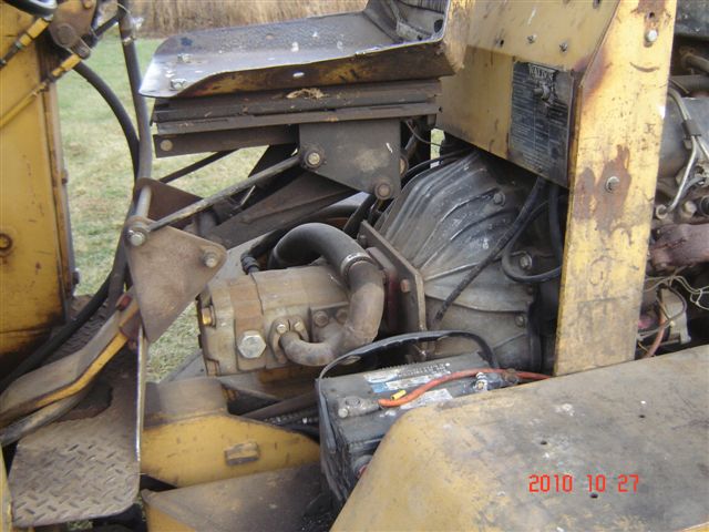

I bought this loader for $500 without engine and with a worn out hydr pump.
I repowered it with a GM 6.2 diesel i had sitting and a stackable commercial pump with the right output i had laying on the shelf.
It took a bit of juggeling to get it in there,but it looks like it belongs there now.I needed to shave an 1 1/2 of the pan to set it low enough so the hydr pump would not interfere with the seat.I swapped the exh manifolds left to right and upside down to get the stacks at the rear
it has a 2 sp tranny and can clip along pretty good in second
It took a bit of juggeling to get it in there........it has a 2 sp tranny and can clip along pretty good in second
Welllll I recon! :thumbsup: I think about the biggest option was around 80 HP in the newer loaders...that one probably came with a Ford industrial in it originally. I'll bet chains on 15" tires aren't exactly bogging it down or anything. I like your style! OH yeah, kind of got off track with the "more power" thing...great dozer blade as well.
