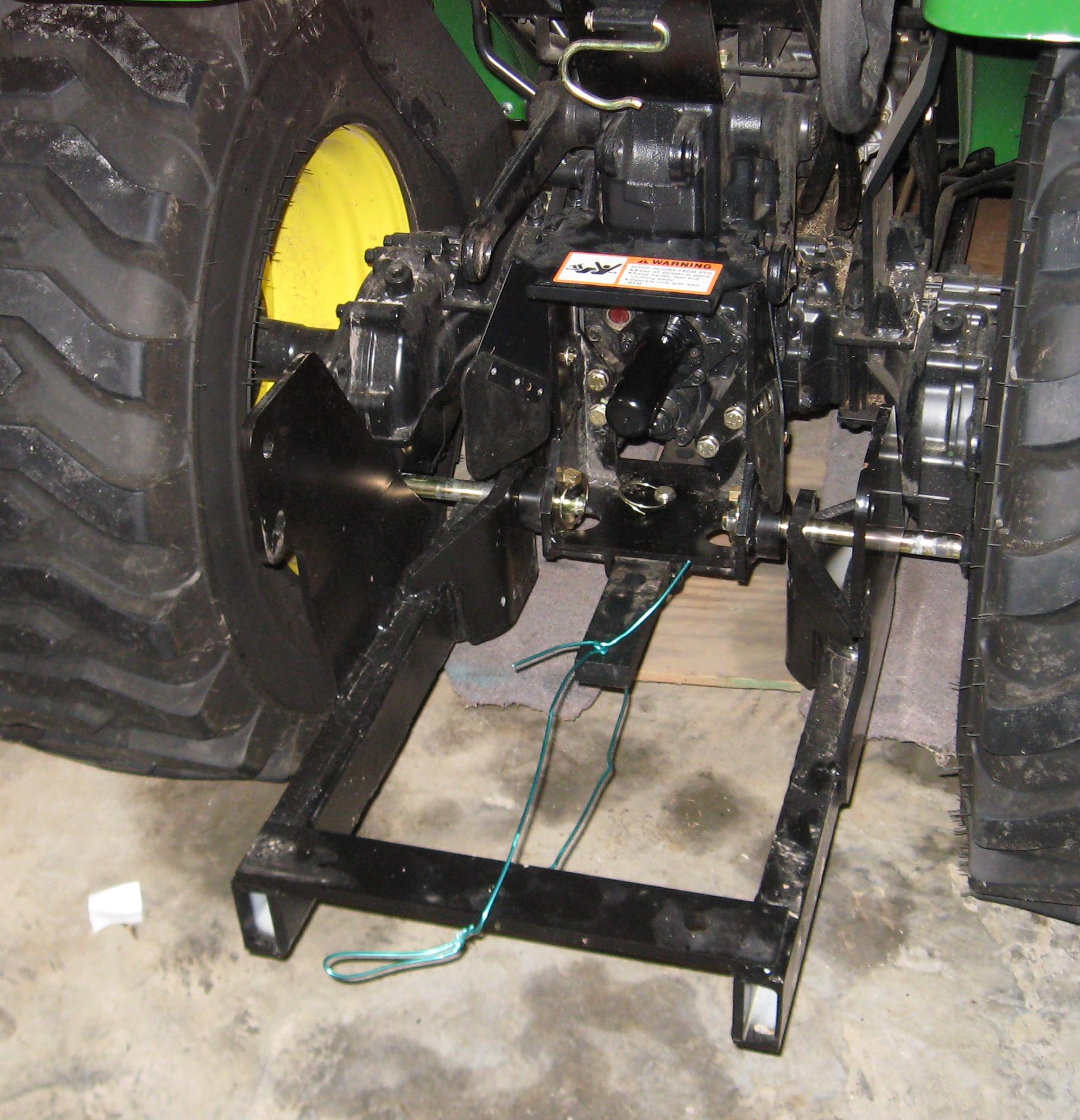

I'm not sure if the wire on the draw bar will last for long holding it up, better use at least a piece of 12-2. However, the chunk of cinder block should work fine as long as you don't drive it anywhere... :D

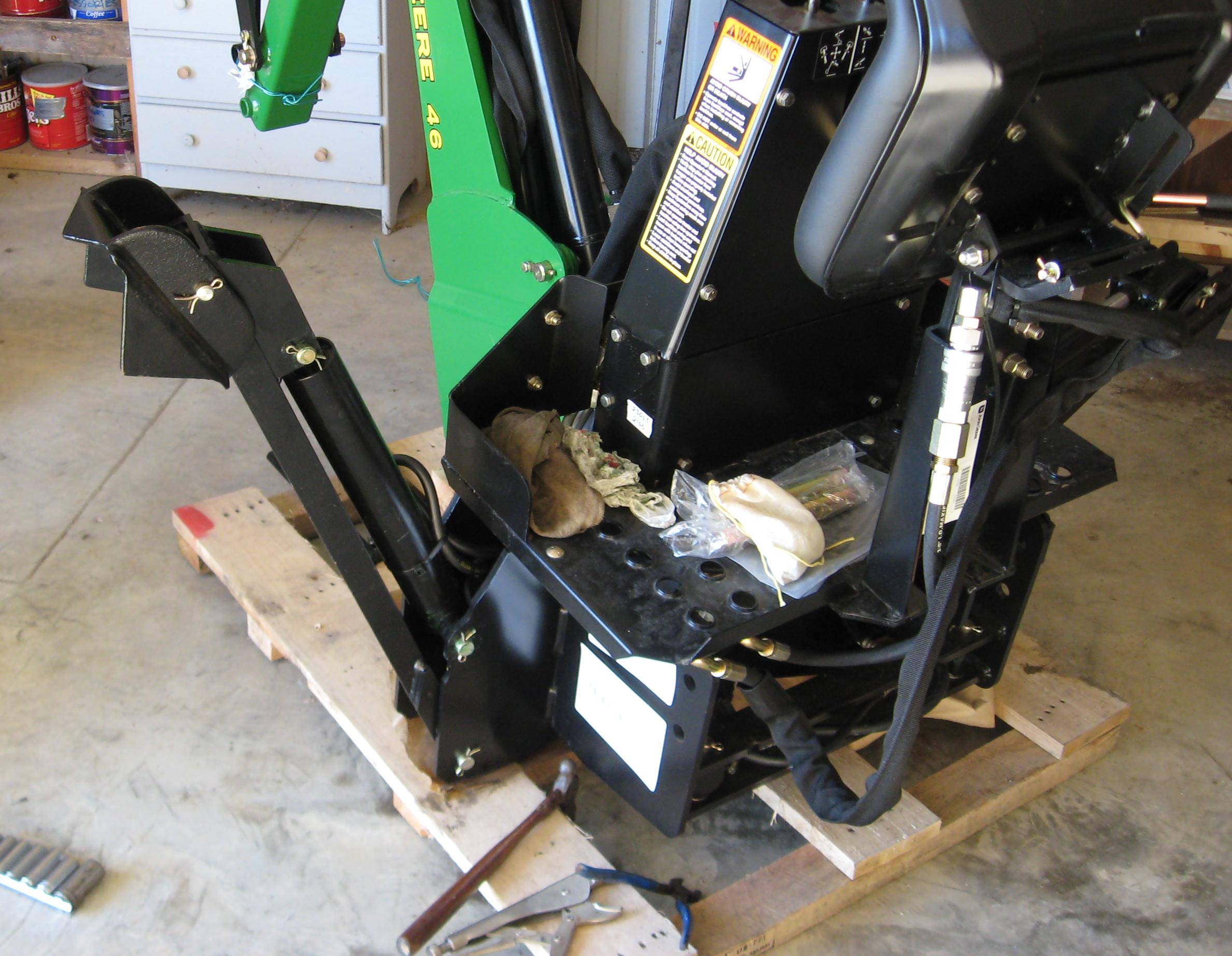

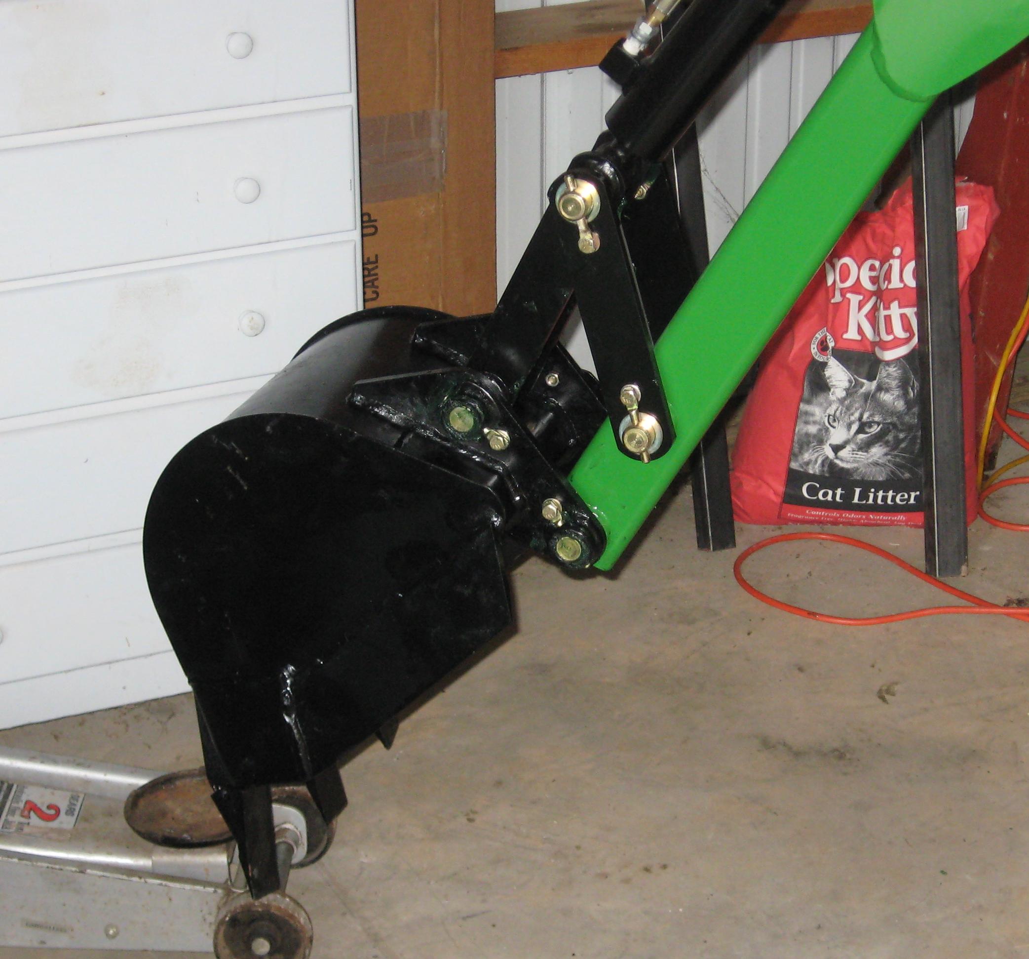

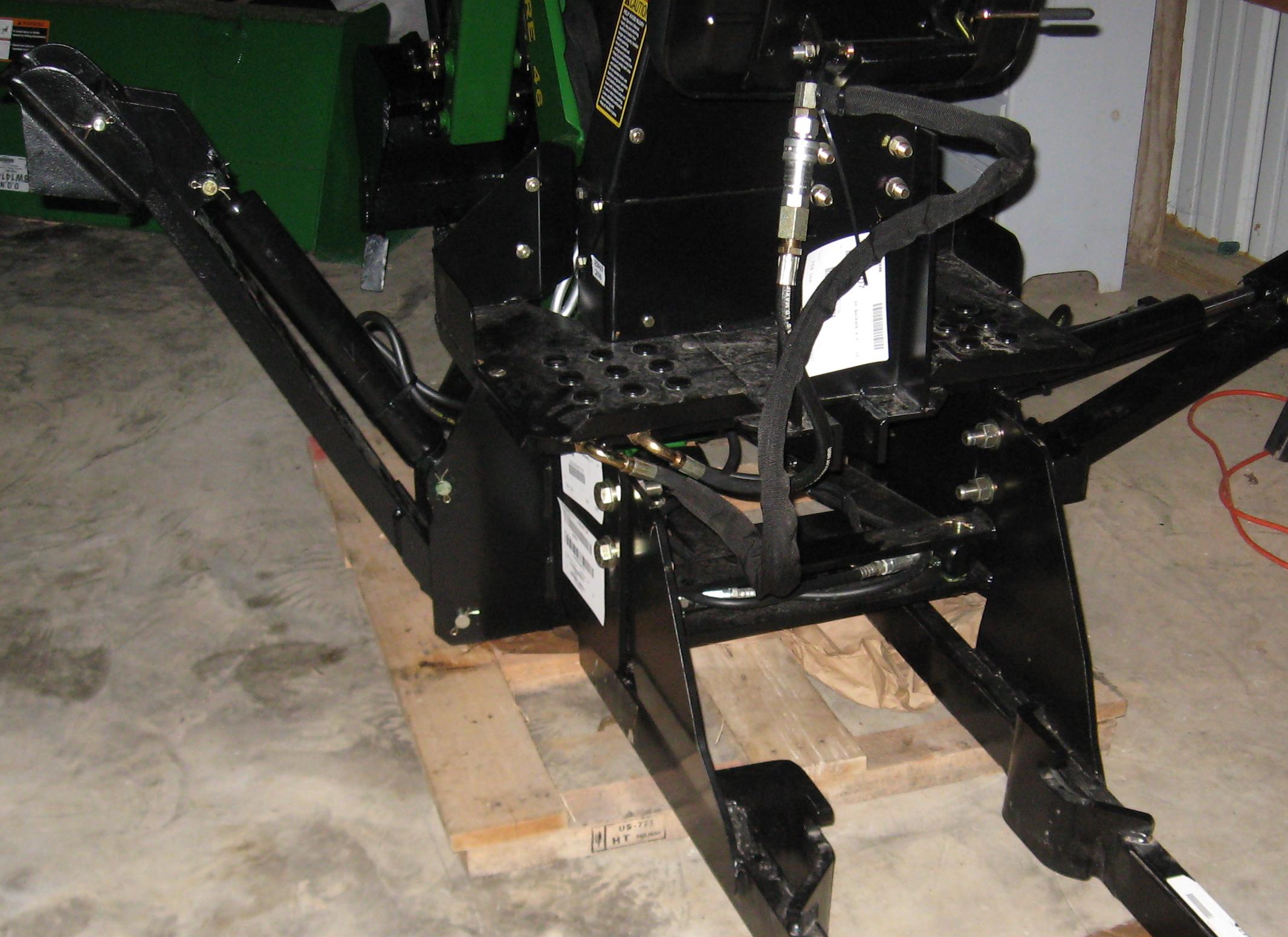

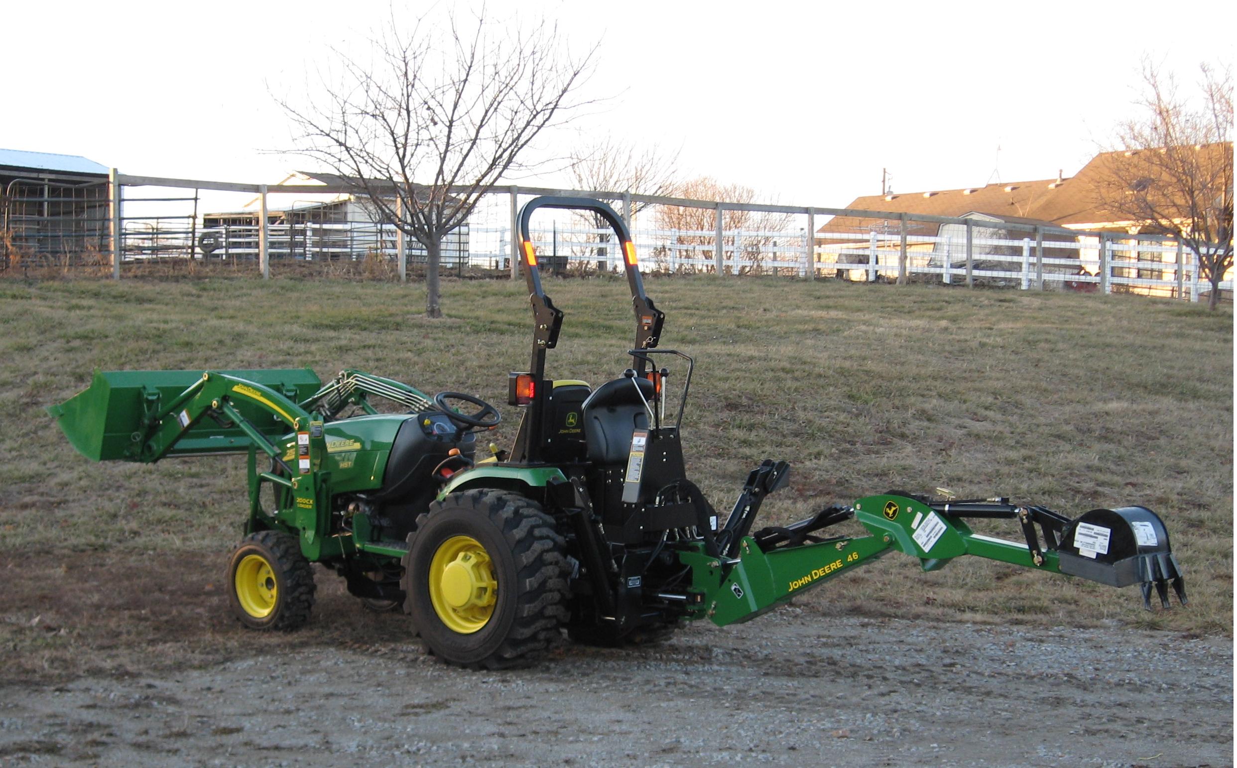

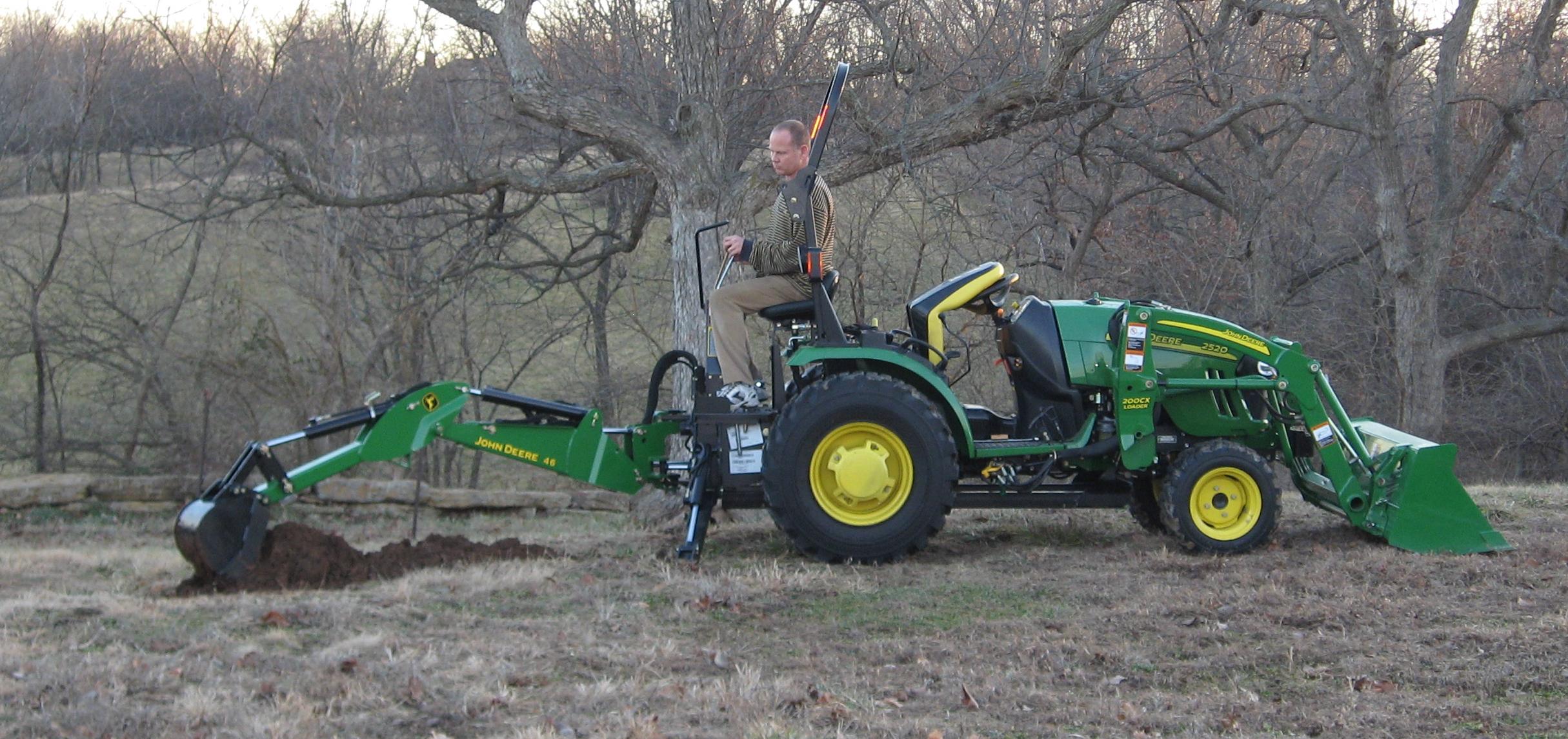

Got the backhoe mounted this afternoon and went for the trial run. Everything went together smoothly and worked as advertised. Only casualty was a slightly bent tooth from trying to dig out a big rock. A 5lb sledge hammer got it back in shape in no time.
The ground was just too muddy to do much else.
Attached are a couple of pics.
Chris - sorry, the trial stump and rock came out too quick to get a photo, but suffice to say, I was impressed and will be looking forward to taking out bigger and nastier stumps and rocks.
Tom, the price before tax was $5500. Yeah, that wire came with the hoe and really came in handy for holding the subframe in place while I messed with the front mounts...
Now, the hoe is parked and I get to put all the three-point stuff back on to get ready for the next snow storm. Ah, back to reality...

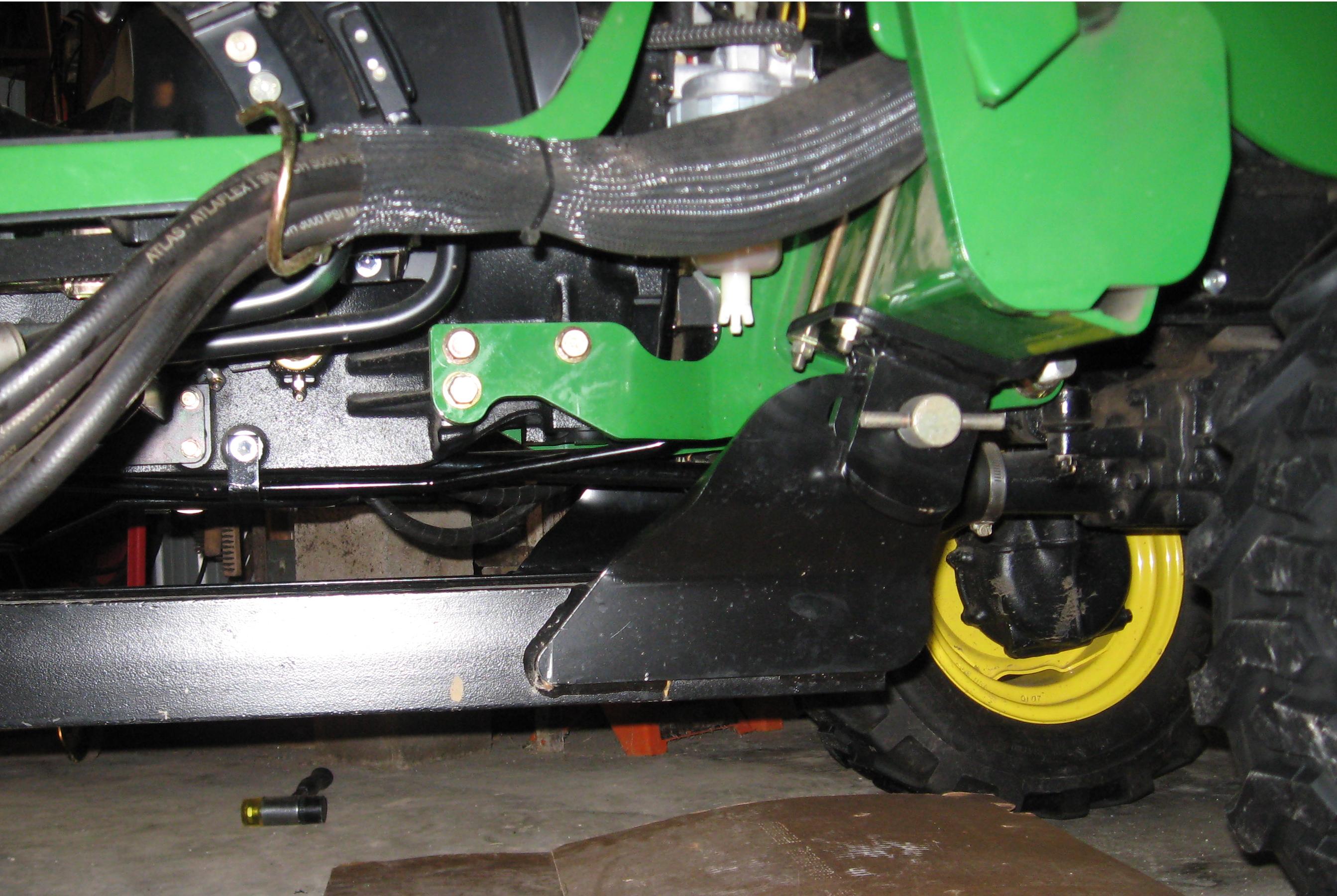

Almost forgot to mention this, but for anyone curious about this issue, I did not have any tire clearance (R4's) issues with the 46 backhoe install, front or rear, and I had the wheels turned sharp and was working on a hill.
The rear tires clear the corners of the operator platform by about 3/4 inch.
It's all pretty tight, but works fine.

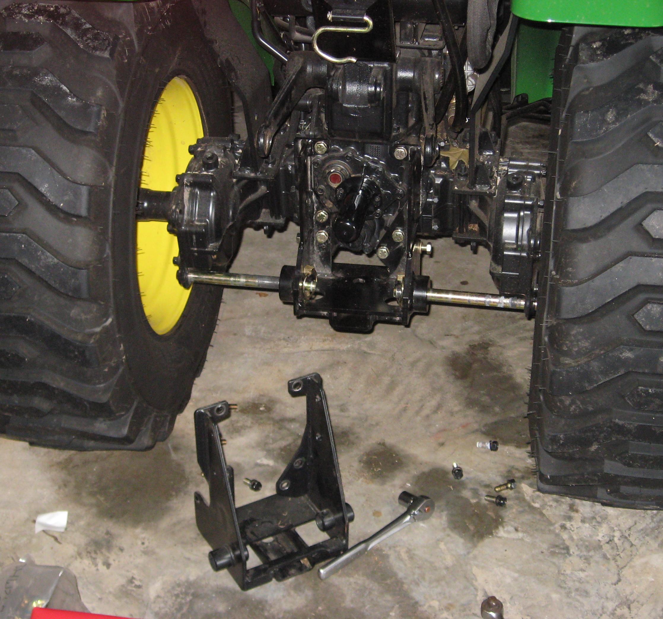

RE: removing backhoe/attaching rotary cutter -
I'd say it can be done in around 15 minutes - getting the hoe off is super-easy. It just takes a little longer to re-mount the three-point stuff.
/ Hoe, Hoe, Hoe #29
You will get the complete change over down to about 7 min ,
after you do it a few times..;)
Chris.....:)
/ Hoe, Hoe, Hoe
#30
I'm replacing the cotter keys with spring locking pins which will make the operation completely tool-free and should save a little more time...
I had originally given some thought to the idea of just leaving the i-match attached to something like a box blade and just unhooking the three-point gear from the tractor side and leave all the stuff hanging on the blade. However, after doing it once, I think it would be harder to line up to put it back on.
My conclusion is that it's best to remove all the parts one-by-one, except leave the side links and sway links connected to the draft arms.
