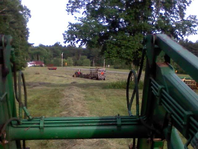

Thought I'd toss up a haying pic from last night. Cell phone quality from a moving tractor. I was round baling and cruising right along. My father is running the square baler in the foreground. Its been really wet this june, we just snuck this batch in.
