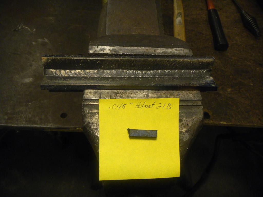

/ Hobart Handler 190 opinions #13
Speaking of wire, what good general purpose flux core wire are most of you using?

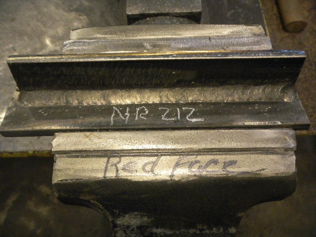

For T-11 wires, Hobart's 21-B, and Lincolns NR-212 are hard to beat.

Shield Arc- I doubt my beads will ever look that good. Since I'm already 63, I doubt I'll have another 30 years to practice.:D
Oh I think you'll be surprised. MIG / wire feeds are the easiest process to learn. The only trick is learning how to set the machine. If your machine comes with a door chart, don't go by that! The door charts I've seen are way off. :confused:
