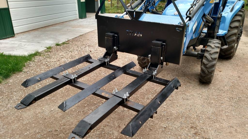

Just be careful to not overloaded the bucket! Could be a seat creaser!
   / High Capacity FEL Bucket Mod #14
Looks good, I need to make a higher capacity mulch bucket one day for the L, the bx I can just use the L's bucket!
Sent from my SM-S921U using TractorByNet mobile app
   / High Capacity FEL Bucket Mod #15
Some clamp on debris forks would be nice.
   / High Capacity FEL Bucket Mod #17
Good job, seems like it would be easy to overload, there have been many times I could use a physically wider and deeper bucket.
   / High Capacity FEL Bucket Mod #18
Easy to make debris forks out of angle iron. Great for hauling brush
   / High Capacity FEL Bucket Mod #19
You might want to consider adding a locking system so the pins in the arms are forced to rotate in the greaseable area of the joint. Otherwise, the 1/4" flange might be where the pivot occurs causing wear at that point as opposed to the greater surface area where the pin is in the cylinder rod.
Maybe it is secured to the plate and I cannot see it though.
   / High Capacity FEL Bucket Mod #20
OP: what is the fel capacity of your tractor? weight of the bucket? nice work. looks good for brush/debris removal as well
