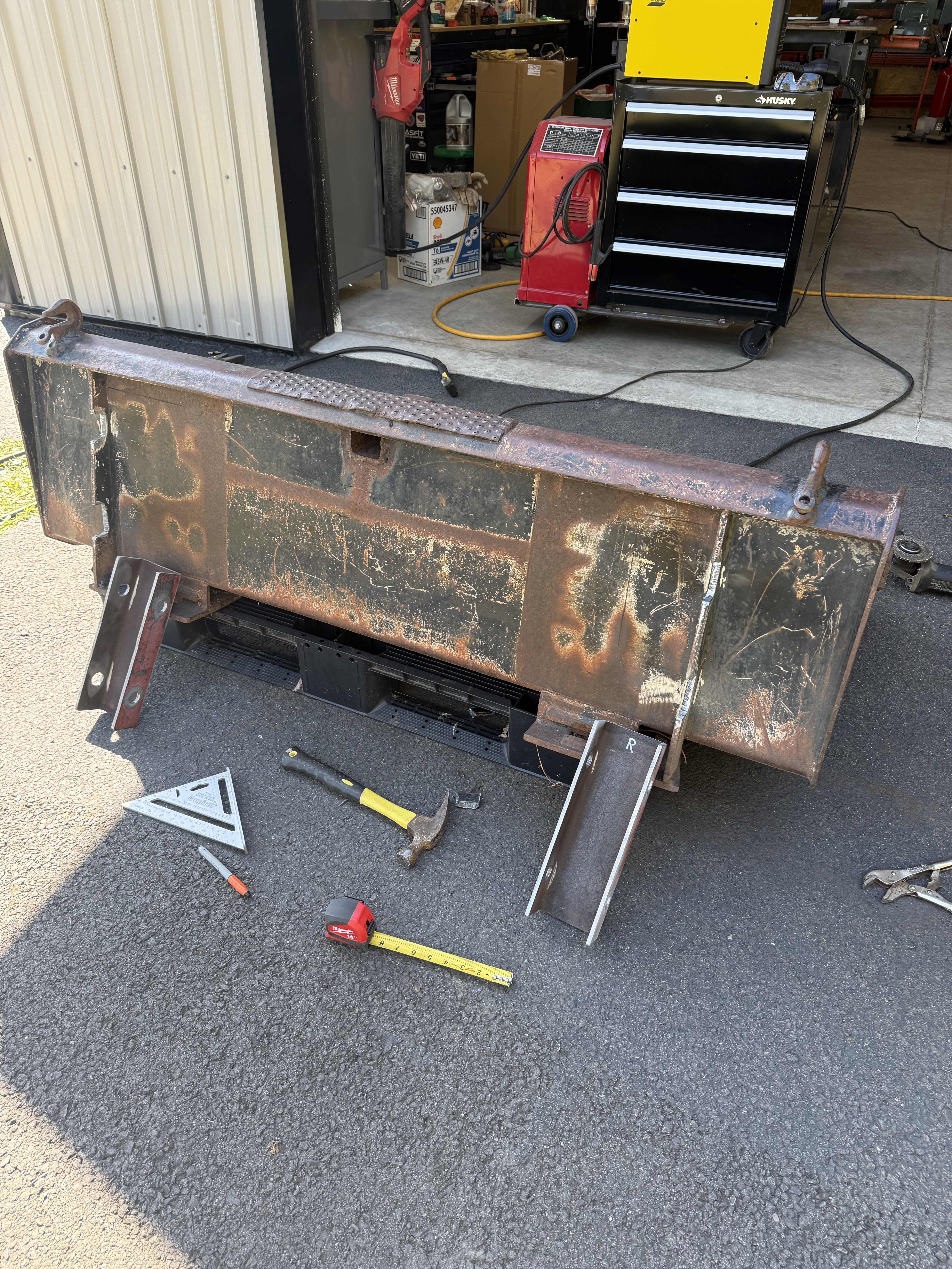

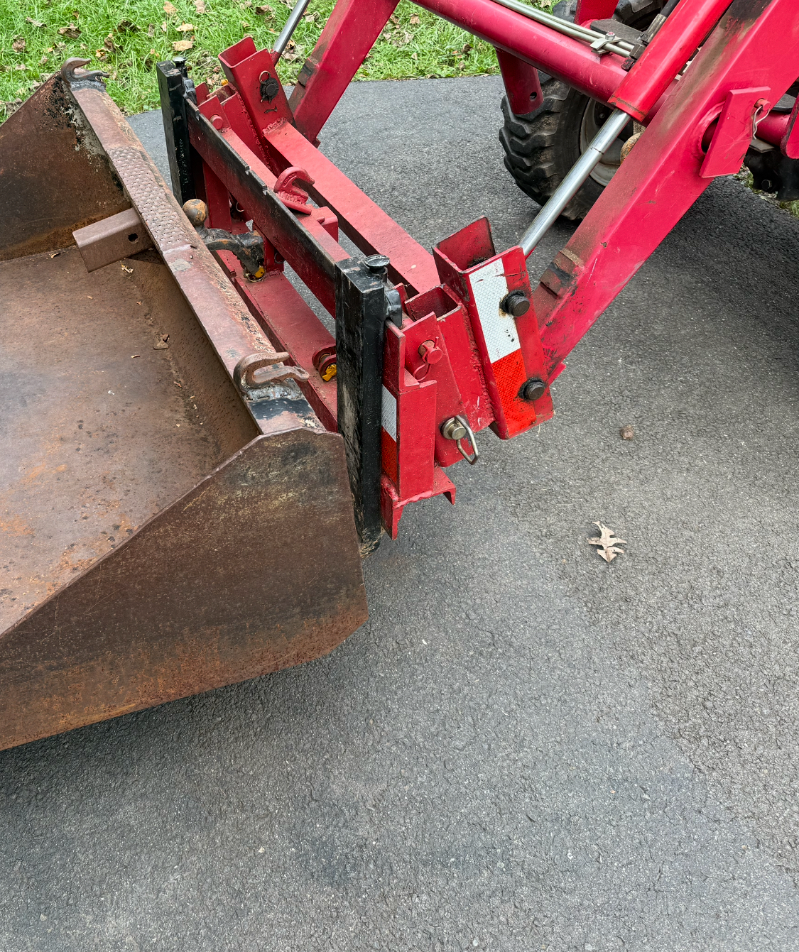

Picked up a new to me skid steer bucket a few weeks ago, made some modifications so it’ll work on my homemade quick attach for my Mahindra 2615, and also made an extension to increase capacity for mulch, leaf cleanup, and firewood.

Cut down some 4” square tube, drilled holes and welded them up to bucket

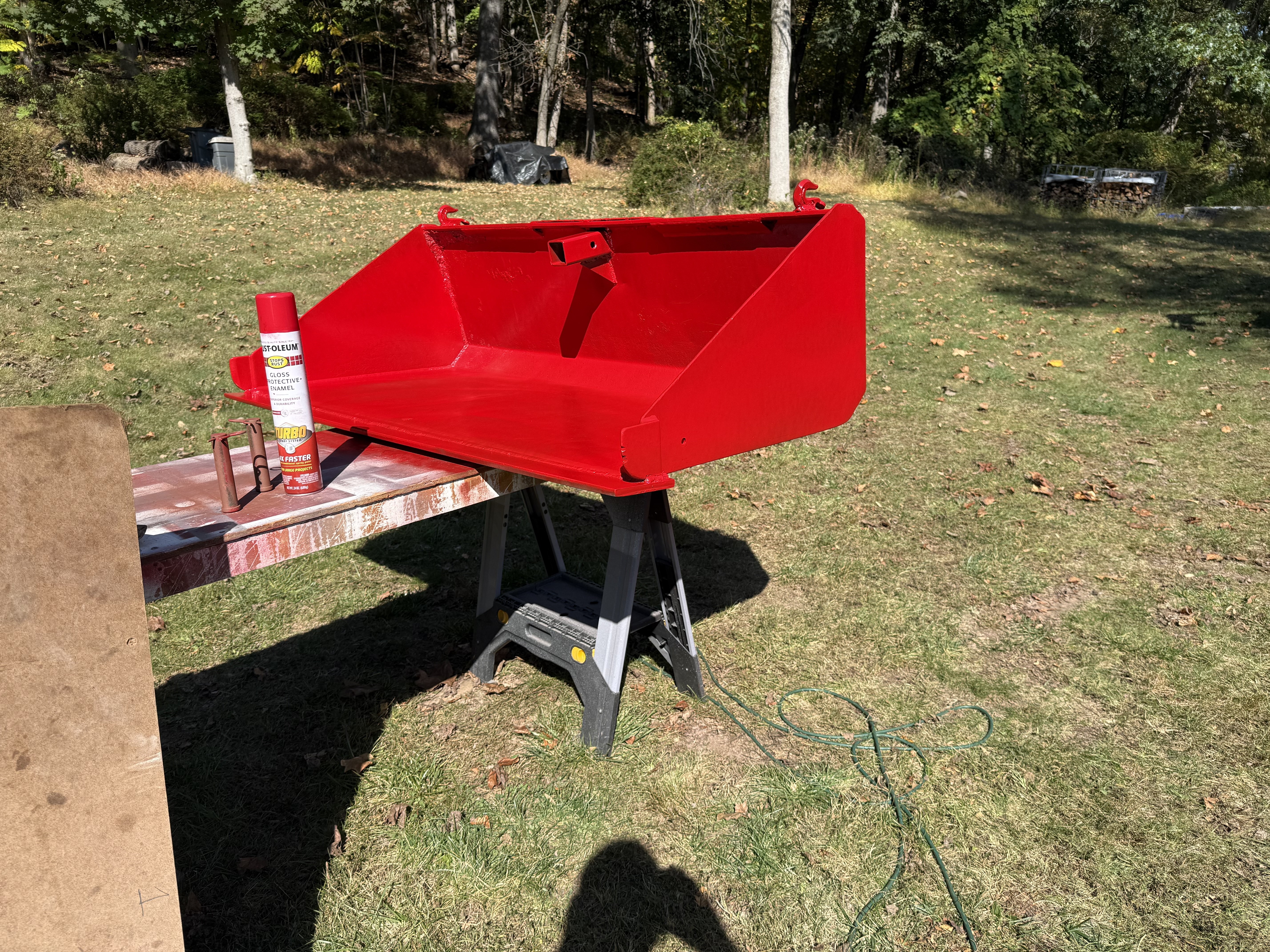

Flap disc, primed and paint

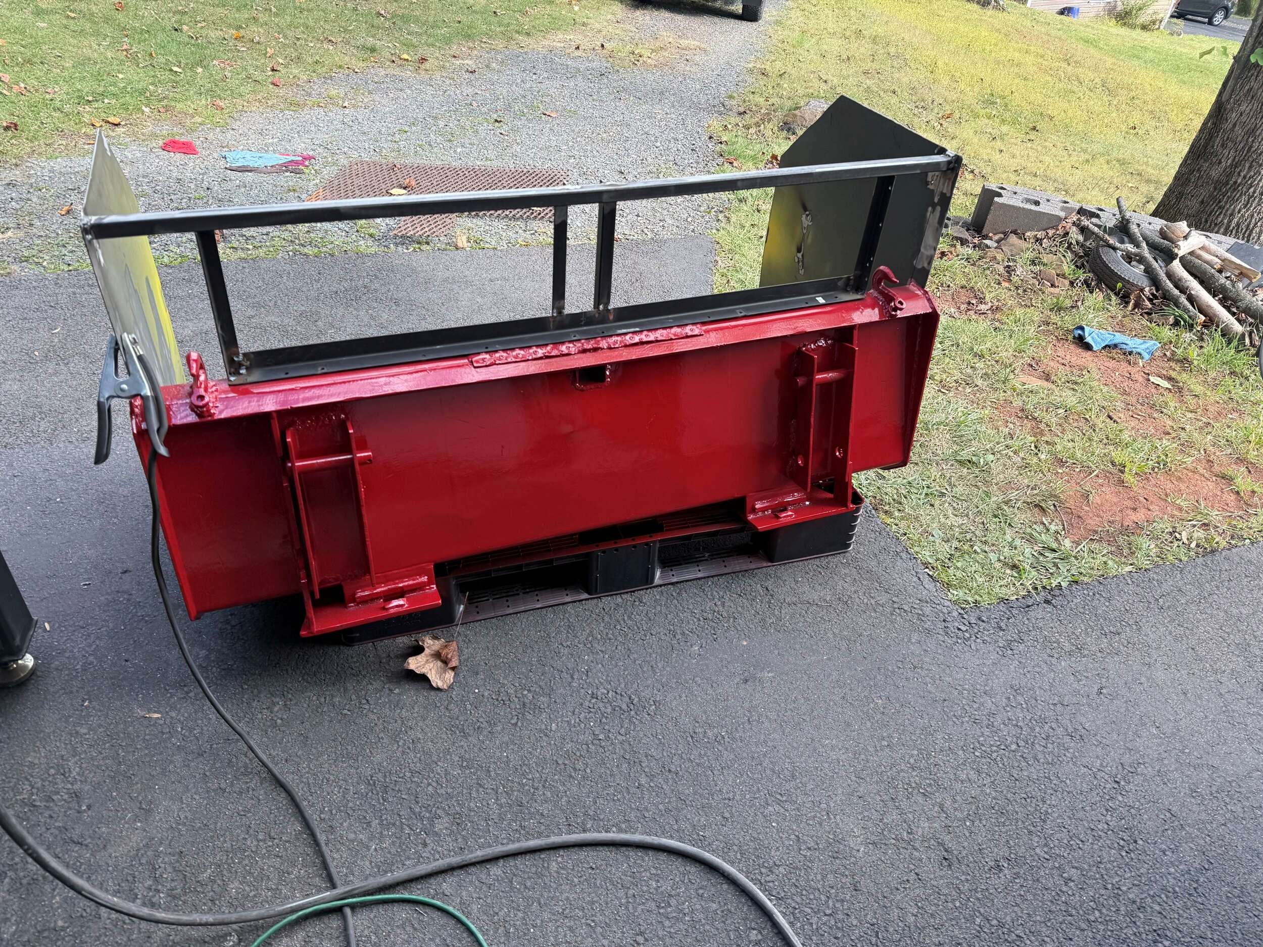

welded up with scrap metal i had, an extention for sides/rear to expend capacity.

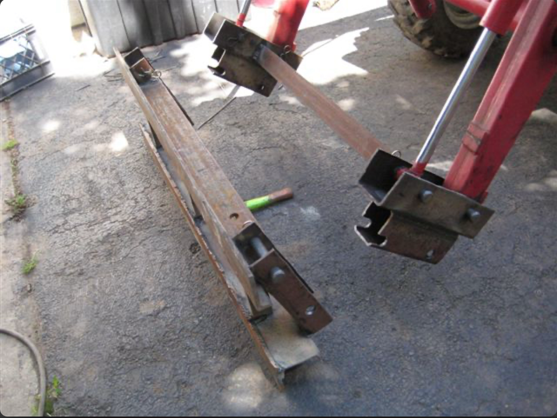

I'd like to see more details on the HM QA build. I've got a Kubota B7800 and taking the FEL off - well, it's a real chore (I've never attempted!).
Taking entire FEL off? Or just removing the bucket from the FEL arms?

Some clamp on debris forks would be nice.

Easy to make debris forks out of angle iron. Great for hauling brush

You might want to consider adding a locking system so the pins in the arms are forced to rotate in the greaseable area of the joint. Otherwise, the 1/4" flange might be where the pivot occurs causing wear at that point as opposed to the greater surface area where the pin is in the cylinder rod.
Maybe it is secured to the plate and I cannot see it though.
