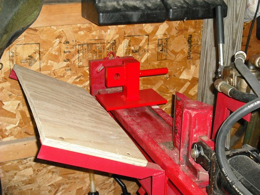

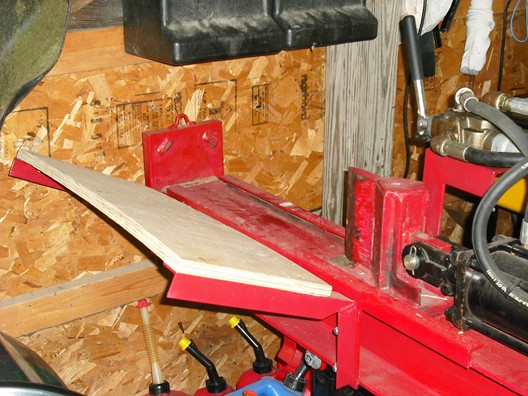

/ HF Shop press as log splitter #4

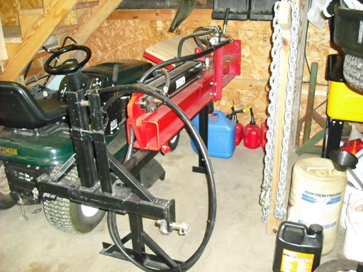

I did the opposite. I built my splitter 5 years ago from scratch after not being able to find what I wanted in a 3 point splitter. I made it with a fixed foot and the wedge is attached to the cylinder. I also made a shop press adapter that fits in place of the wedge. Here is a few pictures of the splitter and you can see the press adapter sitting on it in the last one.
