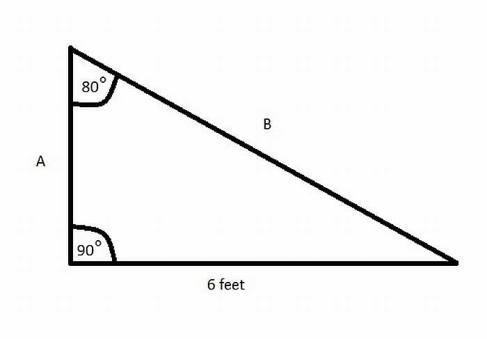

Can you solve for A? This is a roofing question. --Ian

12.69"

A = 6' / Tan(80) = 1.058'
1.058' * 12"/1' = 12.7"

The answers given for the problem as stated are correct. However this was offered as a roofing question and 10 degrees seems a little unusual to me, it works out to a 2.116 / 12 roof pitch. Is this angle/pitch correct?

Not a hard trig problem, you got lots of folks with the right answer. But, it does seem like a low pitch roof, and most roofing I've done, I pretty well eyeball this stuff. Maybe use a framing square?

My house and barn metal roofs have 4/12 pitch. We have significant snowfall in the winter.

It was eyeballed instead of calculated. Snow isn't a significant factor here. I'm building a small chicken coop next to my wood shed and want the roof pitches to match approximately. I'm not much of a carpenter, geometry class was 25 years ago and I never took trig. :laughing:

The length of B is approximately 6.0925596713144699114053061099508 feet.
Or about 6' and 3/32 inches. << EDIT...previously incorrectly said 3/16
