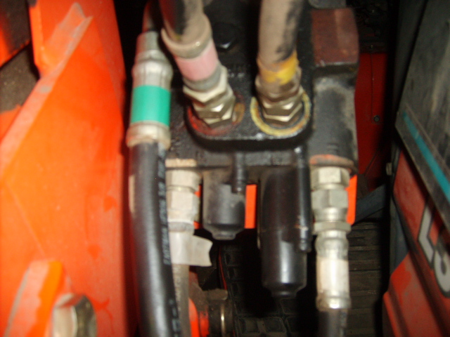

Hey guys I'm posting for an older friend who thinks that computers are evil, well kinda anyway.
His problem is with a Kubota L3710. Everything seems to be normal with the hydraulic system except that he used to be able to lift the bucket just while standing off to the side of the tractor. Now he needs to rev it up to 1250 to 1500 just to get it going. I have some info and can get more if you need it. He's a great guy and I'd sure like to be able to help him figure this thing out.
As I said the tractor is a L3710
Loader..LA681
control Valve Body L2085
Bucket L1741A
I believe It's a HUSCO sytem under the controls..

And yes the filter and fluids are new..the pressure seems to be correct throughout the system...something is just not right..Like something so miniscule it's been missed.

There are some really good hydraulics guys on TBN. I am not one of them but I would check the quick connects they can restrict flow if not seated all the way. I would just power the machine down relieve the pressure and reconnect and give it a try.

Try disconnecting the quick disconnects and reconnecting them. One might be partially closed and restricting the flow.

I notice there has been no mention of boom speed compared to bucket speed, the valve supplies two different hydraulic circuits. Does the boom seem slow or just the bucket?
Pull the boot up on the control valve so you see the linkages, check the movement of the valve spools.
You mentioned pressure ..how was this checked? Most systems in good condition will develop full pressure at or near an idle ..this is a quick way to check system health. Recheck your filter to see if there is a gasket leak (or did the problem develop before the filter was changed?)
I have seen the bolt that holds the rod piston back out on the Kubota loader, both in the boom and bucket cylinders. Oil can bypass the seals when this happens. This usually only affects one function of the loader (boom - bucket)
Your pump supplies both the loader and 3pt hitch ..is it also slow? >>Which leads to the next question, What did the oil look like and was the filter plugged? >> oil nasty + filter plugged + hydraulics slow = fried pump ..just a thought.
