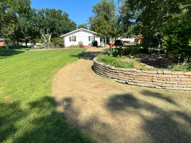

41% glyphosate on the 5th day after application. Second pic shows when applied with blue dye but I couldn't really see this difference when spraying the green grass.
K31 fescue with about 45 oz/8000sqft of 41% applied with 15 gallons water. (three ounces of 41%/gallon water)
(about 7 1/2 quarts of 41% per acre at this rate) This sounds really strong but then the label calls for 2 ounces of 41%/gallon water/300 sqft. That would be about nine quarts of 41%/acre along with 45 gallons water.
Above rates are several times that recommended in the article below:
