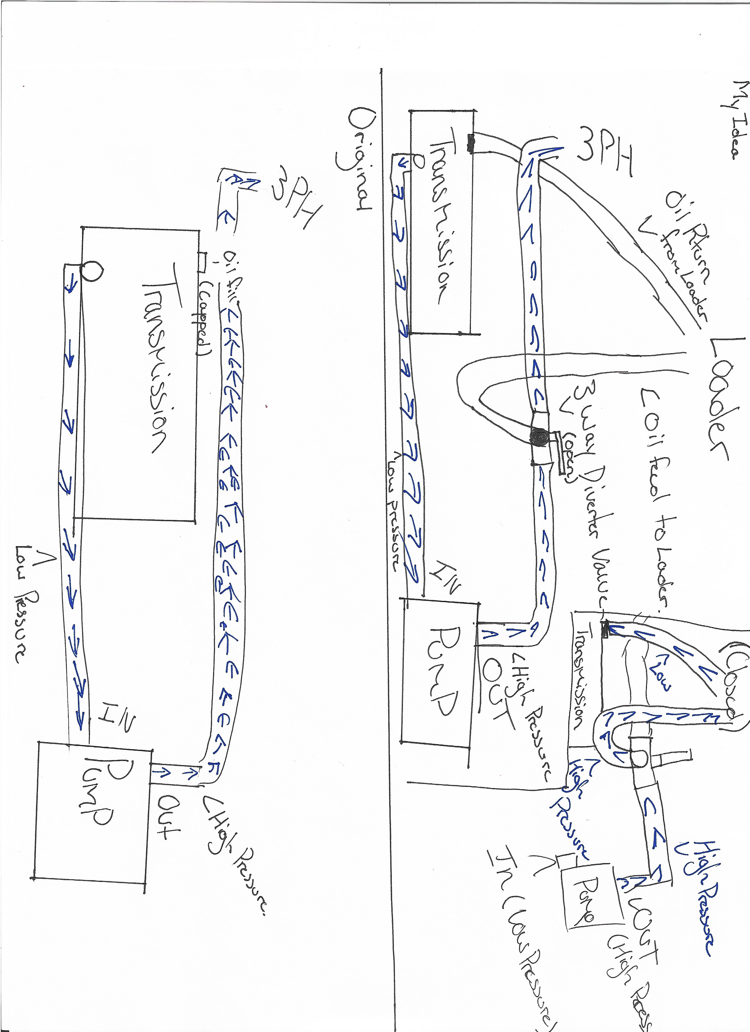

Okay so I just had a thought, If I did this with the lines and got rid of the hard line that is there, ran the new line from the pump where it already connects run it with some kind of diverter valve so if I want the loader I can just turn the valve to allow flow up to the loader controls, then if I need 3ph I turn it the opposite way to allow flow the normal route, for the return I could find the proper thread size, and take out the oil fill into the transmission have it flow straight back into there?
/ Help tapping into HYDRO Kubota b5100
#9
HYDRO Drawings.jpeg This is the idea I sketched up with my understanding it should work, any suggestions? I feel like I am on the right route

No.. Best to forget the diverter valve, less work and money. There are fitting that you can cut the hard line and hook in real easy. There is a good changes you could dead head the pump with a diverter valve.
/ Help tapping into HYDRO Kubota b5100 #12
Yes, let's forget the diverter valve. All it takes is actuating the diverter valve, creating a pressure spike with no where to go and there goes a cracked pump.
And yes, you do need to connect the Tank line of the loader valve to the transmission sump, no matter what route you use. Unless you use a separate pump with a separate tank, then the line connects to that tank.

Your sketch does not show a relief valve before the diverter valve so it is possible you could dead head your pump destroying it.
Your 3 pt hitch is a single acting cylinder so only one line is used. Gravity returns oil to the reservoir to lower the 3 pt hitch.
Start at the outlet of your main hydraulic pump and trace the rigid line as it goes towards the rear of your tractor. Look for any location where the rigid line enters and leaves a rectangular piece of metal.
If you find this take pictures and post them.
If you have that hydraulic block life will be much simpler
