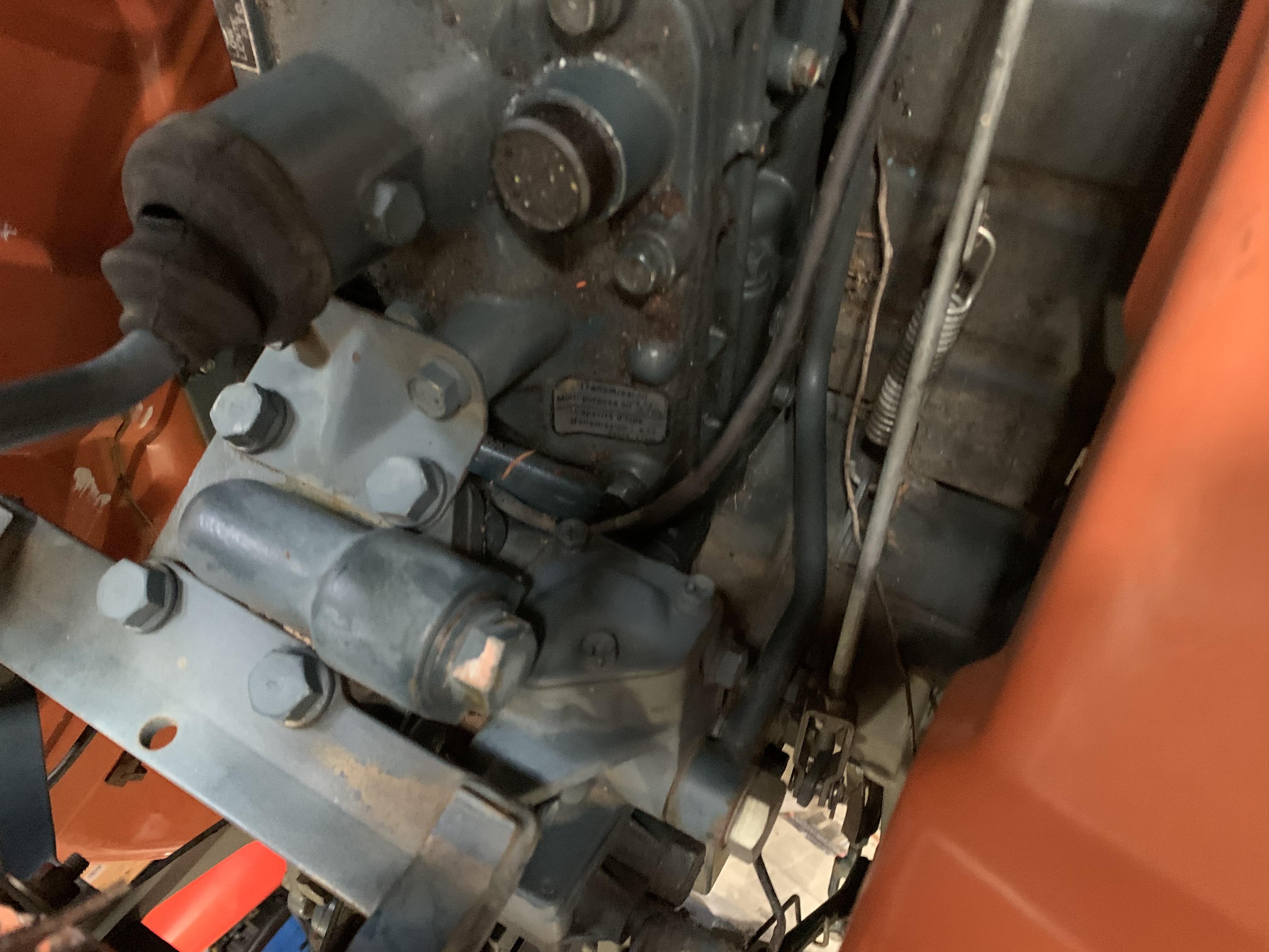

I was looking around and under the seat there is a plug I知 not sure how to describe it, If I tie into that then that could be the source of my high pressure? I saved the photo somewhere I will attach it. They have the stock diverter valve however I do not I will also attach a picture of mine

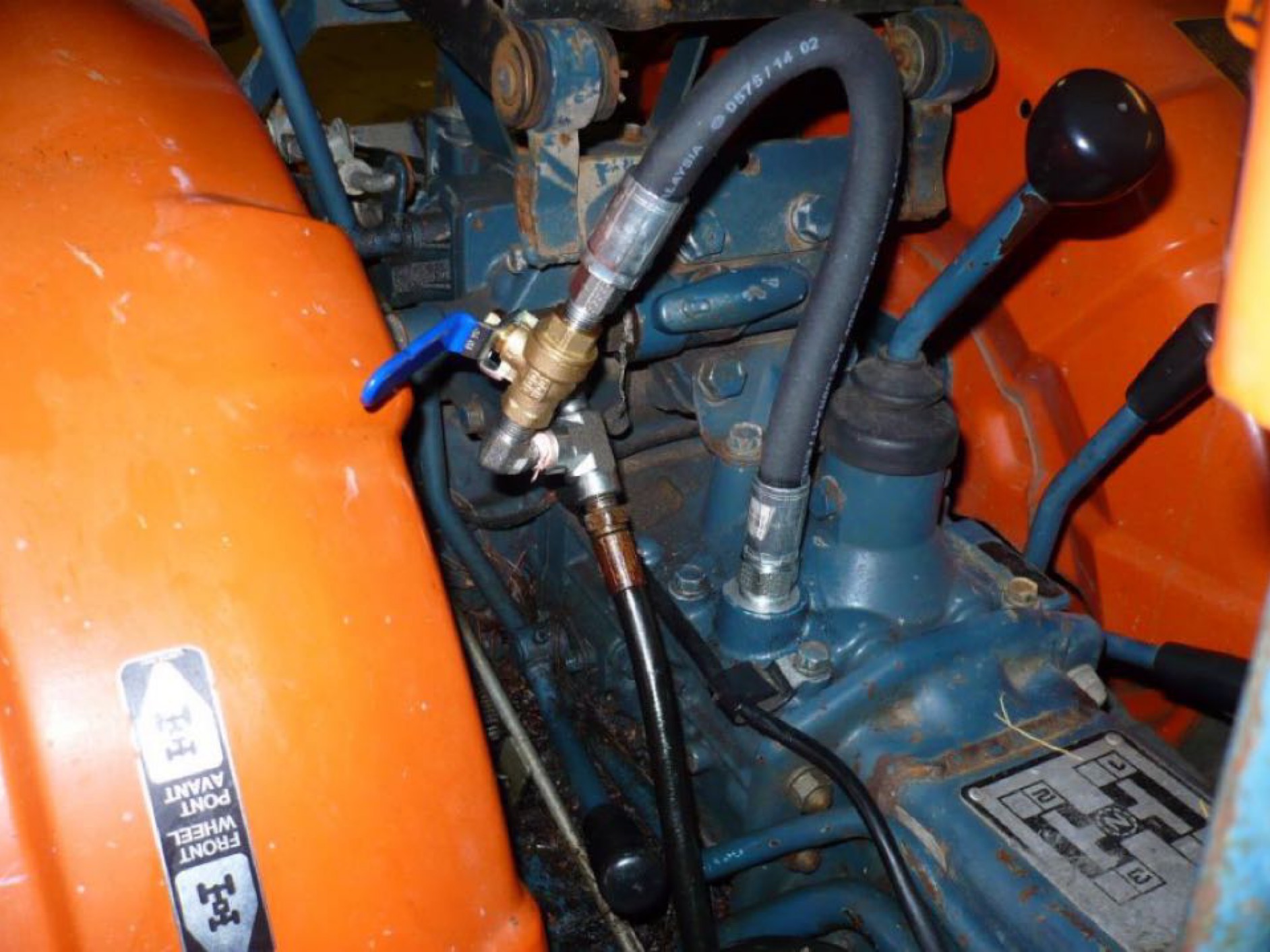

IMG_4747.JPGIMG_4748.JPG So the first one is what I would like to do, the second one is my tractor. I have a plug in the end of the not sure what you call it port I suppose, I cracked it open and it started dripping out with fluid, the return will be as straight forward as the design shown that should function just fine as my return line... I'm not sure if that piece coming from under my seat is pressurized I would assume it is but I could be wrong. Id rather forget the diverter valve as to not risk wrecking my pump. If that piece coming from under the seat is pressurized then my 3 point should still be able to work while the loader is in operation?
My next question I believe PTSG said the pump on the b7000 was 0.122CI what does this mean exactly? when I am looking to get the cylinders and a spool valve what should I be looking for?

1st off where you get that 1st picture? If on TBN give him a PM. By the looks of it he has to unplug the QC to made the point work, but you can't see all of it. BTY it looks as if his plug is still in. One thing you should find out is if the trans and rear end share the same tank. Some older models might not. It also looks like he isn't using the PB port from the loader, just the return port.
If you do end up cutting the pressure hard line go here https://www.discounthydraulichose.com/ and look at 27405 or 27455.

I found that picture on another forum I believe he was having troubles with a front snowplow or something, the Trans and rear end do share the same tank, the sump is located I believe just behind the fill plug. I cracked open the plug that's under my seat and it has pressure I'm not 100% sure what the original purpose was for, I was looking at 1" bore Cylinders I think that they should run smoothly? the tractor should be able to handle that size cylinder I would think.

Start at the outlet of your main hydraulic pump and trace the rigid line as it goes towards the rear of your tractor. Look for any location where the rigid line enters and leaves a rectangular piece of metal.
If you find this take pictures and post them.
If you have that hydraulic block life will be much simpler
