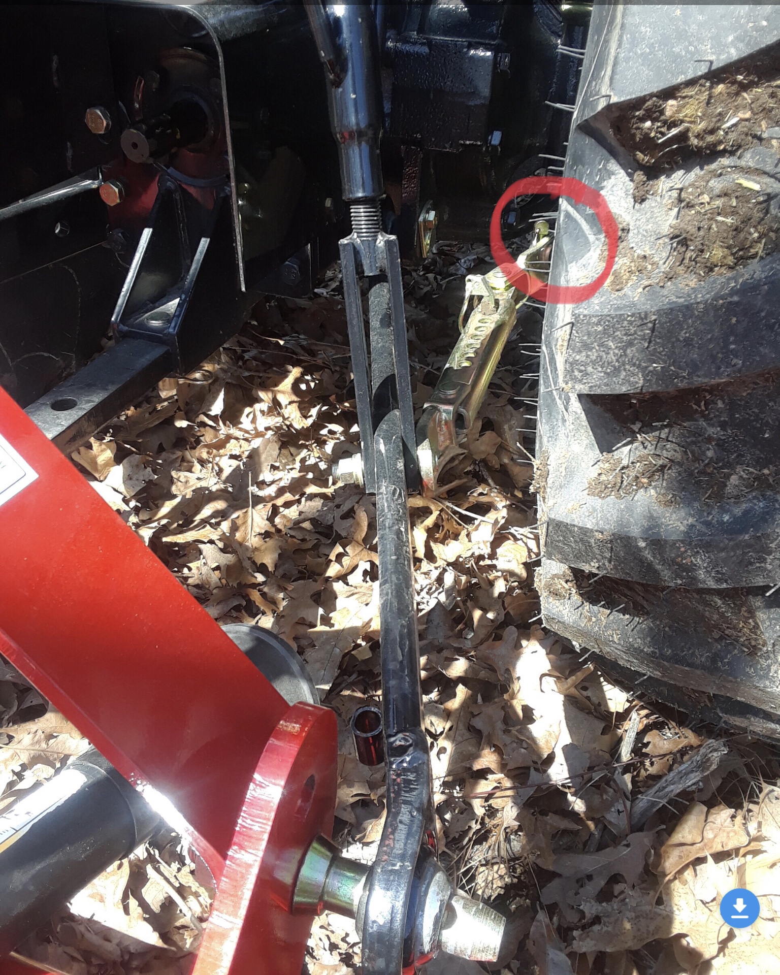

I pulled the stabilizer pins off both sides when I took off the cutter. The picture was a picture just to show everyone my original set up.
   / Help removing a King Kutter rotary cutter #32
So will the arms spread wide enough to clear the pins on both attachments?

It’s a bit hard to tell for sure but isn’t this a clip pin that holds the front stabilizer mount, if so just pull this pin and slide the bar off the front mount to allow the arms to move out farther to hook up. Adjustments.jpg
