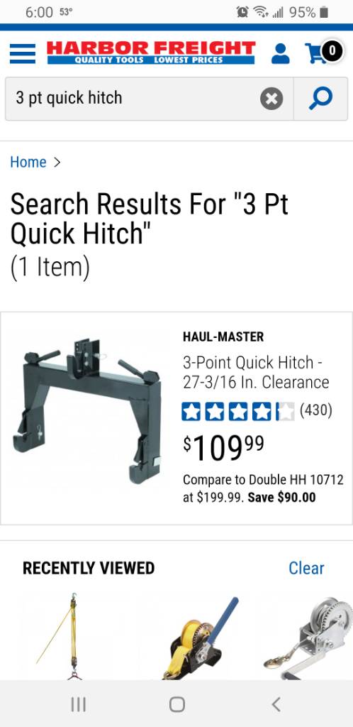

I would definitely recommend that you get a 3 pt quick hitch. It will make using 3 pt implements so much easier and eliminate the strain on your back. Harbor Freight carries them and you can usually get one on sale (or with a coupon) for $78-$89.
As for the mower, I lower the mower on to cinder blocks (one at each corner of the mower) when I take it off. Keeps it off the ground and makes hooking it up and taking it off even easier.Screenshot_20200329-060009_Samsung%20Internet.jpeg

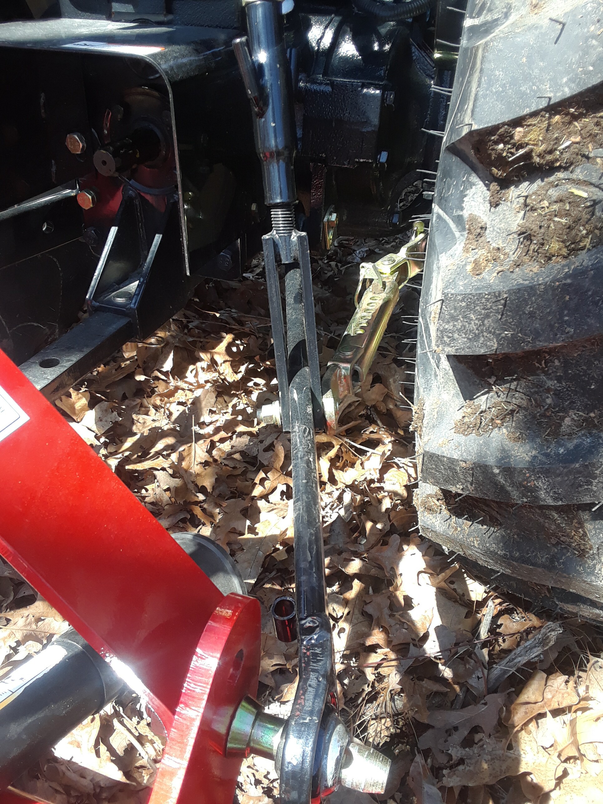

I tried the previous instructions this morning with no luck and did my chores in the barn cleaning manure etc. with it still attached.
Then I lowered the deck to the ground, pulled the PTO, took off the top bar and then took both stabilizer bar pins out from where they attach to the tractor and let them hang. I still cannot get them to move all the way off.

From that picture, it looks like your adjusted all the way “out”. You may have to unbolt the adjustable stabilizers from the lower arms so they can slide off. It’s not a rust problem, that’s for sure :laughing:
Never saw a mower with pins mounted so wide (or a tractor with a narrow adjustability on the lower arms).

"You may have to unbolt the adjustable stabilizers from the lower arms so they can slide off"
I thought about that but wanted to do it the "Proper way" I will go out and do that now. Thanks
/ Help removing a King Kutter rotary cutter #17
Is the other side the same? You can just unbolt one side to get it off , Looks like the links are to long for that tractor....

Taking the bolts out did the trick. It is not the Proper way to do it, but at this point I don't care. Thank you everyone for your guidance. I am an old Case skid loader guy and this is my first tractor so I have a lot to learn. Thanks again and I will probably beg for help putting it back on.
