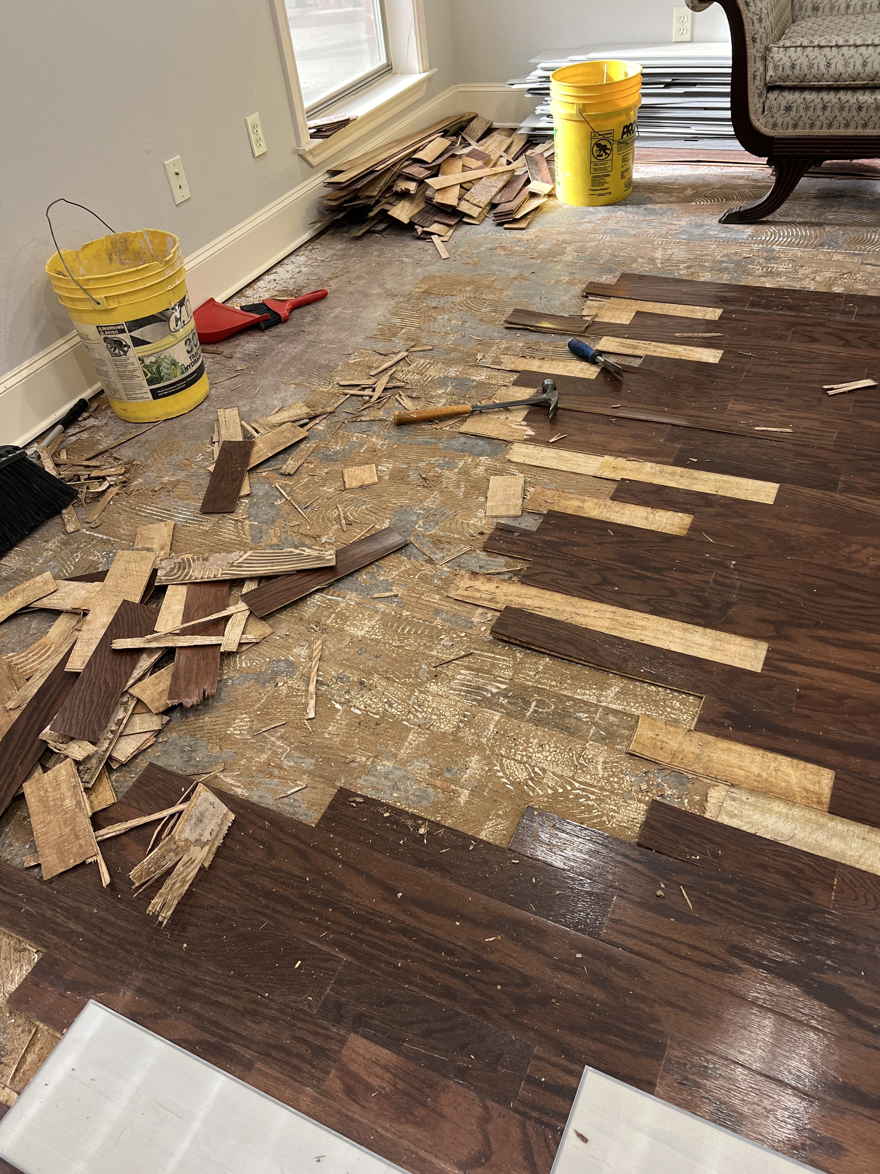

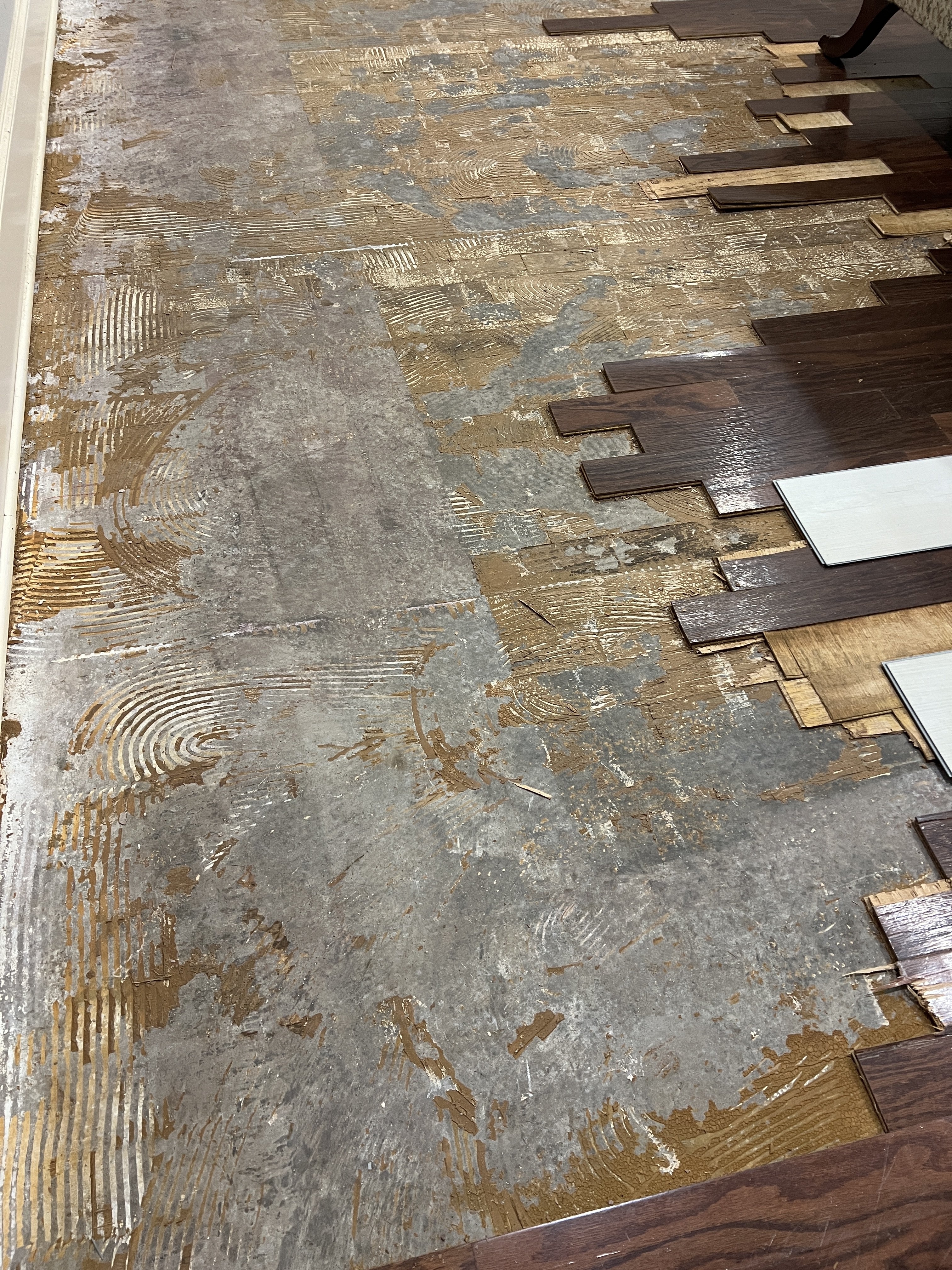

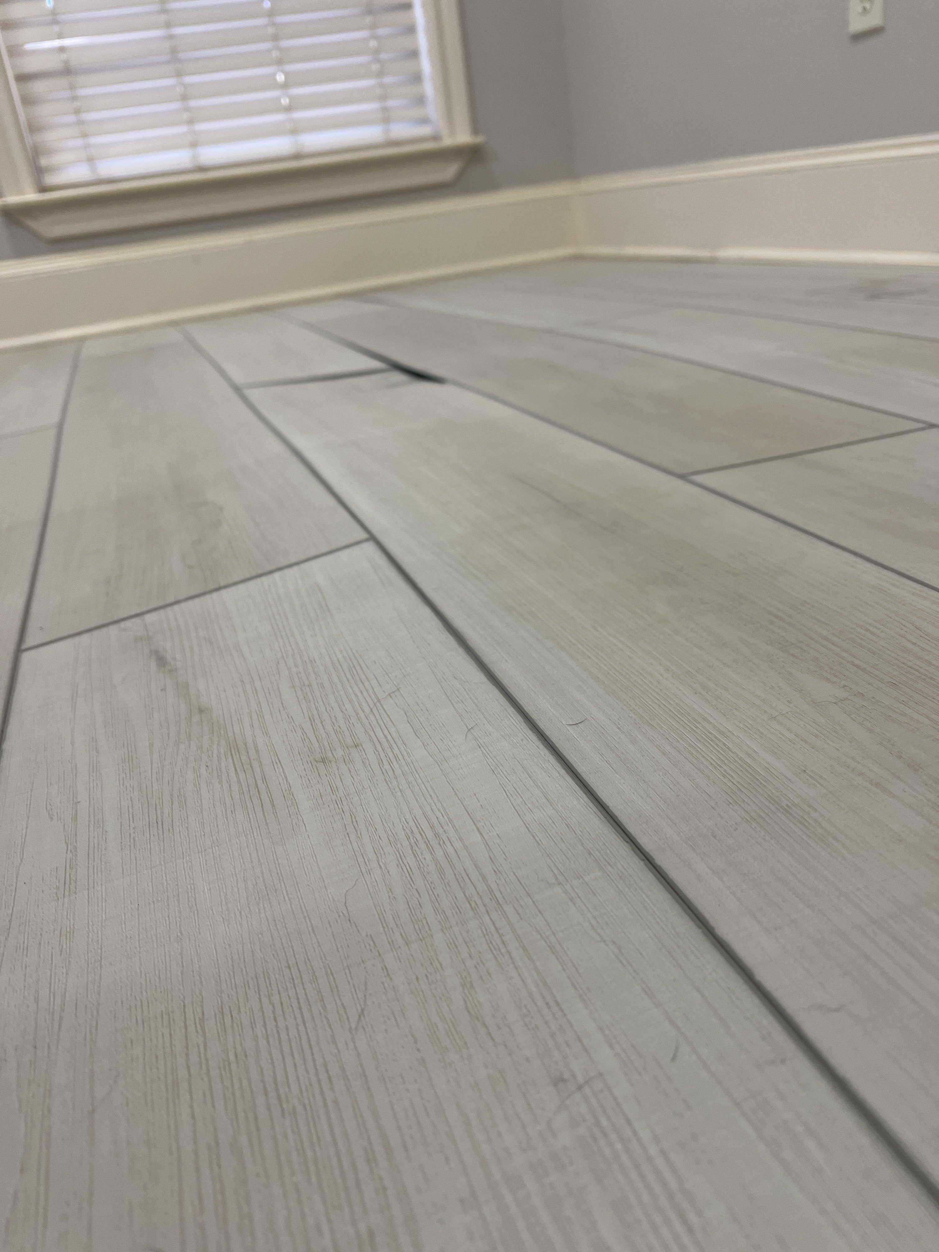

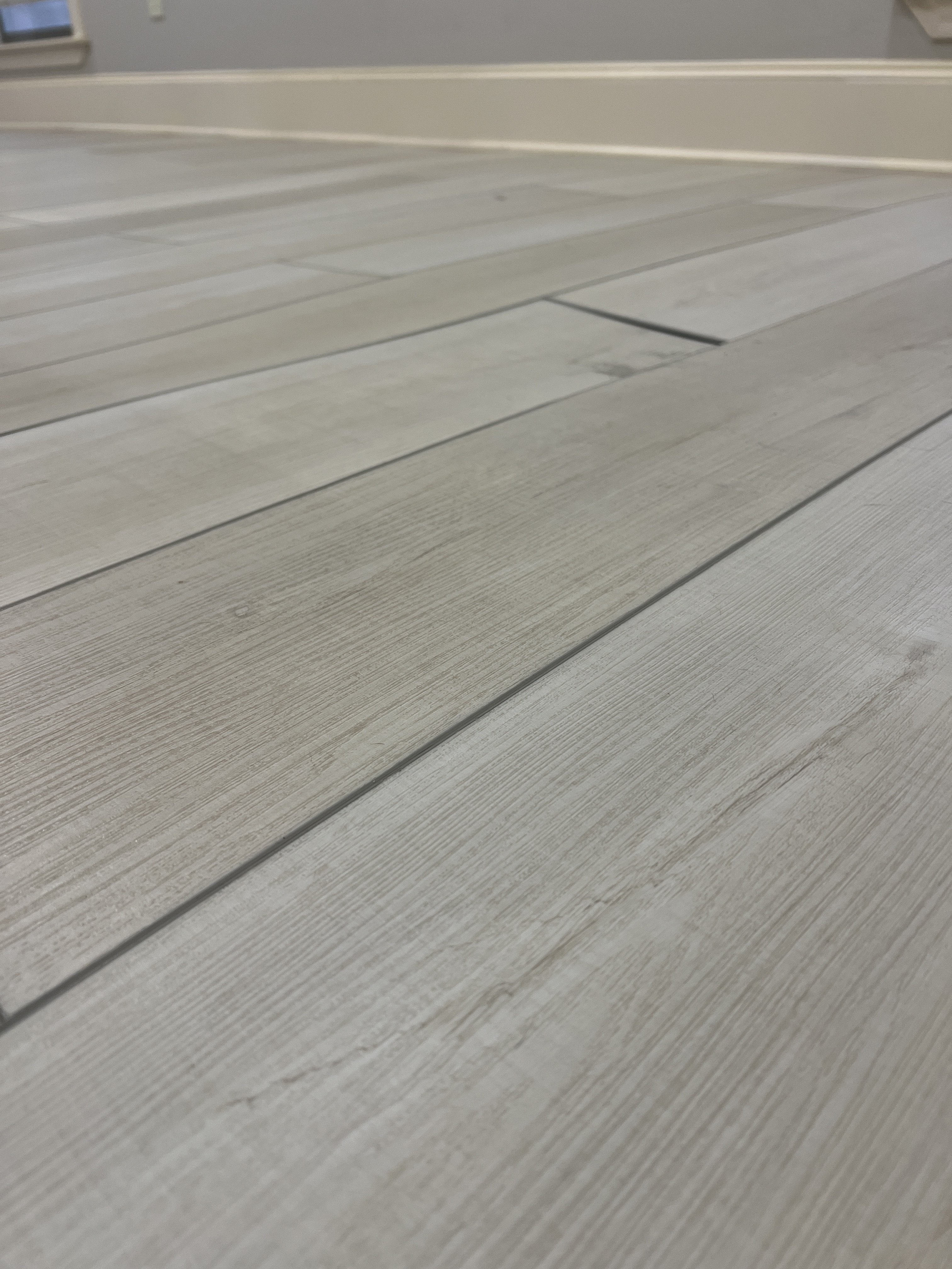

I started a job today for a client with a three year old vinyl floor that is buckling. Under the vinyl planks is engineered wood strips that are glued to the concrete slab. The wood is ten years old. She doesn't know what was on the floor before that. The house is 20 years old.

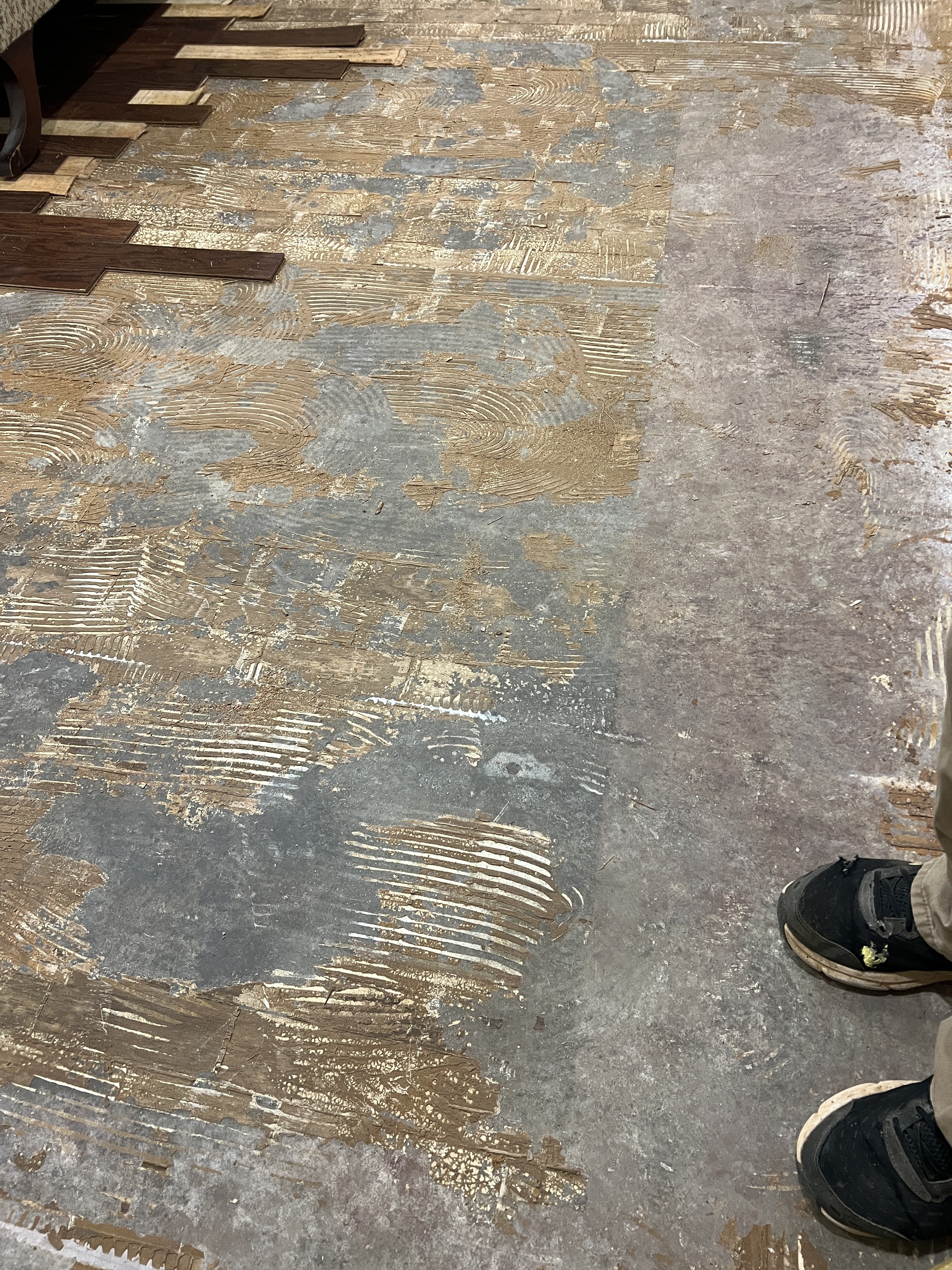

There is no damage or staining anywhere along the walls. The concrete is noticeable lighter and drier looking along the walls. The concrete is perfect. No cracking of any kind.

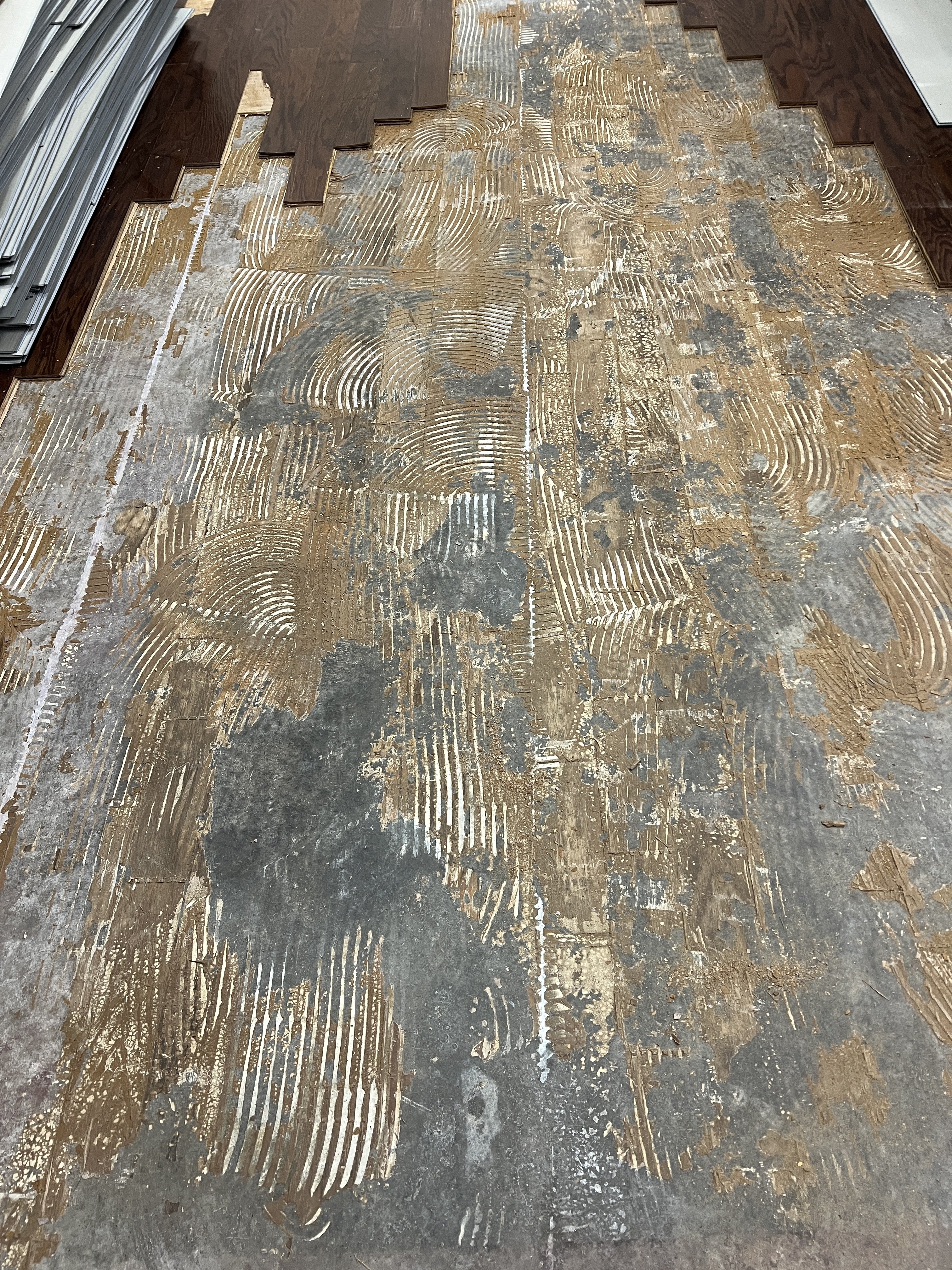

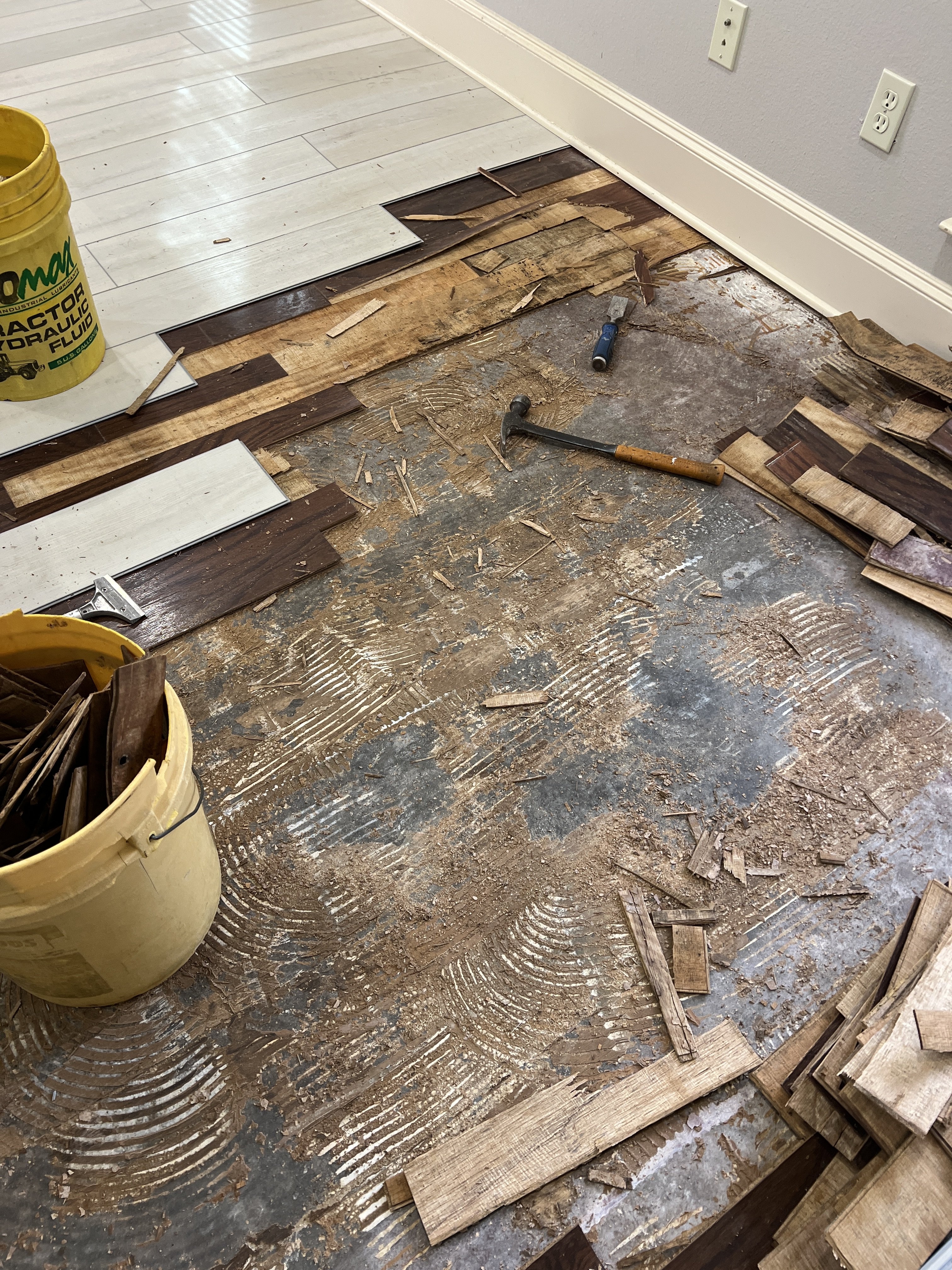

What is really weird is that the concrete is noticeably darker in a perfect square inside the room with a light area all around it, next to the walls. The damaged wood is where the dark concrete is, but no all of that area is damaged wood. The wood by the walls is perfect. Light in color, solid and no sign of mold. The damaged wood is covered in black and white mold. It's falling apart and it smells really bad of mold.
A plumber scoped the drain lines and pressure tested the water lines. He could find no sign of a leak. On the outside wall, the concrete slab is exposed for 4 to 6 inches. There is no sign of a leak or any sign of moisture. The wall with the bathroom has perfect wood flooring for about 2 feet, and for several feet before that, it was minimal coloring on the wood, but not dark and no mold.
The HVAC system is in the attic above this room. There is no sign of a leak along the walls. All sheetrock and baseboards are perfect. Not even a small crack at the seams.
The concrete is dry to the touch. The wood flooring is dry to the touch.

@EddieWalker that sure looks like the damage one gets from rising water vapor, either due to a high local water table, or poor site construction (missing, or poorly installed subsoil membrane, or a poor membrane) or poor site drainage. Given the dry walls, I would be inclined to the barrier being the issue.
Personally, I have seen interior drain systems and treatments, and I am not a fan, but sometimes I think it maybe a viable choice.
A couple of questions;
how is the drainage around the house?
How are the gutters drained?
Are there gardens or lawn up against the house?
If it were my property, I would invest in some serious perimeter drain and sealing, and ensure that the gutters drain into a system that takes the water a good distance away from the house, with a gravel bed with water barrier around the house. I would also use a permeable flooring material. I was part of a renovation of an existing building once, and my prime contractor more or less said "no way, no how" to using a sealed flooring material (epoxy) as he had seen it fail in other buildings nearby. I suspect when the other issues are addressed something other than plastic flooring is warranted.

Put a sheet of clear plastic on the concrete to see if moisture forms between it and the concrete.
Beat me to it, but will add you should tape a square of heavy plastic down, not just lay it on top. Let it sit for a day and then peel it up and check. Maybe do it in a few places in the darker and lighter areas to compare.
Edit: vinyl is notorious in this situation as a major vapor barrier. Which leads back to the earlier point t1kilo and others made: lack of vapor barrier below the slab. So the vinyl acts as that vapor barrier in this case leading to bubbling and other moisture problems.
   / Help needed with a floor issue #10
The clean straight lines around the presumably damp area seems like a clue. I wonder if there is insulation or vapor barrier only under the perimeter? Something is different between the two areas with a very pronounced boundary.
I’d be inclined to bore two holes, one in each location to see what’s down there. Vapor barrier? Insulation? Thickness?

Thank you for all the replies. I've been talking to a few friends with more experience than I have with this and they all said the same thing. It's hydrostatic pressure coming from the soil below the concrete slab.
The solution is to seal the slab with a moisture mitigation system. I'm going to remove the rest of the flooring and glue. Once the concrete is clean, I'll coat it with 2 coats of something like Redgard. I haven't decided on which one I'll use, but all of the polymer sealers are very similar.
Then glue down plywood and install the floating laminate flooring that was already there. She has 5 extra cartons so I should have enough to replace the damaged ones from the moisture.

The entire house is engineered wood flooring glued to the concrete slab with vinyl plank floating over the wood flooring. She wants the floor in the master bedroom to be the same height as the flooring in the hallway and the master bathroom. I don't have a good reason not to put down the plywood and do it like she wants. It's just time and money and the entire job is time and materials.
This is the only place in the house with this issue. It started two years after the vinyl was installed, but it probably started the day it was installed and it took two years to notice it. The issue is in areas of the floor. One really bad area. Two other areas that are a lot smaller.
The coloring change in the concrete with a straight line from dark grey to light grey tells me that the footing is either so thick and wide it's stopping the issue, or they didn't put plastic down there.
Draining under the slab isn't an option.
The outside of the slab is bone dry. Zero indications of a problem. The land around the house if pretty flat, but then it dips down behind the backyard fence. The house was built in 2005.
I think the moisture in the slab was always an issue, but it wasn't noticeable because it came through the wood and evaporated in the room. Or the AC system removed the moisture. Installing the vinyl planking over the wood trapped the moisture in the wood and caused it to warp, fall apart and grow mold.
I think that sealing the concrete floor all the way to the walls will stop the moisture from coming into the room. The concrete is bone dry around the walls, so I don't think the moisture will go out past the sealed floor and under the sill plates, and into the stud framing.
Today I'm hoping to remove the rest of the flooring and get all the glue scraped off of the concrete. If that happens, I'll seal it tomorrow unless somebody suggests a better plan. I haven't tested it. I don't have a tester. I'm going in knowing there is moisture there.
