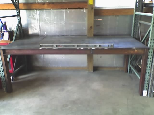

Allrighty. /forums/images/graemlins/grin.gif I had to reluctantly agree that a 1/2" top was too much; too much money! /forums/images/graemlins/frown.gif I just unloaded my materials I went ahead and bought last night. I went with a 4' X 8' top made of 3/8" thick steel plate. That was stinking expensive enough!! I'm framing it with 4" channel (1/4" wall) and I'm going to make a lower shelf with the 2"X3" angle (1/4" wall) I bought. I'm going to make the lower shelf out of 1" plywood with the angle supporting it every 12" or 16".
I have 2 new blades for my chop saw, a spare blade for my portable band saw, a full tank of 75/25 gas for my MIG, and 30 pounds of wire. Hopefully I can make some smoke this weekend and at least get started.
I need to frame a notch in the back side of the table (and the top) to fit around a post in my pole barn so I can put the table where I need it. Framing the notch won't be a problem, but I want to be careful in cutting the notch out of the top. I can't afford to make any mistakes there. I'm thinking of using my portable band saw to cut it in. I need to make a 6" square notch. I don't have a torch that is worth a hoot, and a plasma cutter won't be on the list of items I'll buy until next year. So, it's using a sawsall and portable band saw unless someone can point me a better direction?!

I've had a lot of luck with a 4 1/2 " grinder with cutoff blades, just start on the edge and work inward. When you get to the crosscut, just do a slow plunge cut till you get as close to the edges of the other cuts, then use your saw to cut the last bits.
Seems to be quite a bit faster than a saw, and easier to control for a straight cut, especally in 3/8 " thick material. Should be a great bench when you're done, post some pics as it comes together!
You sure you can't just notch the post? /forums/images/graemlins/cool.gif

Okay, I got my welding table mostly done this weekend. I haven't made it all perty and painted it or anything yet, but it is in place and, surprisingly enough, all four legs sit firmly on the ground. Since the table weighs in at just under 750 pounds, you can imagine that it doesn't wobble much. Here is a pic I took with my phone. There is a level on the top of the table. You can't see it in this pic, but the bubble is dead center of the marks. /forums/images/graemlins/cool.gif I was going to make a setup to level the legs, but it ended up sitting perfectly level without them. I won't complain!
