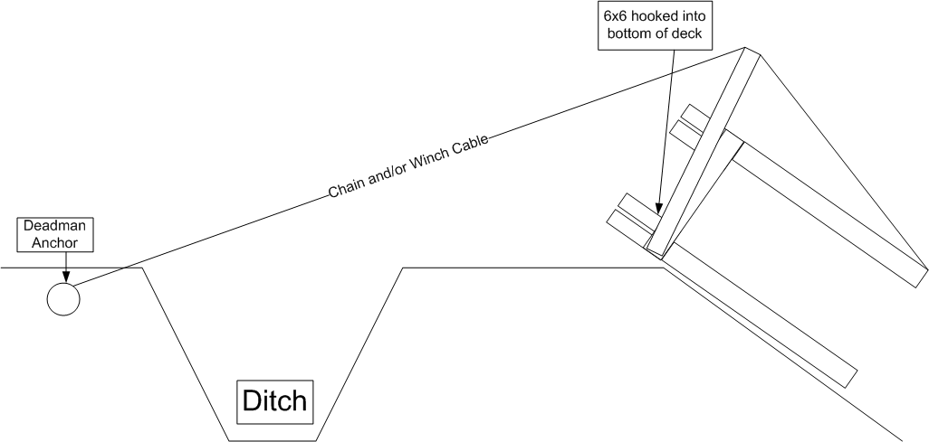

There's a large ditch on that side. There's really no room there. Nowhere to pull from and nothing solid to winch to.
No chance of parking a vehicle on the other side of the ditch and using it as an anchor? I mean, that's fairly obvious so you've probably thought of it, just trying to exhaust all the possibilities. What about a snatch block on a tree on the far side of the ditch to redirect the pull of a tractor on the near side?

Would it be possible to dig in a deadman anchor on the other side of the ditch to winch the upper wing back over with? See: Land Rover - 4x4 Off Road Vehicle Recovery and Winching - How to Dig a Deadman Anchor for some examples.
To get better leverage, you might try using a "tower" to help put your force to better use as seen in the diagram below:
If you cant get it out on your own, how bad is the road? Would it be possible to bring in a rotator boom wrecker or a small crane to pick it up?
If a regular truck cant make it in, you might try the guys over at SteelSoldiers.com and see if there is someone near you with a wrecker (like this one: M936 6x6 5 Ton Military Wrecker - YouTube or this one: M816 6x6 5 Ton Military Wrecker Truck - YouTube ) who could give you a hand
