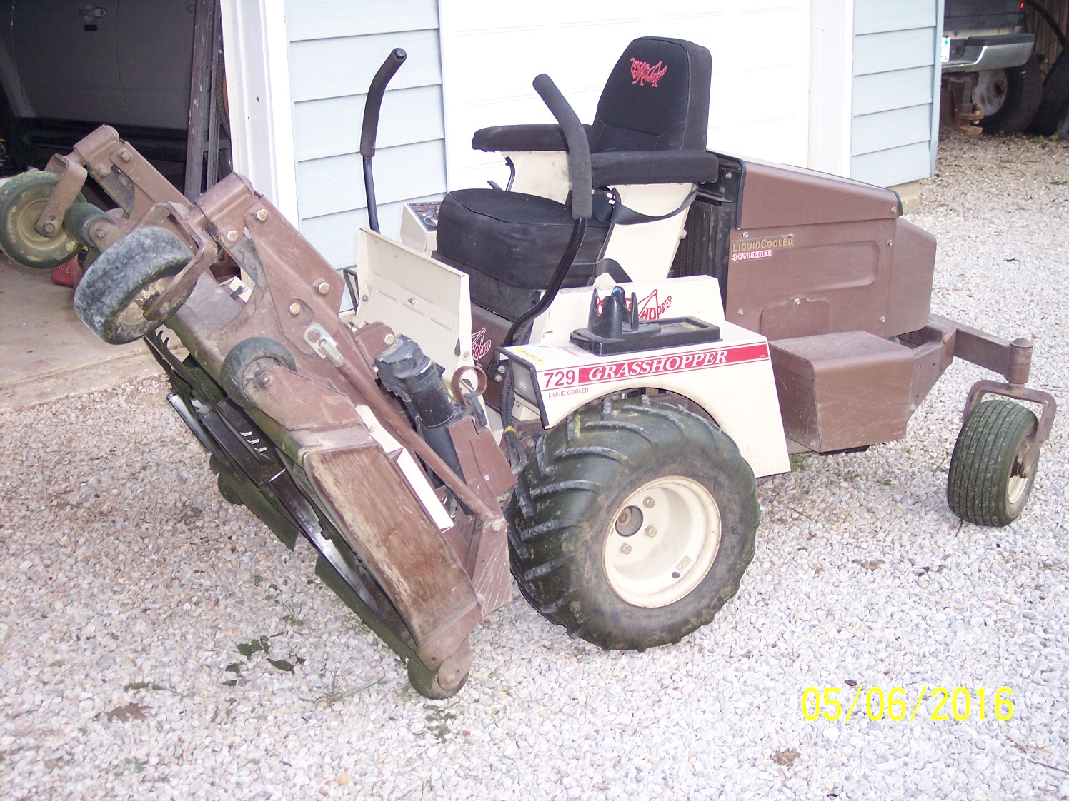

It’s a 428D which is a midmount not a front mount. $500 is way less than market value. I was at a TWRA owned gun range and saw the grasshopper behind the shop with 2 foot tall grass around it. I found the guy in charge and asked about it. He said he was going to sell it to a dealership for $500 but you can have it for $500. The grasshopper had been in service about 10 years and they bought a new Hustler. The deck doesn’t handle hills as well as my small deck but it does pretty good. The deck has a lot of overhang and it’s possible to mow between most things that are narrower than it is. I mow 2 big yards with several acres and the time savings is considerable. It’s every bit of 50 percent faster than my Dixie chopper or MMM. And the fuel bill is less than the Dixie chopper.

Some ZTRs hold a hill better than others my grasshopper is a hill mowing beast. I’d guess it it would do even better with some bar tires. There’s no way a compact tractor or a garden tractor could compete with it unless you like mowing on its side. My Dixie chopper is probably comparable to a regular garden tractor on hills. I’ve climbed some pretty bad hills and the front of my zero turn has never picked up. My Dixie chopper with bar tires will out mud a 2wd garden tractor. BTW I have a B7200 with a finish mower and a MMM. It goes in mud a lot better and can lift the finish mower higher off the ground so I use it for rough mowing. And the B7200 is tough as nails. It’ll take pretty much any level of abuse. Aside from that it stays in the barn while my ZTRs do the mowing.

This mower does just fine on slopes.View attachment 556672
Those things are probably in the range of real slope mowers. I’d bet money on a compact tractor, lawn tractor, and especially a sub compact tractor being on its side before the front mount Grasshopper gives up. In like to trade my F series Kubota for one of those. If anyone was wondering I have a lot of mowers.
