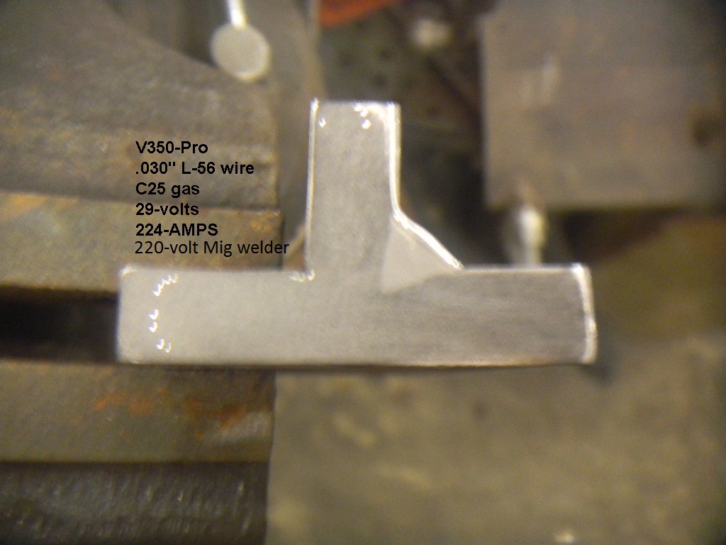

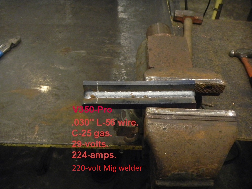

J.Wal when Mig welding anything that can receive impact. You want a Mig welder with power! When Mig welding, you want to run as hot as you can, and still be able to control the puddle.

Great arc characteristics, 110v and 240v screw on plugs are quick and convenient, good amount of power at 230 amps. (Super Arc's famous pic is at 224 amps, no beveling). Build with Blue rebates and free accessory is another plus.
If you get in to heavy material, proper joint beveling, pre-heat, 0.030 wire, slow travel speed, and hot welds will ensure proper fusion. And if you are really worried, run another pass or two on top of it. Can't see you welding anything that heavy though. But there are options if you ever go down that road.
