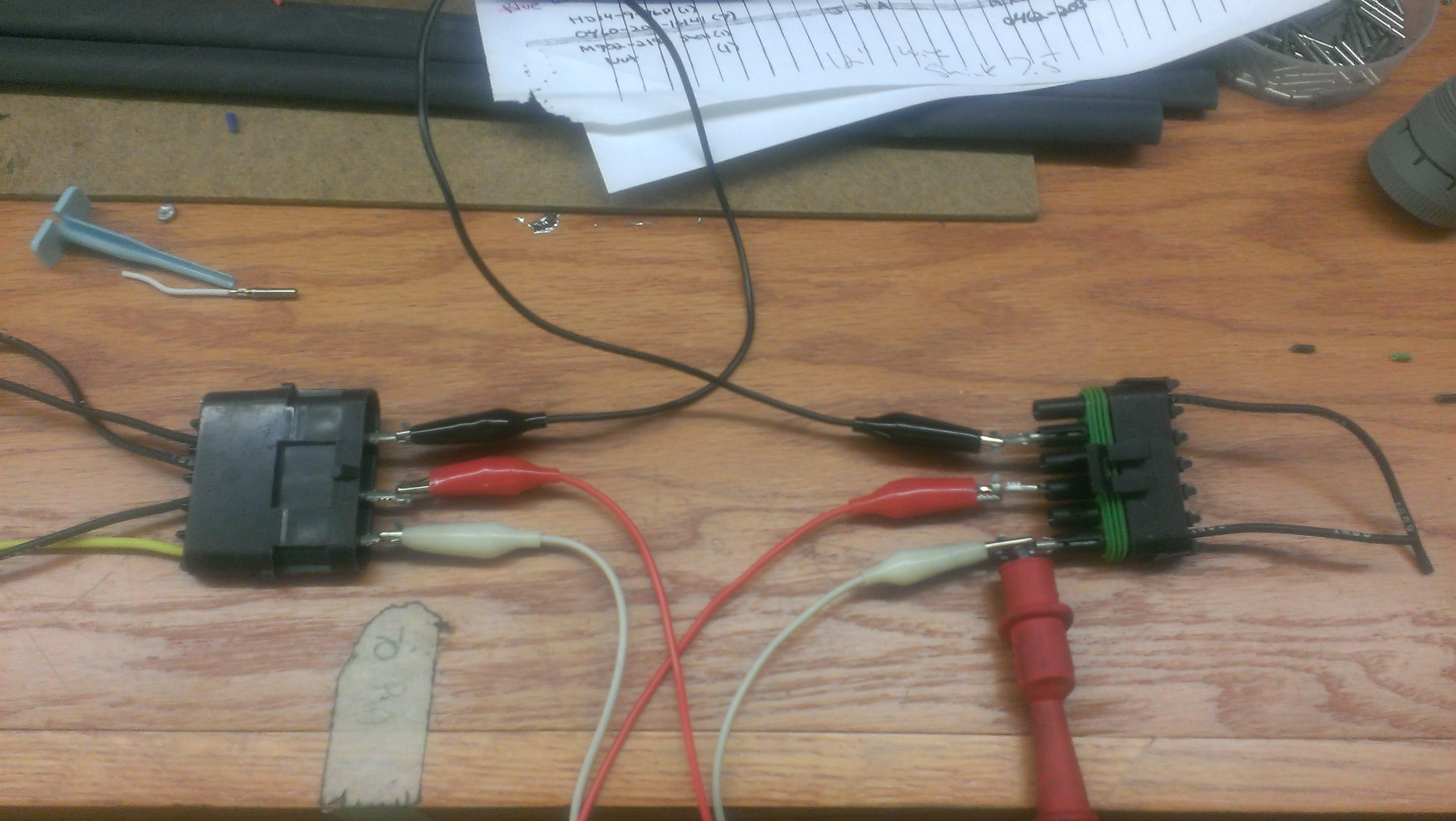

Jumpers shown, x3, easy to make up, and allows testing and/or Jumpers while things are hooked up properly. Any auto parts store or hardware store would have the crimp on ends shown, take your solinoid with you to get the right size blade male/female ends. Install jumpers between factory connectors, make double sure you keep them going to the matching positions.

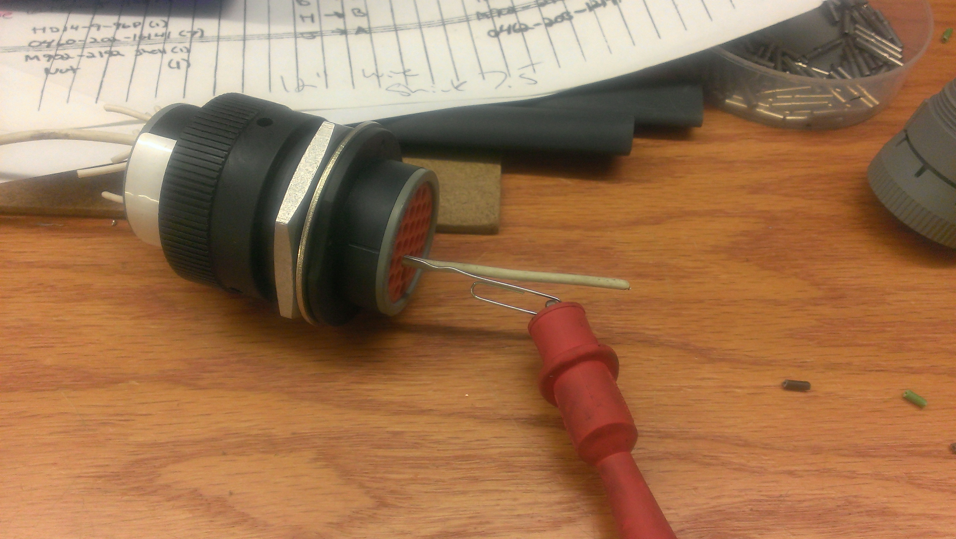

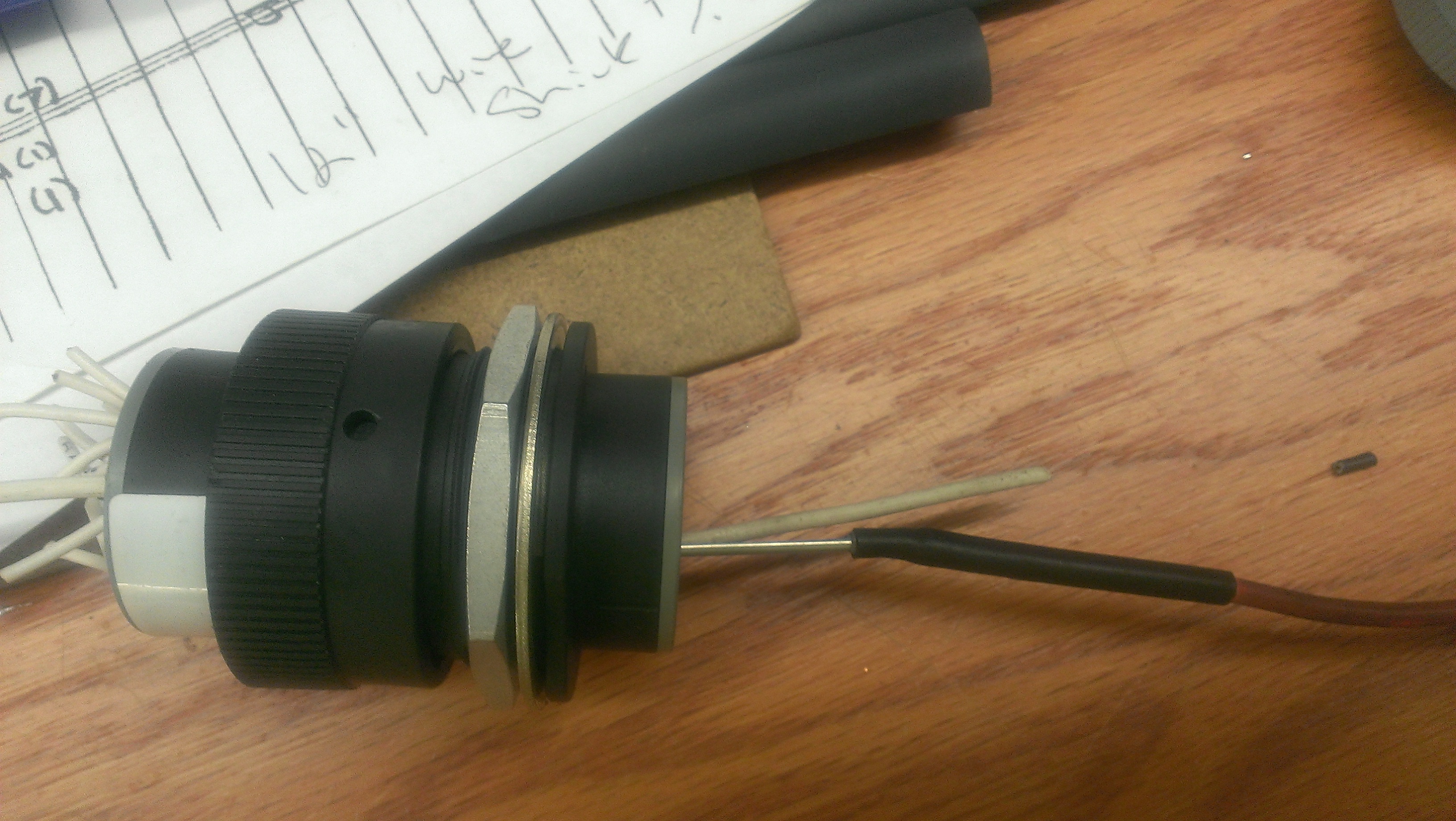

Can you back probe the connector?
This is using a Cat Spoon (7x-1710) it is dished and follows the wire to where you can touch the pin inside.
chances are you don't have the fancy cat spoon. this is what i am talking about with paper clip like wire.
Now if your plug looks like this you are not going to be able to back probe.
I believe diesel crawler is talking about doing something like this.
Back probing will give you the best reading as the voltage drop could be in the plug.
If you can back probe,
One end of the meter goes to ground at the battery!, make sure you have good connection. back probe each wire and tell me what the readings are.

Now if you end up doing the last Picture. Which is the jumpers between the connectors, make sure you use an 18 awg wire. To small it will get hot and throw your readings off. In a nut shell you will make same readings as above. However, I would take the wire that you have going from the positive at the battery, once again making sure this wire is 18 awg at least. Disconnect the jumper going to the pull in winding, on the vehicle harness side and with the hold in powered up send 12 volts to the pull in. Based on what you have said above it should pull in as it sounds to me like you have a voltage drop on the pull inside of the coil wiring. Which is typical.

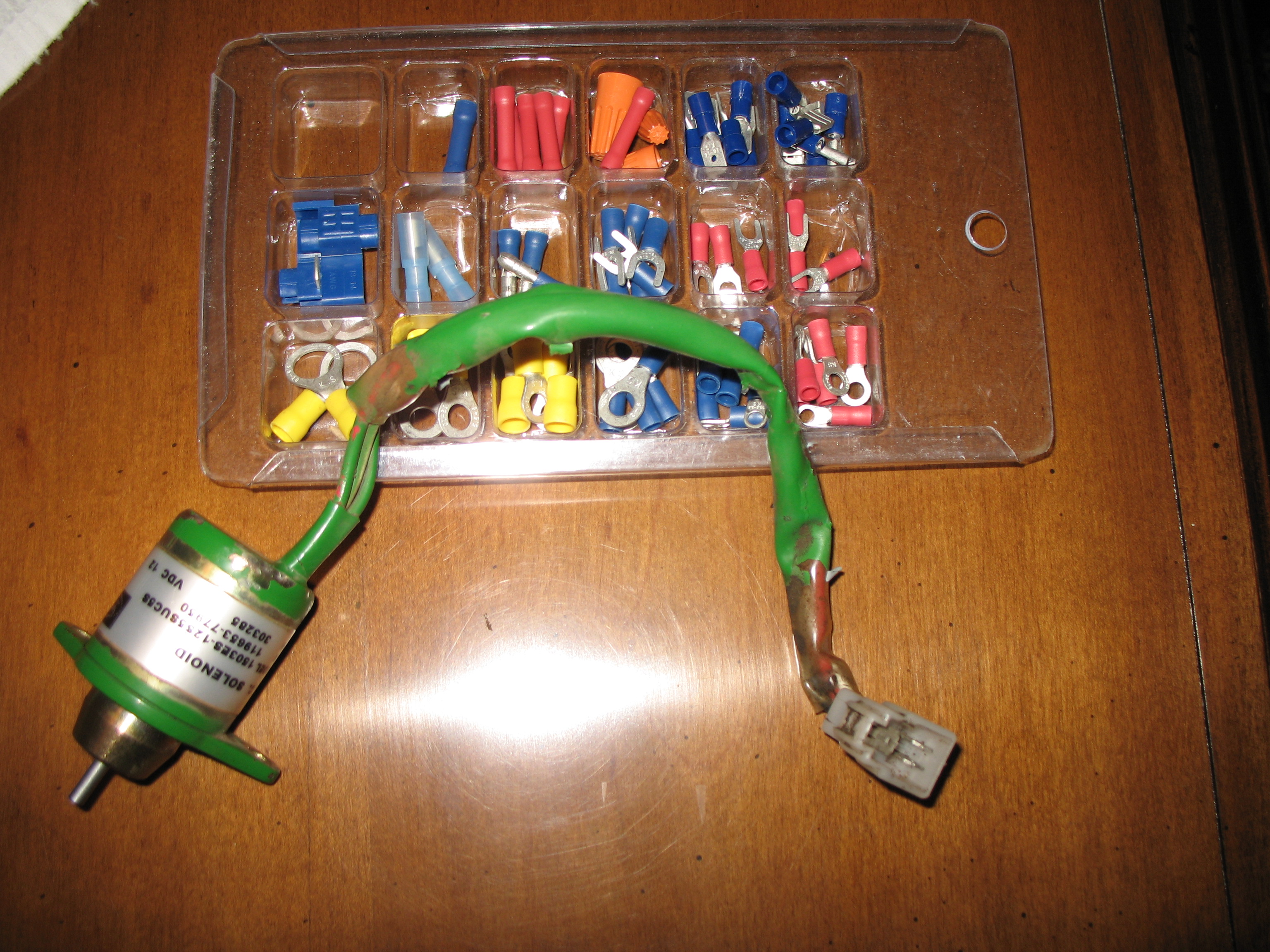

dieselcrawler, Got delayed with the Wallpaper prep, turned out to be (78) individual lengths and counting........so, didn't make it to HDepot but I found that I had an old kit of Terminals. For those down the line reading this thread, the terminals to make the jumpers (shown in the upper right corner of the attached PIC) are: Female Quick Disconnect 16-14 AWG Size 1/4" and Make Quick Disconnect, 16-14 AWG, size 1/4". I still have about 3 hours of Wallpaper chores to get done this morning then back to Testing. Understand (1) Additional Jumper for another Ground..........

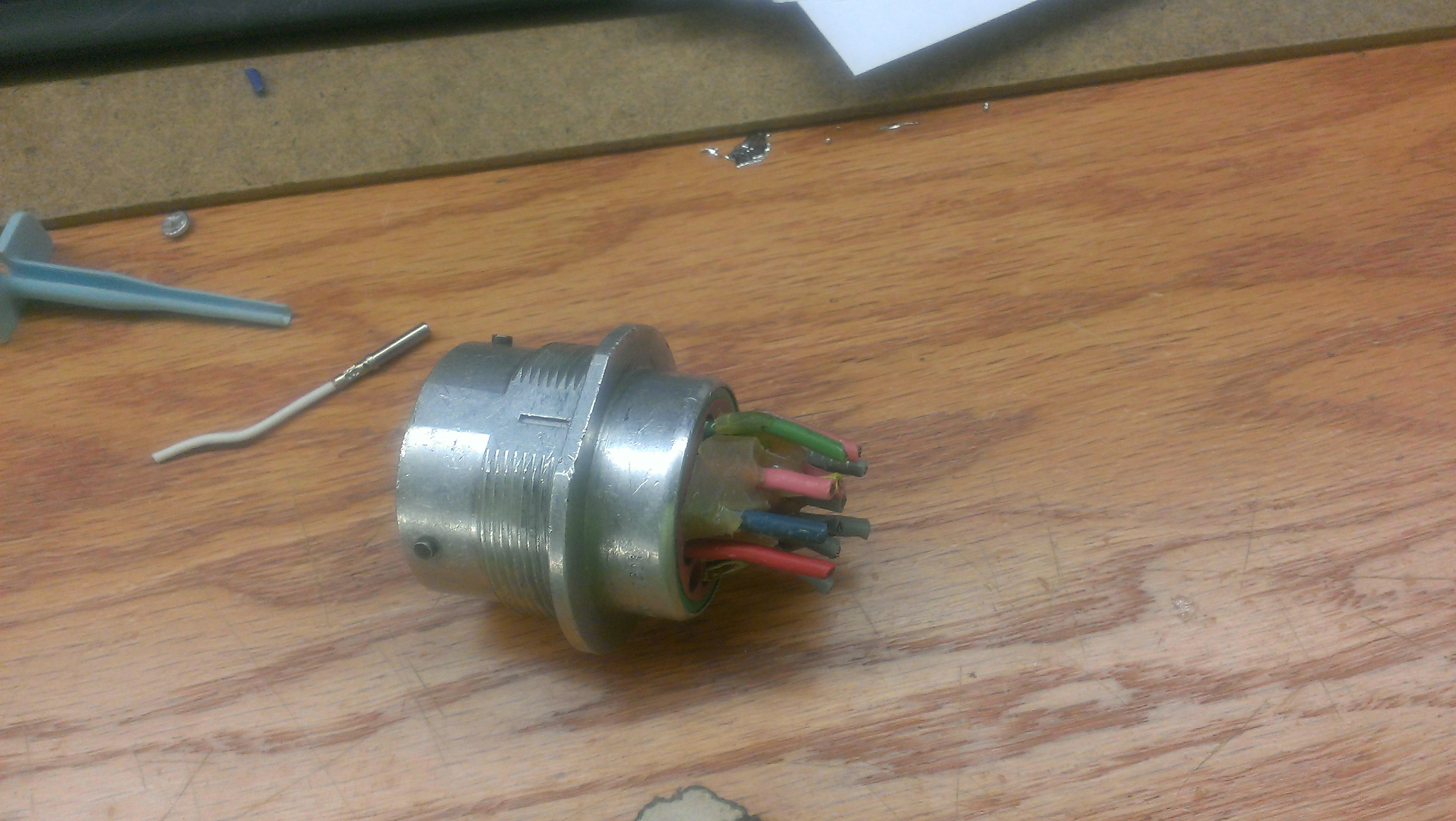

Zebreafive, truckdiagnostics - Once I get the jumpers fabricated then I'll do the testing you suggest............truckdiagnostics, I've attached a PIC of the connector types used on the 790's Wiring Harness.
