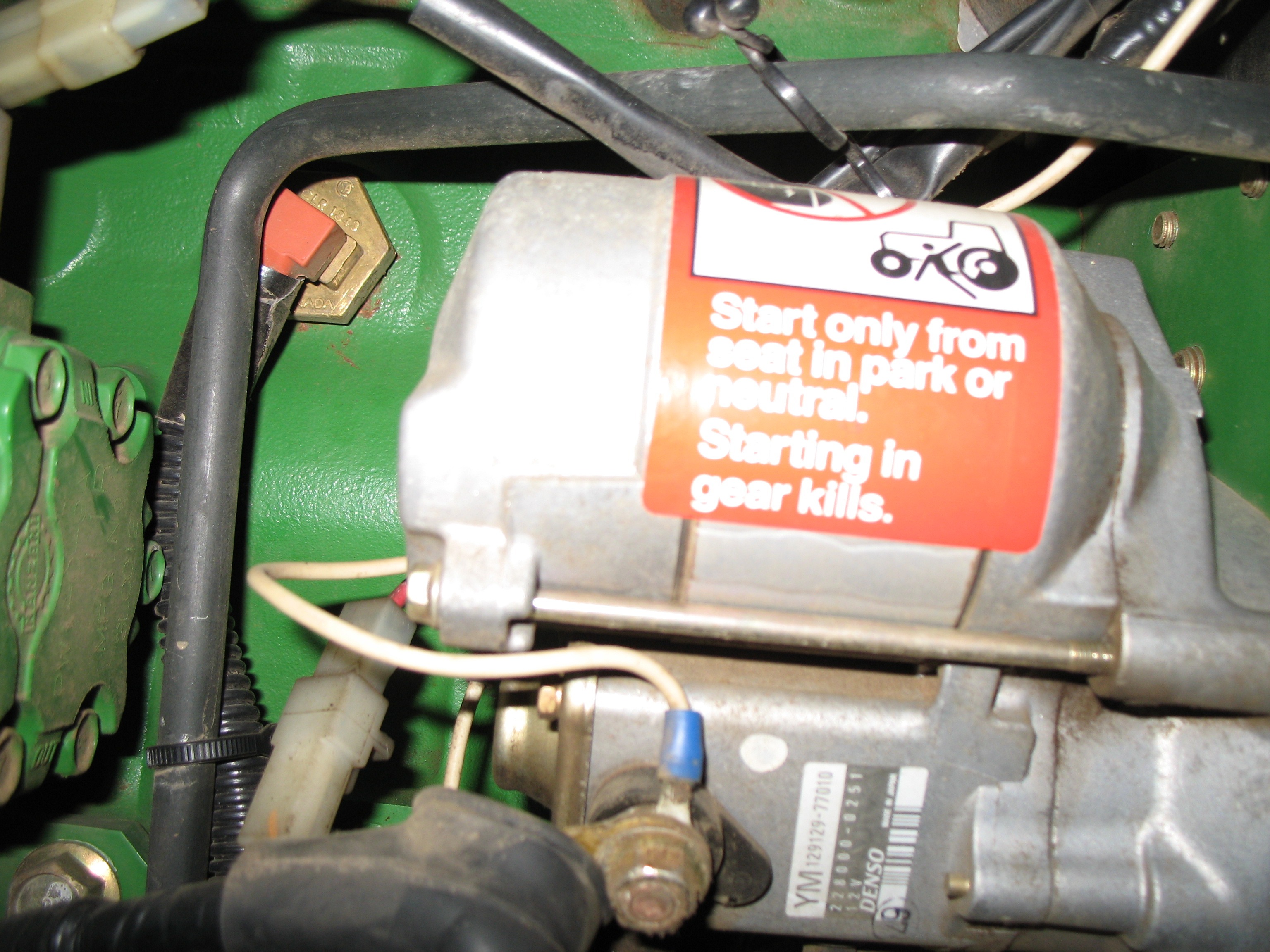

Zebrafive, I did the "meter across the battery" A-OK, 12-13 volts. Performed the "confirming the black wire to ground is not broken" A-OK 12-13 volts. Performed the ""hold in" coil of the FS" A-OK, 12-13 volts.
Now I'm at the juncture, visual check of Solenoid plunger or continue down the FD/FI Procedures you outlined. Since I have the Solenoid removed I want to first disable the starter. In a previous post, dieselcrawler recommended to remove the white wire from the starter, again, just to be sure I've attached a PIC of what I believe he is referring to. Once removed the starter will not spin with the ignition key set to position "START"......
Once I get confirmation on the White Wire (pictured) I will remove it then take your FD/FI Measurements to make sure the GAA-ZINS are coming in right to the harness and the Time Delay Module has not fail (Red Wire Test). If all is A-OK then I'll replug the solenoid into the harness connector and proceed with visual observation.....
QUESTION: Is there something special I should be looking for with the plunger retraction..... If that operates OK then maybe the gurgling I described with visible oil around the plunger shaft as I push it in indicates the solenoid is in trouble.

The white wire with the blue stakon looks like it's (1) not factory, and (2) hooked up to the battery cable terminal.
That is likely not the white I was referring to, but will check mine asap, and let you know.
/ Help Interpreting Wiring Diagram & Using Multimeter #12
I got a close look at my tractor tonight... and a picture. I've marked the white wire from your picture in yellow, it is the feed to the tractor electrical system. Mine is moulded into the battery cable, yours has the blue stakon (crimp-on wire connector, ring type in this case). I want to point out the connector at the bottom of the starter, circled in red. This is the starter trigger wire, disconnecting it will disable the starter. Mine has a male/female blade type with plastic cover connection in the wire a few inches back, follow the blue line in my picture.

I would remove K-1 Starter relay to disable the starter. As others noted the white wire to the starter with the blue crimped on terminal looks like someone picked up 12 volts from the battery at that point. There is another white "trigger" wire for the starter, but pulling the K-1 starter relay will do the same as removing the correct white wire.
