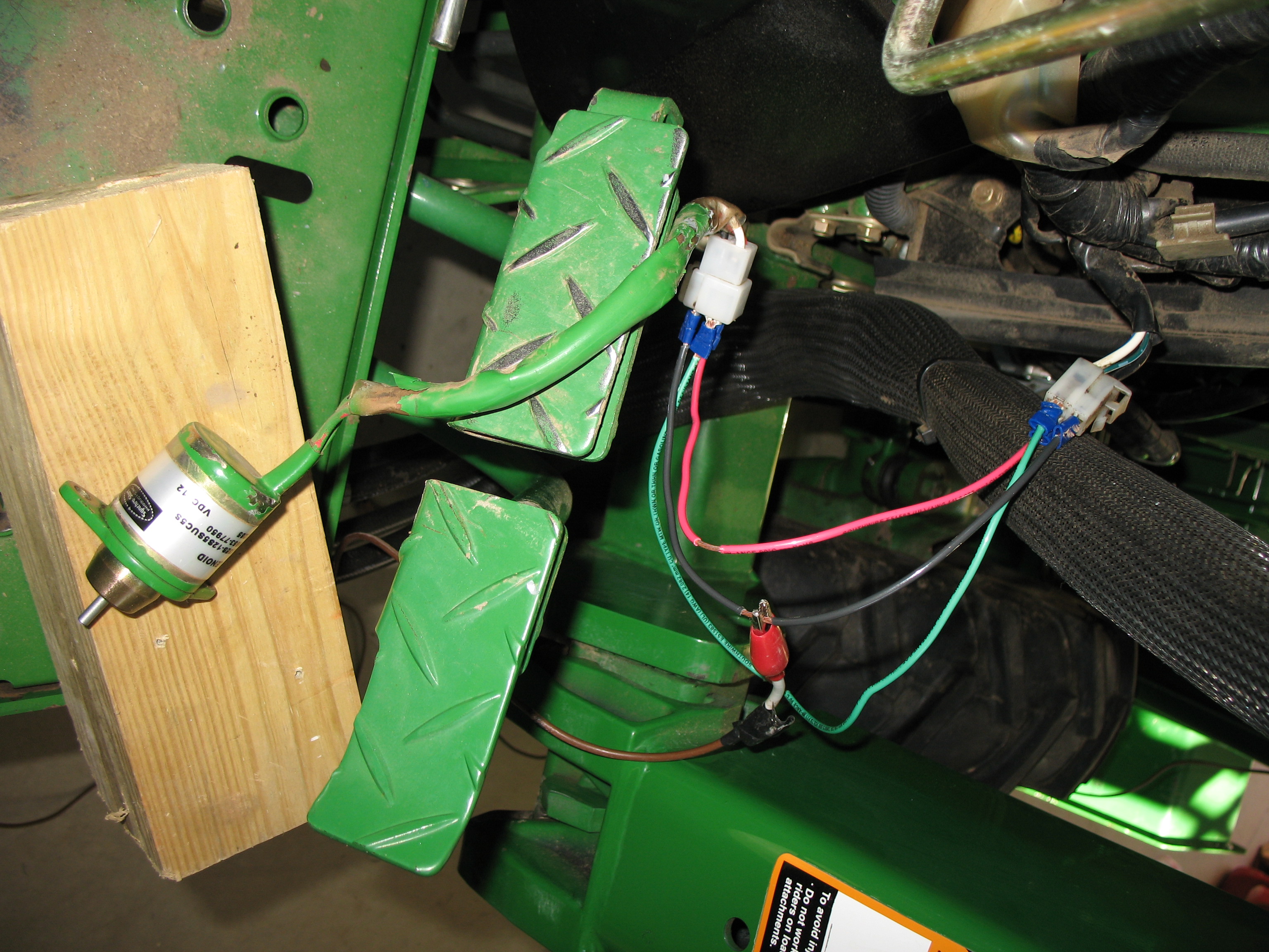

Finally Back to the Tractor..........This is Leaf Peepers time of the year here in NH and some unexpected visitors, our doors are open to friends and family but notice would be nice.....enough on that delay.....
In any event I'm back on-line, the attached PIC shows the (3) jumpers (couldn't get white jacket wire so using GRN). Jumpers between Connector X5 on Solenoid to Wiring Diagram 651 Wht/Blu , 658 Grn/Wht & 115 Blk. Jumper wire GRN connecting X5 Wht & 651 Wht/Blu, Jumper Wire RED connecting X5 RED to 658 Grn/Wht and lastly Jumper Wire BLK connecting X5 115 Blk. I have another long jumper going to Battery Ground and connecting to Jumper BLK with Alligator Clip. AT Ignition RUN Position - Nothing, AT Start - Nothing. Thought perhaps with the direct ground to battery might get something.
If you remember during our last testing, I took dieselcrawler's recommendation to simultaneously jump Solenoid Wht & Red from Battery positive while Solenoid Blk connected to battery ground. That was only instance causing the Solenoid to retract.

So you have proven that tge solinoid does work. You have a wiring issue.
Nice job on the jumpers, exactly what i was picturing.

Hiiimmm, Started going back thru Z5's testing. Disconnected Jumpers to Solenoid, Multimeter Test leads stuck-in X5 connector on Wiring Harness side, BLK on 115 BLK.......... 658 Grn/Wht = GOOD 12V, 651 Wht/Blu GOOD, 12V for couple of seconds. Connected Jumpers to check continuity on harness side, A-OK.....Connected Jumpers to Solenoid 658 Grn/Wht = GOOD 12V reading on jumper bare wire, 651 Wht/Blu = NO VOLTAGE jumper bare wire.
