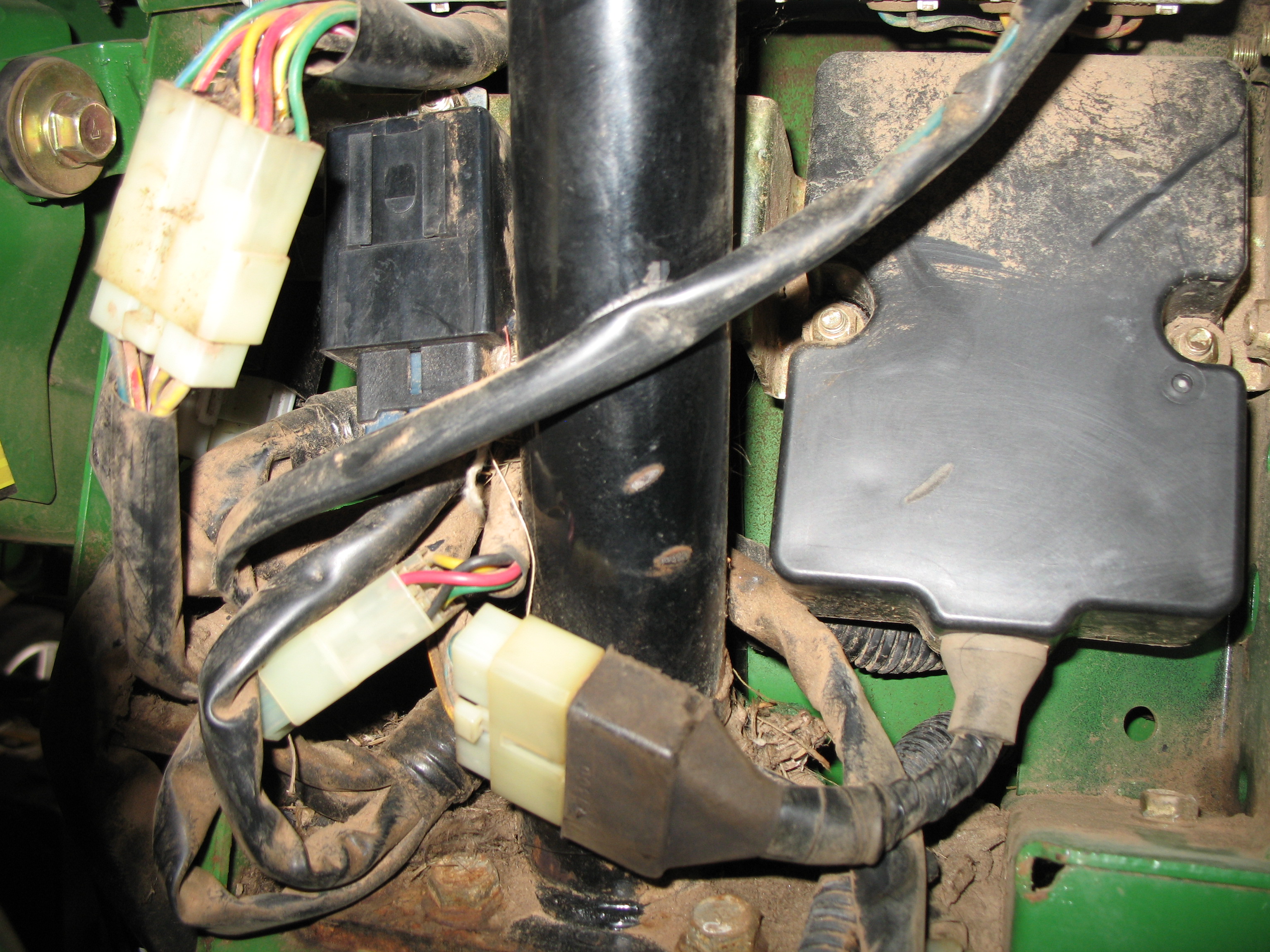

Progress for today - CRITTER STUFF !!!! Removed plastic shroud below Instrument Panel (PIC 7105) and found that cavity filled with Typical Rat Poison Green Granules, Straw, Bunches of chewed material looking like that ground insulation...... Anyway, vacuumed it out (PIC 7113) and that Oklahoma Clay where I purchased the 790 still abound but I can plainly see the A1 Time Delay Control Module to the UPPER right. No chew marks on wire or connectors at first glance (hope that thought remains after tomorrow), looks like the critter had a smorgasbord of things to munch-on instead. Tomorrow I'll have to sort out (tracing wire colors) to locate the K2 Fuel Relay, K1 Start Relay. I suspect they're above the opening, but then again maybe not..........:reading:

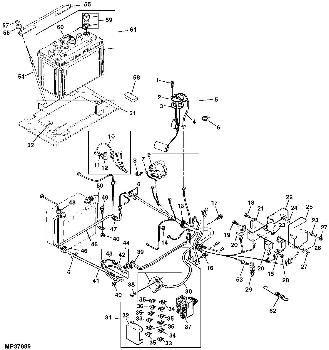

My guess is since parts shows TWO key 20 relays, one is starter, the other fuel. You might be able to ID them by their wire colors on their connectors.
Aaaa-Haaa, the old quantity of (2) with a general description in the RMKS routine........Wow, I'd say pretty sloppy for JD Engineers to have done that since they have differing functions (Start & Fuel) although the same PN = M805280. You'd think the REMARKS Column would shed some light, anyway..... Yes, I agree with you assessment, follow the wire colors......I should be able to swap both out rather easily at $32.80 a piece since I'm inside the critter den which looks to be rather tight and the one relay is on the back side of the Key 22 Bracket. I'll investigate tomorrow, will report out. Finally raining here..........

Still waiting for the K1 Start and K2 Fuel Relays (slow shipping I guess)...........I've attached a PIC of the (2) Relays hanging front/rear & left in the opening. Now that I can see what's going on, looks to be a simple (yea right) remove/replace action. Zooming-in on the PIC appears the K1 Start Relay might be to the rear, I believe I see Wires 605 Blk/Red, 700 Blk/Wht, etc.
Noticed something a bit different after cleaning out the cavity, went back and took voltage measurements to the Solenoid still using Jumpers. The Pull-In measured 10V for 2 seconds then dropped to 6V steady, hadn't noticed that before, in the past read 10V for 2 seconds then dropped to zero. I'll check again today.
Zebrafive, what is the function of the Relay since I'm outside my knowledge space. Also, when I take voltage measurements on the Solenoid Pull-In wires, what's making the click noise associated with the voltage drop, the relay or the A1 Time Delay Module. It will be interesting to see if the new relays correct the issue or I'll be ordering that $213.00 A1 Module, still far better than the JD Dealership Meter Running.

The time delay module sends the initial pull in voltage to the FS, then the relay (when activated by TDM) continues to provide the voltage to the pull in coil of the FS. Voltage to the relay comes from the white/black 451 wire (Key in RUN) The TDM activates the relay with green/white 655 12 volts and lt green 658 which the TDM grounds.
I am not sure if the clicking is from the relay or TDM Possibly the voltage from the TDM is not enough to activate the relay? Hence it clicks?
You might try cleaning all the connector's terminals to the relay, FS, and TDM. Loose/corroded/dirty terminals could be causing a voltage drop.
